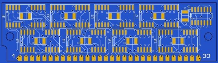

Project spearheaded by @phipli - I just did the Sprint Layout - the following is @phipli 's writeup​

To assemble, you will require -​
  • 4x PCBs.
  • 32x MT4C1004 Memory chips (or equivalent - take care with equivalents).
  • 36x 1210 220nF Capacitors - the height of these is critical. Buy an excess and only use the parts which are 0.6mm or less.
  • 4x 74F32 logic chips.
Assembly is self explanatory, but difficult. The capacitors must be perfectly flat and reflow soldering is recommended for the RAM chips as there is insufficient room to easily get a soldering iron between the two ranks of chips (although it is possible, but you can't see what you're doing at all!).
Files are available on GitHub here: https://github.com/kr239/Macintosh-IIx-RAM-SIMM under a NON-COMMERCIAL LICENSE!
Good luck. Let us know how it goes!​

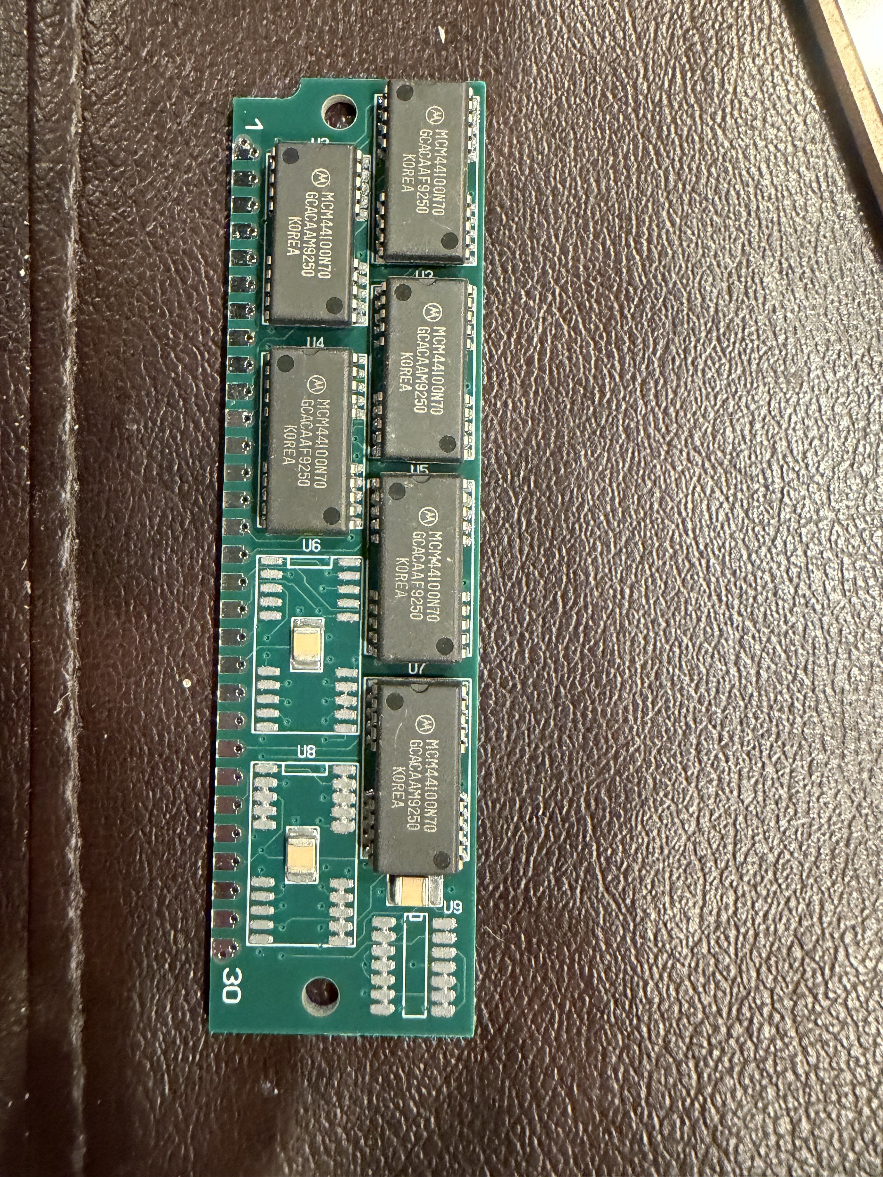

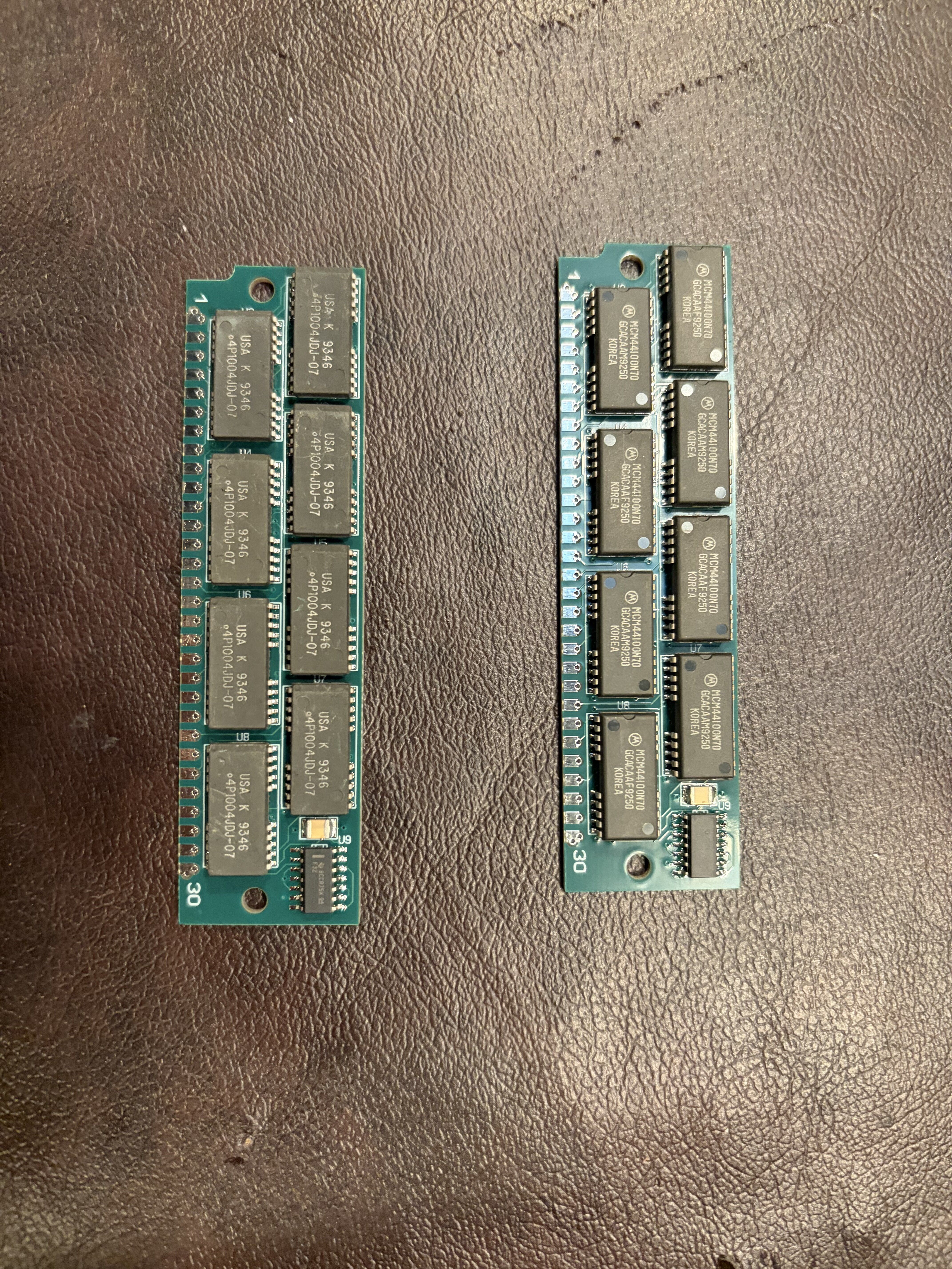

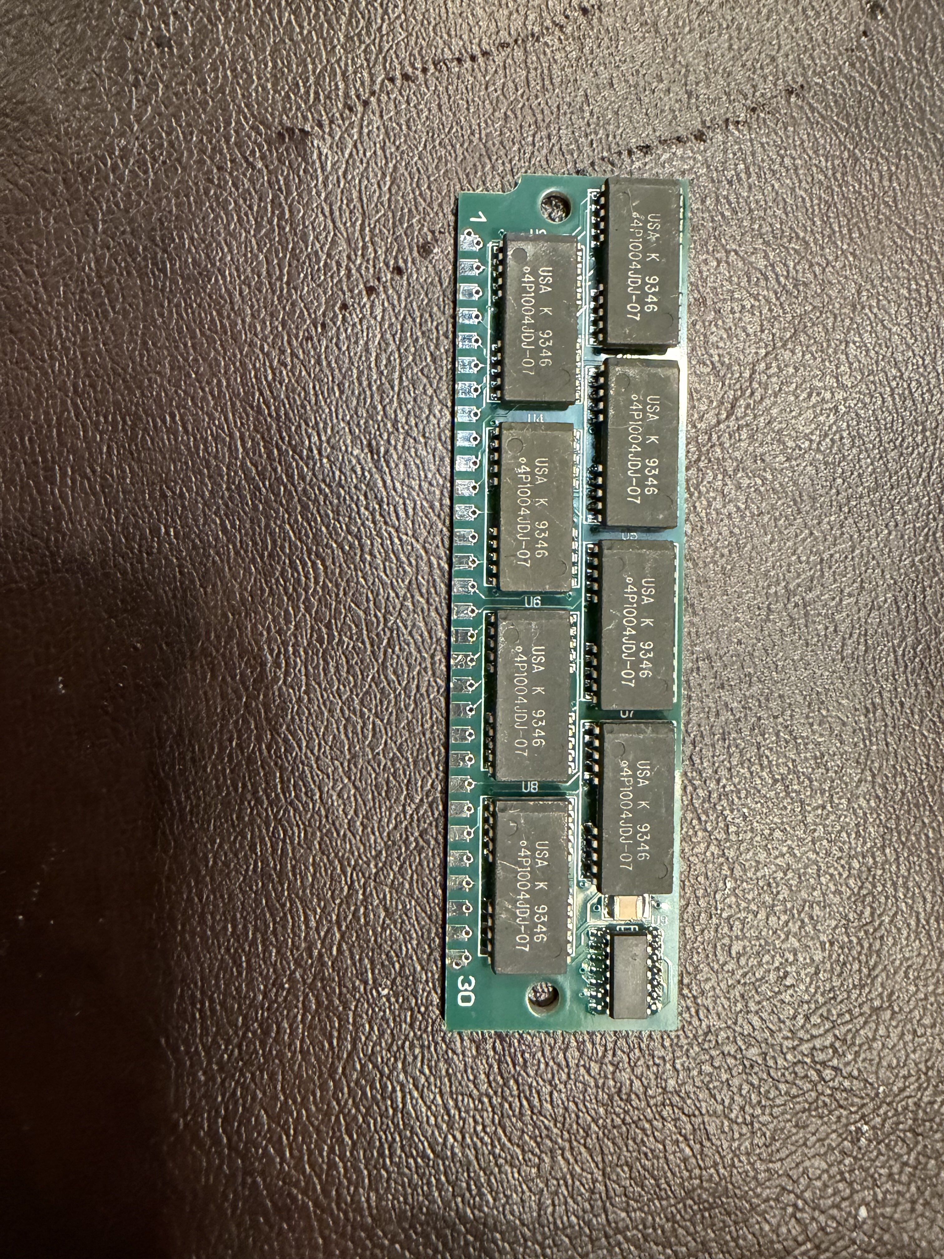

Finally got a chance to put these together. Ordered the PCB’s from JLCPCB.com, with a stencil. Took the chips from some RAM modules using hot air gun (Very easy to do). Built a reflow oven with the Whizoo Contreleo3 (https://whizoo.com/products/controleo3-reflow-oven-controller)- works great BTW!. And went to work! Unfortunately, the PCB’s were too thick for my Macintosh II (1.6mm vs 1.2mm), so I have a new set on order. But the final product looks great!
Anyone ordering PCBs for 30 pin or 72 pin (or 64 pin) SIMMs should remember/be aware, that they need to specify 1.2mm thickness, and actually, the thickness should be 1.27mm. 1.2mm will probably work okay in newer, unworn sockets, but may be too loose.
PCBs these days default to 1.6 mm thickness.
The original specifications for all of these SIMMs is .050 inches, which is 1.27 mm. I know that 4PCB.com (AKA Advanced) can still make 1.27 mm for a price. I don't know about others.
I made a set of these ~1yr ago and they never worked. Thankfully I did select 1.2mm thickness (still had to shim them a little for good contact in the slots). @jdoctinker if you have success with yours please let us know!
