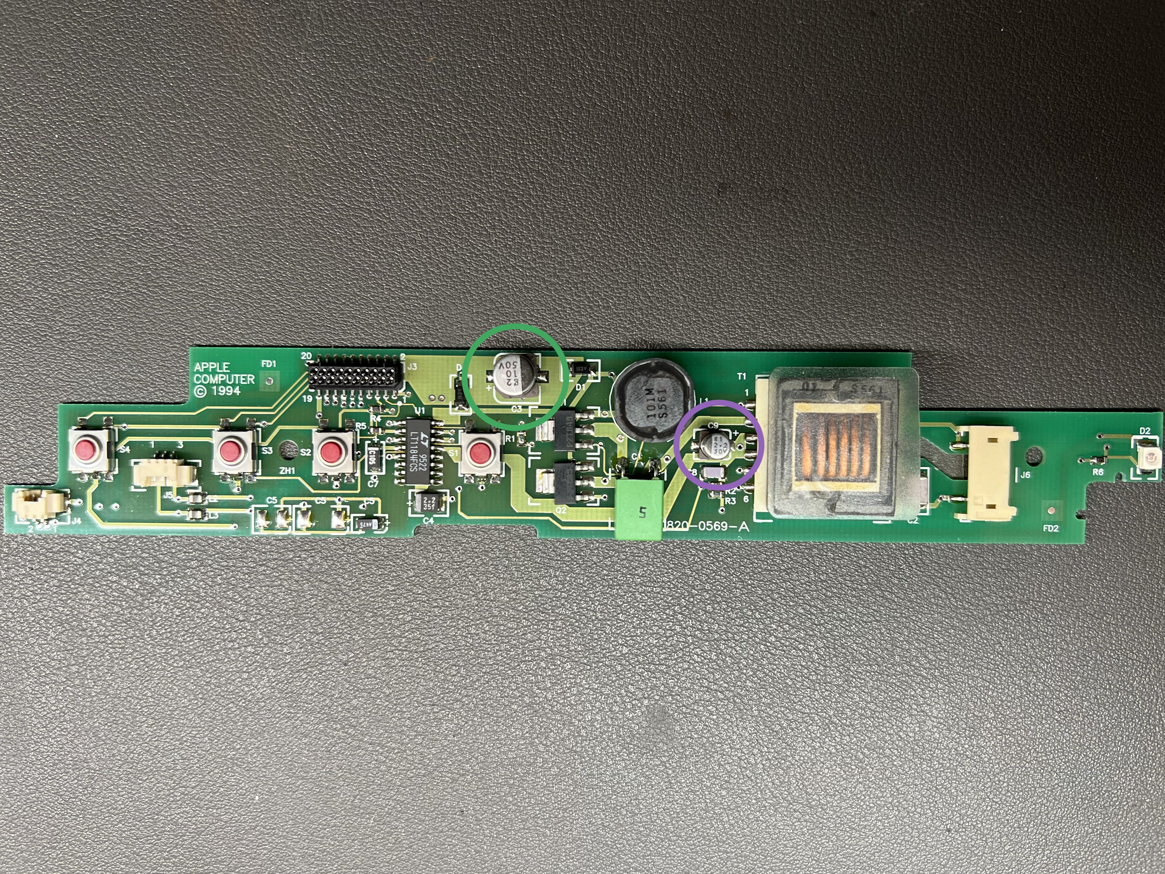

The PowerBook 5300c has three circuit boards with electrolytic capacitors. The locations and specs may vary in other models such as the 5300ce and 5300cs.
Location(s)
Capacitance
Voltage
Pads (edge to edge)
SMD Size Recommendation
Notes
INVERTER BOARD
C3
10uF
50V
9.5mm
C (6mm L) or
D (7.3mm L)
C9
2.2uF
50V
6.5mm
B (3.5mm L)
POWER SUPPLY BOARD
C67
33uF
25V
9.5mm
C (6mm L) or
D (7.3mm L)
11x: C68, C69, C70, C73, C74, C75, C76, C77, C78, C79, C80...
