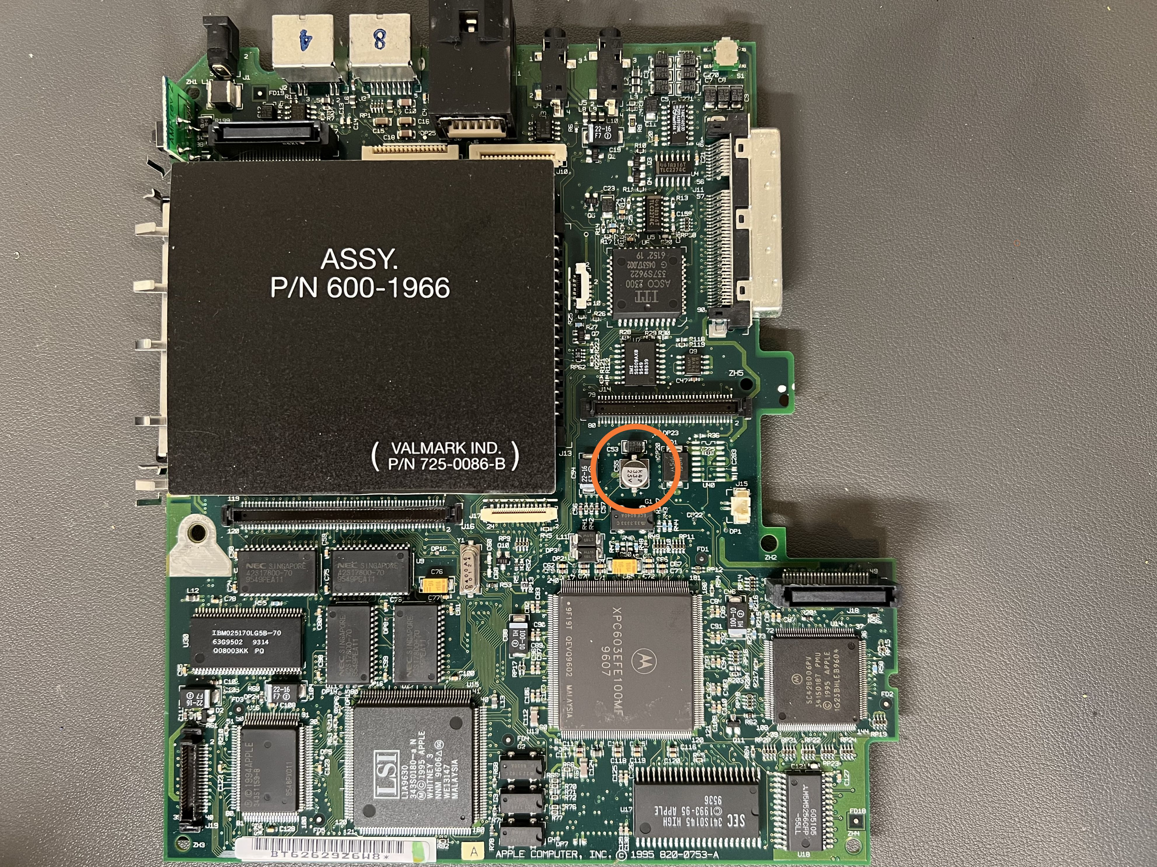

The PowerBook 5300c has three circuit boards with electrolytic capacitors. The locations and specs may vary in other models such as the 5300ce and 5300cs.

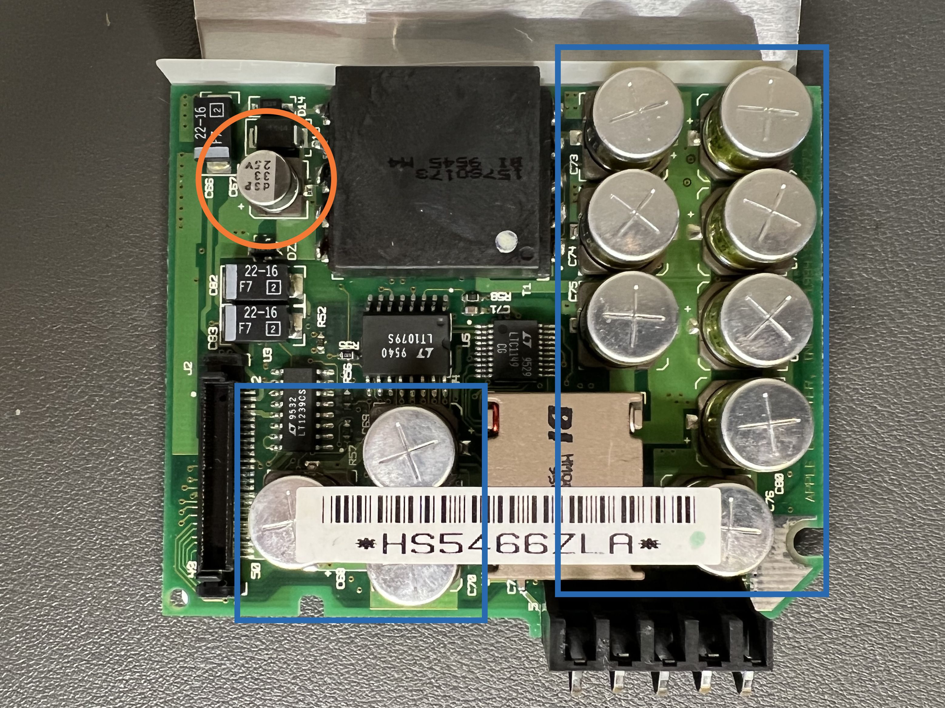

POWER SUPPLY BOARD
C6733uF25V9.5mmC (6mm L) or
D (7.3mm L)
11x: C68, C69, C70, C73, C74, C75, C76, C77, C78, C79, C80100uF35V12.5mm6.6mm X 6.6mm - 10.3mm X 10.3mmTantalum not a typical/affordable replacement option.
MAIN LOGIC BOARD
C5533uF25V9.5mmC (6mm L) or
D (7.3mm L)
