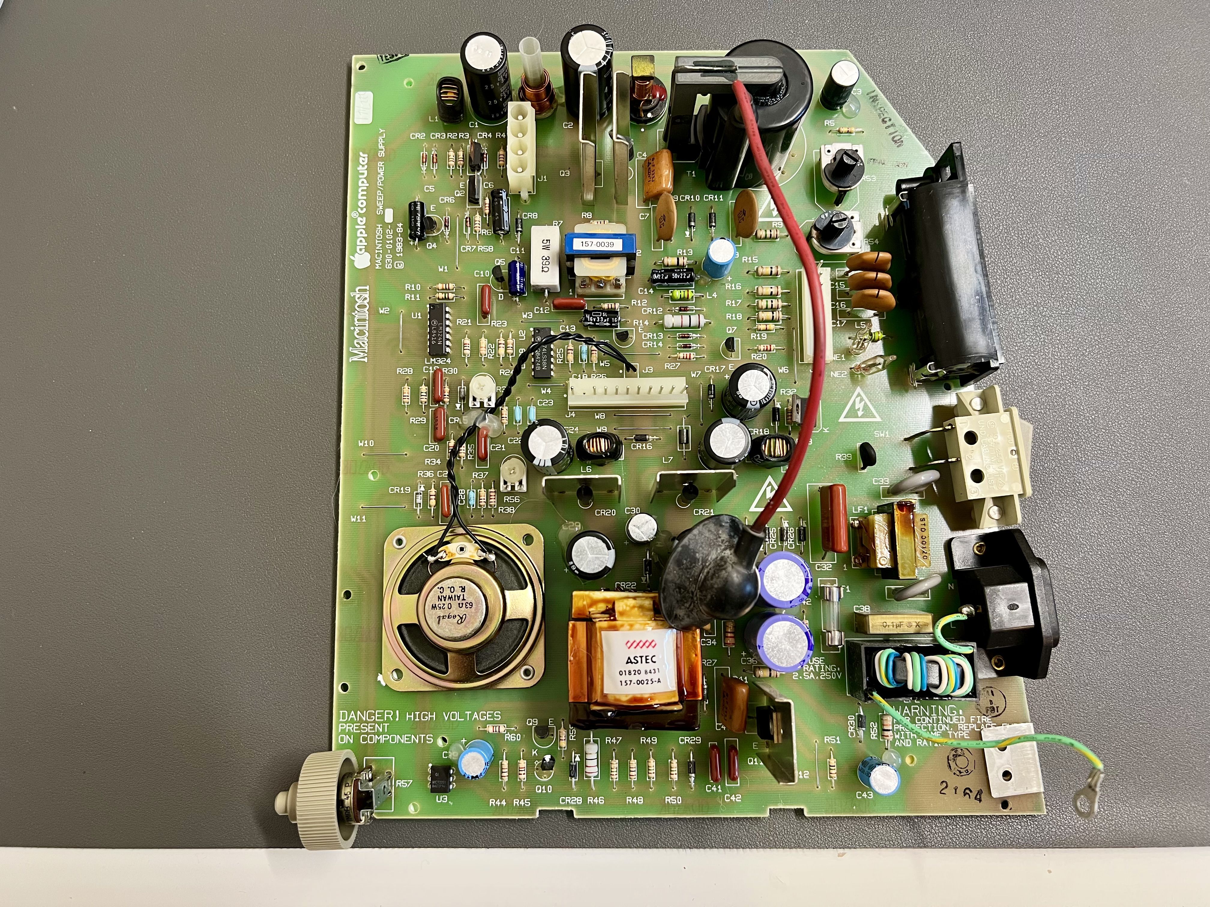

This is a pre-recap photo of the reference board. It is the original board from the system with serial number F4263JNM0001.

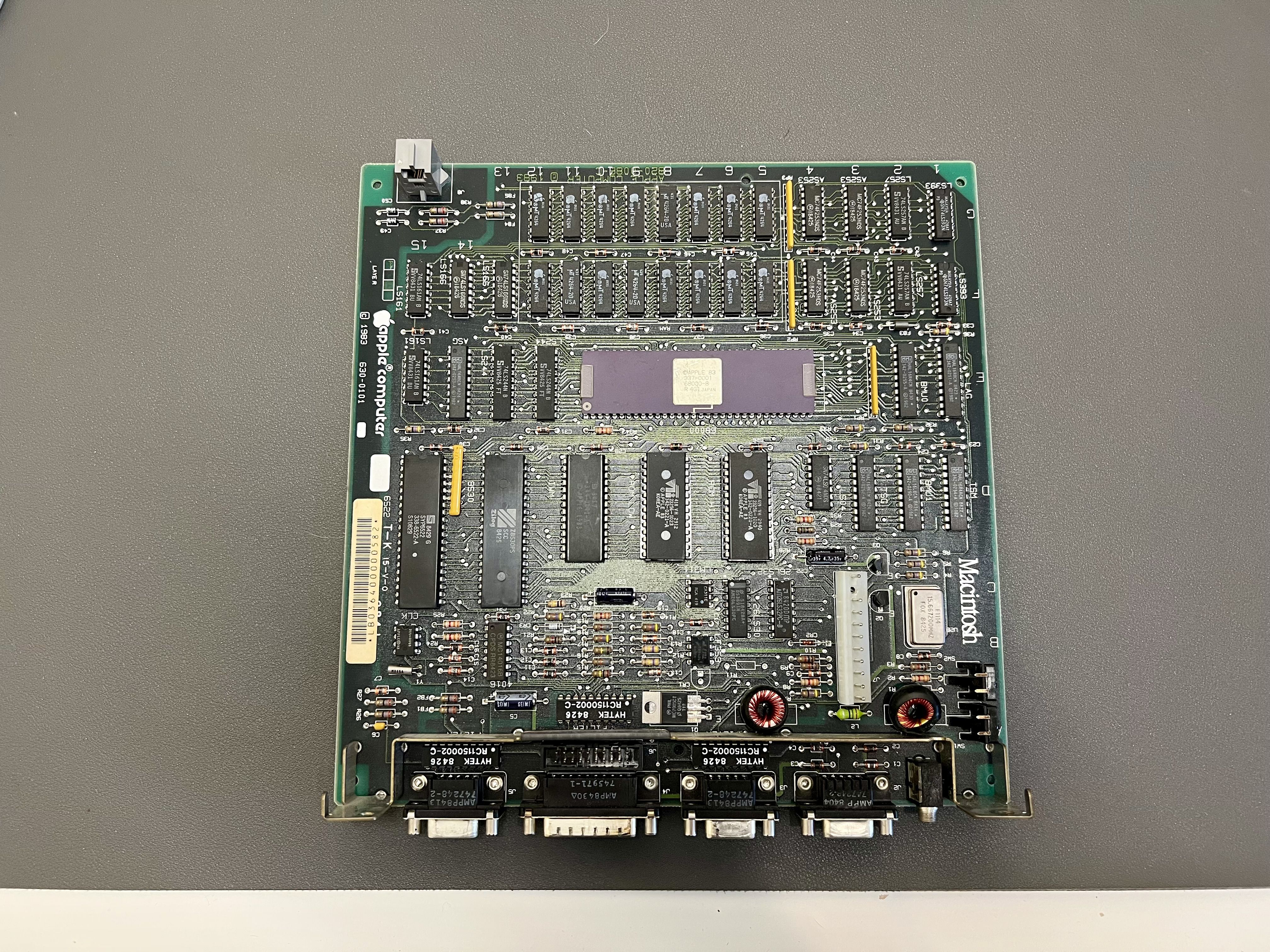

This is a pre-recap photo of the logic board from the same system.
