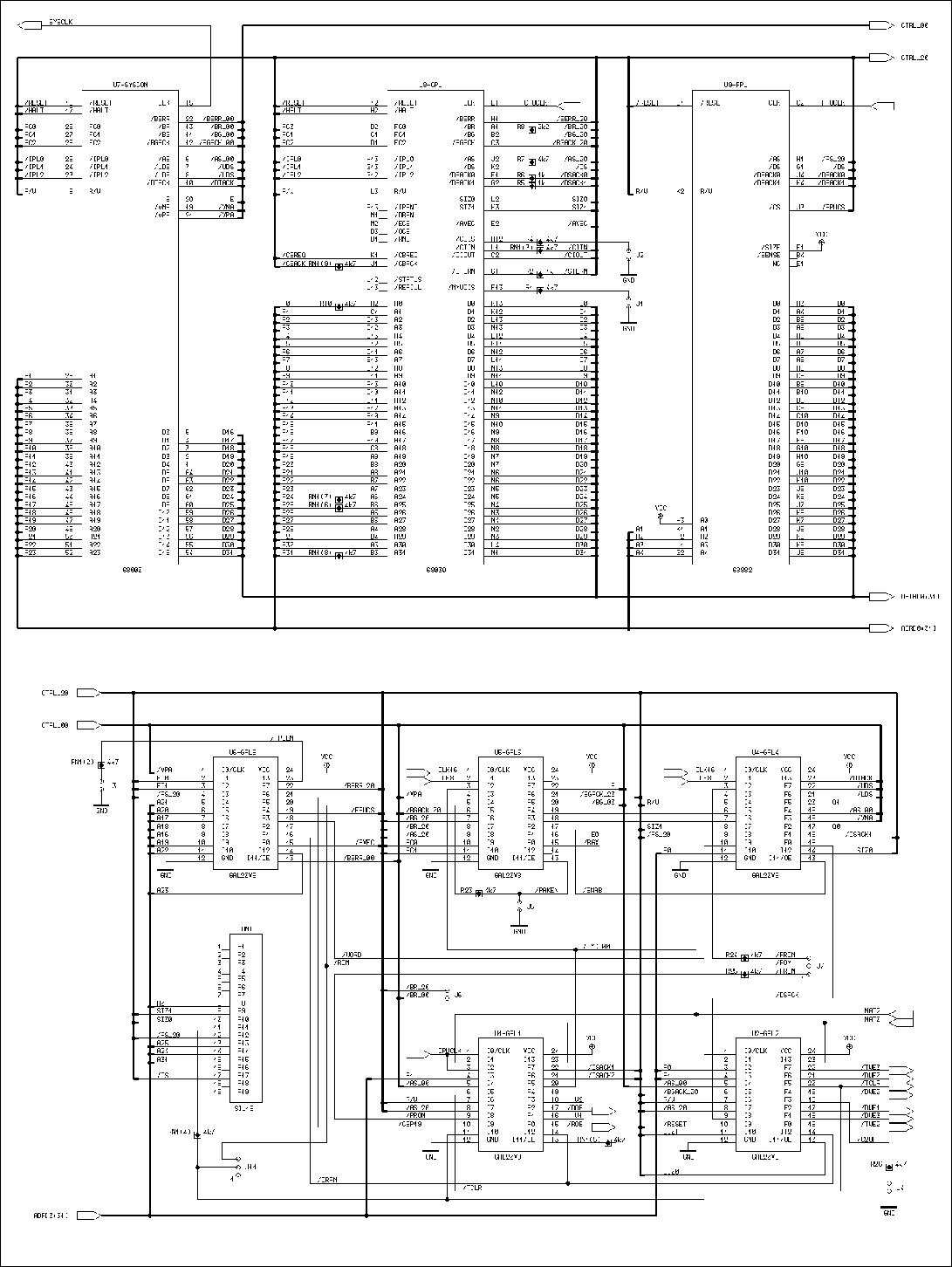

The circuit diagram of the 030 version of the PAK/3 basically covers the 020 as well. Since the /STERM, /CIIN, /CIOUT, /MMUDIS, /CBREQ and /CBACK connections are not available on the 68020, the corresponding lines, including the associated pull-ups and jumpers, are not required in this case. Unfortunately, the pin assignment of both CPUs is significantly different, which is only noticeable in the small print in the circuit diagram, but ultimately led to the two different board versions in the circuit board layout. Except for the GALs, R1, R2 and the CPU, both board versions are equipped exactly the same.
The state machine concept of the PAK/2 has proven itself in practice, so that the core of it could also be retained for the PAK/3. The CPU, FPU and ROMs are largely wired like the predecessor. Synchronous clock generation using a 74F86 as a doubler for the 8 MHz system clock is also identical. The quartz oscillator was also found on the PAK/2, but was only responsible for the FPU there. With the appropriate GAL equipment, the PAK can now also be operated asynchronously to the system clock (tested up to 33 MHz); more about that in the next c't. GALs U4, U5, and U6 have largely retained their function (and names). You will still recognize a few things in the equations for U5, while hardly one stone was left unturned for U4. Completely new are GAL U1, which takes over control of the local bus cycles (i.e. for ROM reads and cache hits) and GAL U2, which coordinates the cache.

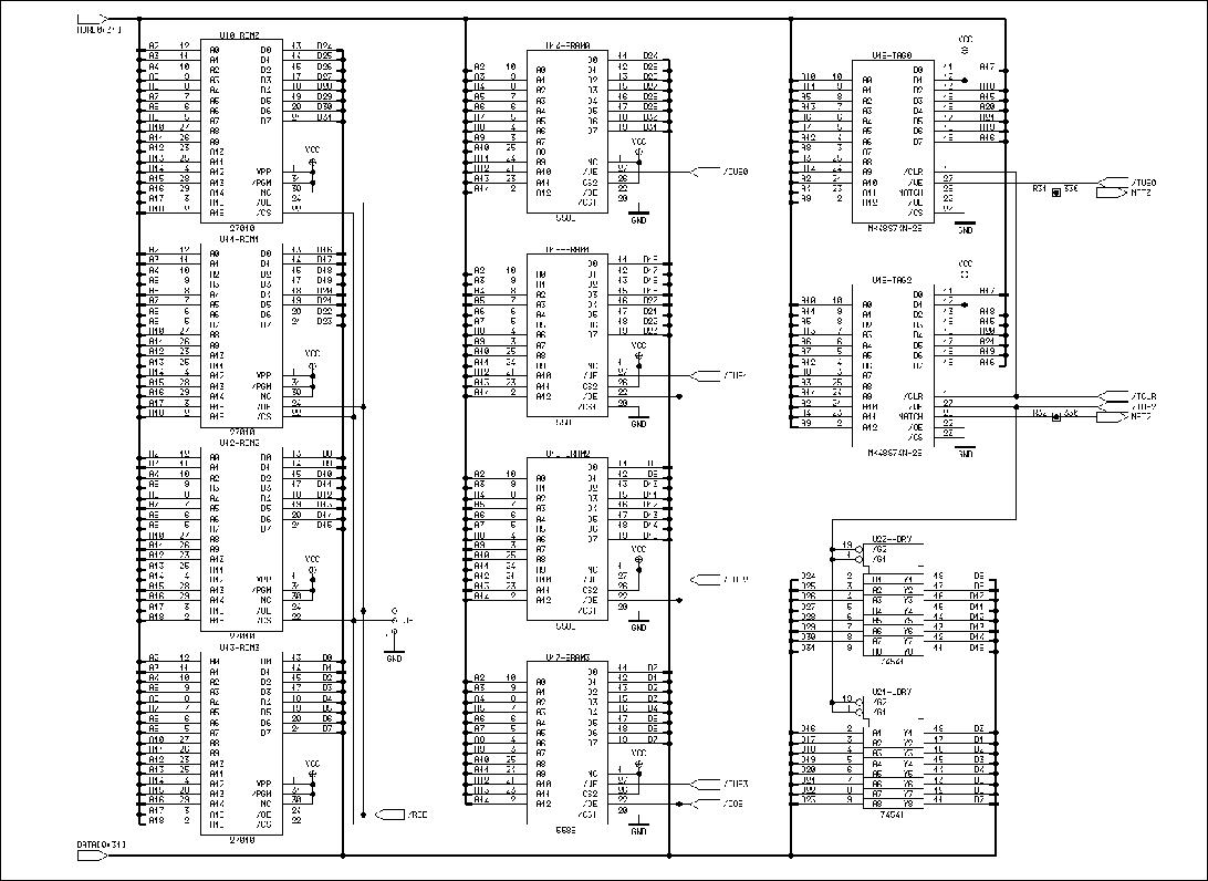

Two tag RAMs, four fast SRAMs and two data bus drivers have been added for the L2 cache. The SRAMs (narrow design, 300 mil) require largely the same signals as the ROMs (width 600 mil), so that a two-storey design was the obvious choice here. This was the only way to keep the dimensions of the PAK/2. We were also able to eliminate a small blemish: the PAK no longer covers the PDS slot in the Mac SE.
The four SRAMs (each 8 KBit × 8, i.e. 8 Kbytes) together form a 32 Kbyte cache memory which the CPU can access very quickly and in full. GAL U2 ensures that the data fetched from main memory is stored in the cache on the side, so to speak. Data from main memory address 1, for example, also ends up in the cache at address 1. However, since the cache only contains 32,768 bytes, data from the main memory address 32,768+1 also ends up in the cache at address 1, with the previous contents of the cache being overwritten, of course. How can this go well?
Tag Storage​
This is where the tag RAMs come into play, which are initially also static RAMs with 8K × 8, but whose data lines are connected to the CPU address lines A15 to A21. Each time data is cached, the associated upper address bits are placed in the tag RAM. For each individual data word in the cache, there is information as to which 32-KB page of the main memory the contents of the cache belong to.
If the CPU initiates a read access, the tag RAM is now not read out but operated in the so-called compare mode, in which it compares the externally applied address bits A15 to A21 with the stored address bits. The comparator required for this is integrated in the tag RAM and reports the result to the outside via the MATCH connection; if there is a match, a high level is obtained here. This is the sign for the CPU and its read logic that the data it is looking for is already in the cache. If the tag RAM does not report a hit (MATCH is low), then the data word in the cache belongs to another page, which means that the CPU now has to look in the main memory. In the hope that the data word that has just been fetched will be needed again in the near future, the control logic then immediately stores it in the cache.
The cache SRAMs are below the EPROM sockets. Before using SRAM sockets, try out whether the 'turrets' fit into your computer. Especially in the compact Mac it is quite tight.
Because of the 16-bit wide system bus, the cache must be managed word by word, so two tag RAMs are required for the 32-bit wide cache of the PAK. The seven address bits that the tag RAM evaluates cover 128 pages, ie the address space from 0 to 4 Mbytes. In the area above $40,000, the second-level cache is ineffective, which does not imply any restrictions on the Macs and Ataris in question; the CPU has direct access to the ROM on the PAK anyway.
The same plan for two versions: Except for the CPU, both new PAKs are identical. The 64-pin socket for connecting to the main board belongs on the solder side in the DIL rows that point to the middle of the board (see also the detailed photo). R1 and R2 are only fitted to the 030 version.
The eighth bit of the tag RAMs forms the valid bit and is therefore at V__CC. In order to declare all data in the cache invalid (e.g. in the case of DMA accesses or a reset), the tag RAMs are cleared via the /TCLR connection and all bits are thus set to low. In this way, the comparator always recognizes a cache miss (no hit) on the next read access and then reloads the cache.

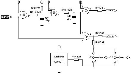

The clock doubler for synchronous 16 MHz operation was carried over from the old PAK.

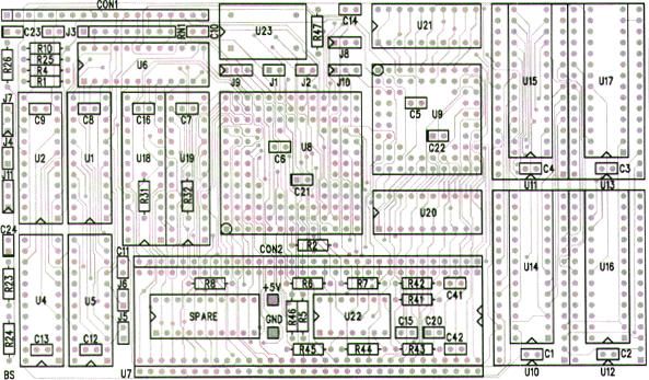

Thanks to multilayer technology, the circuit board almost achieves the packing density of a free beer bar; In order not to exceed the dimensions of the old PAK, the tag RAMs had to be banished under the EPROM sockets, and some support capacitors can only be found on the solder side when using closed PGA sockets for the processors. Incidentally, the CPU and FPU can only be removed from PGA types with cup spring contacts (`precision sockets´), if at all, only with brute force. Normal designs, such as those produced by AMP, are better here. To be on the safe side, you should also donate the Tag-RAMs socket; the bars of the EPROM sockets above must be carefully removed.
As with the old PAK, a 64-pin DIL socket on the solder side with a plugged-in adapter socket or SIL strip that pricks on both sides establishes the connection to the mainboard. For reasons of stability, this time the operative removal of the old 68000 CPU - if not already done - is unavoidable, a 64-pin DIL socket takes its place. In contrast to the PAK-68/2, a GAL set that allows operation with the CPU remaining on the mainboard is not provided. The amputation of all 68000 legs with small side cutters has proven effective. The pins can then be easily pulled out of the circuit board individually. Anyone who tears up during this procedure because of the suffering CPU can later solder a prosthesis in the form of a DIL socket under the legless 68000 and continue to use it for test purposes.

In the 16 MHz operation discussed so far, CLK16 supplies the clock for the CPU and GALs U1, U4 and U5, obtained by clock doubling from the 8 MHz system clock. The CPU runs synchronously to the system clock. The PAK/3 also gets along excellently with a 12 MHz system clock on the Atari mainboard [6], whereby the CPU then, you guessed it, runs at 24 MHz. The only change needed is to the clock doubler circuit. In this case, 470 ohms should be provided for R41 and R43, and 15 pF for C41 and C42 (the capacitors C41 and C42 are mistakenly missing in the parts list; however, they are correctly 'weighted' in the circuit diagram).
If you wanted to operate the CPU in this way with a system clock of 8 MHz and 32 MHz (i.e. with a quadrupled clock), then a more complex clock generation, for example with the help of a PLL, would be necessary. With the PAK-68/3, a different approach is taken in 32 MHz operation: A quartz oscillator supplies the CPU, FPU and GAL U1 with its own 32 MHz, so everything runs asynchronously to the system clock. The GALs U4 and U5, responsible for the interface to the mainboard, continue to run with CLK16 and thus synchronously with the mainboard.

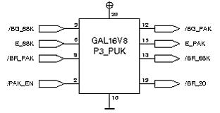

As already mentioned in the first part of the article, the circuit board has an empty socket and a 68000 socket, with which you can easily switch between the two processors (of course not during operation).
Pins 11 (/BG), 13 (/BR) and 20 (E) are not connected to the 64-pin socket U7 on the PAK-68/3. If you want to plug in extensions that require these signals (possibly graphics extensions or emulators in the Atari), you have to submit them later using a wire jumper. If a 68000 is to be used as an emergency drive, these six lines (three each from the PAK and from the 68000) must be routed to a switching GAL (Listing PUK). In addition, /BR_20 (from J6) and /PAK_EN (from J5) are required on the GAL. The jumper J6 is not necessary, the switching between the processors is done with J5.

The GAL P3_PUK is housed in the spare socket of the PAK board with some 'outdoor wiring'.

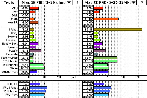

What is important, if you can believe a well-known German politician, is what comes out at the end - see the benchmark table below. On the one hand, it is noticeable that QuickIndex already certified the PAK/2 as having a fairly high computing power. This is due to the short program loops used there, which largely find space in the CPU's internal cache; so the step to the PAK/3 in the various expansion stages no longer seems so big. In the last column it is noticeable that a 24 MHz PAK in a 12 MHz Atari is almost as fast as the 32 MHz version with an 8 MHz bus clock, because data access to the mainboard can only take place at certain times; in between the video controller is on. A faster CPU at 8 MHz thus wastes a good part of the time gained waiting for the next 'access window'. The many write accesses to the screen memory, which do not run via the L2 cache, also have a somewhat slowing effect in the GEM test.
The Dhrystone test and the calculation of the Julia set show a different picture, which also corresponds to the experiences from daily practice, for example with applications like TeX. The bottom line is that the PAK/3 with 32 MHz achieves a factor of 3.5 to 4 compared to a normal ST with 8 MHz and is about twice as fast as conventional 68000 accelerators with 16 MHz.
