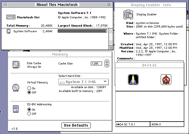

Running System 7.1 on a Macintosh IIci, with 32-bit addressing, correctly named 8*24 GC control panel v7.0.1, and 4 MB of GWorld memory on the card. Crashes with an address error after successfully showing the rocket ship animation at startup. Switching to 24-bit addressing works around the crash, yet sometimes the desktop pattern is drawn on window title drag bars.
Through educated trial and error, I discovered the issue was with lack of compatibility with the Display Enabler extension, v2.2.2. Removing it eliminates the problems. Why do I have this much later extension in my System 7.1 drive? I don't know. Does it happen with other versions of Display Enabler? I haven't tried.
So there you are. The card works fine with System 7.1 and 32-bit addressing. But, later Apple software did not seem to be tested against the GC.

Interesting. Display Enabler adds Display Manager 2.0, which causes the same incompatibilities with older cards that 7.5.2 does (which comes with it in the system). But an 8-24 supports 7.5.2+ as far as I know, so I'm surprised the extension conflicts. Must be something else...
