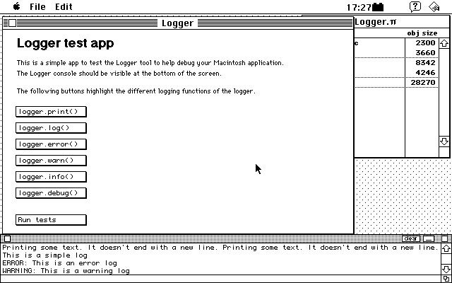

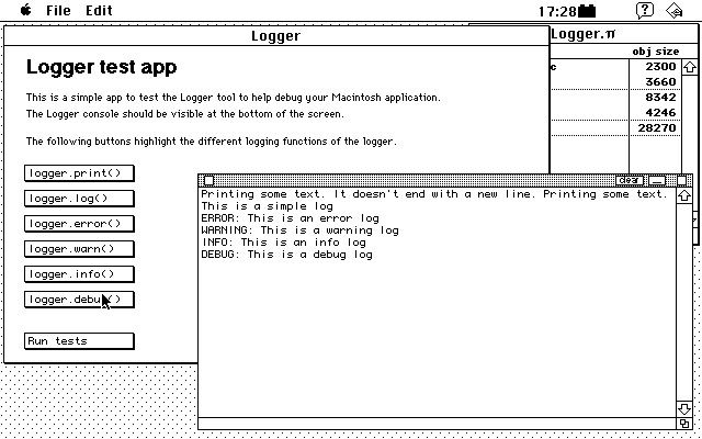

I have updated the logger.c lib, that I made last year, to implement a graphical console that pops up in your C app so that you can quickly log and see any data from your application.
It is fairly lightweight (just a logger.c and logger.h files) that you add to your project. You can get those files from its AmendHub project: https://amendhub.com/ftech/Logger
(You can ignore the `logger-test.c` file from this project as it won't run without its resource file. It is just my test app for making the console as shown in the screenshots.)
