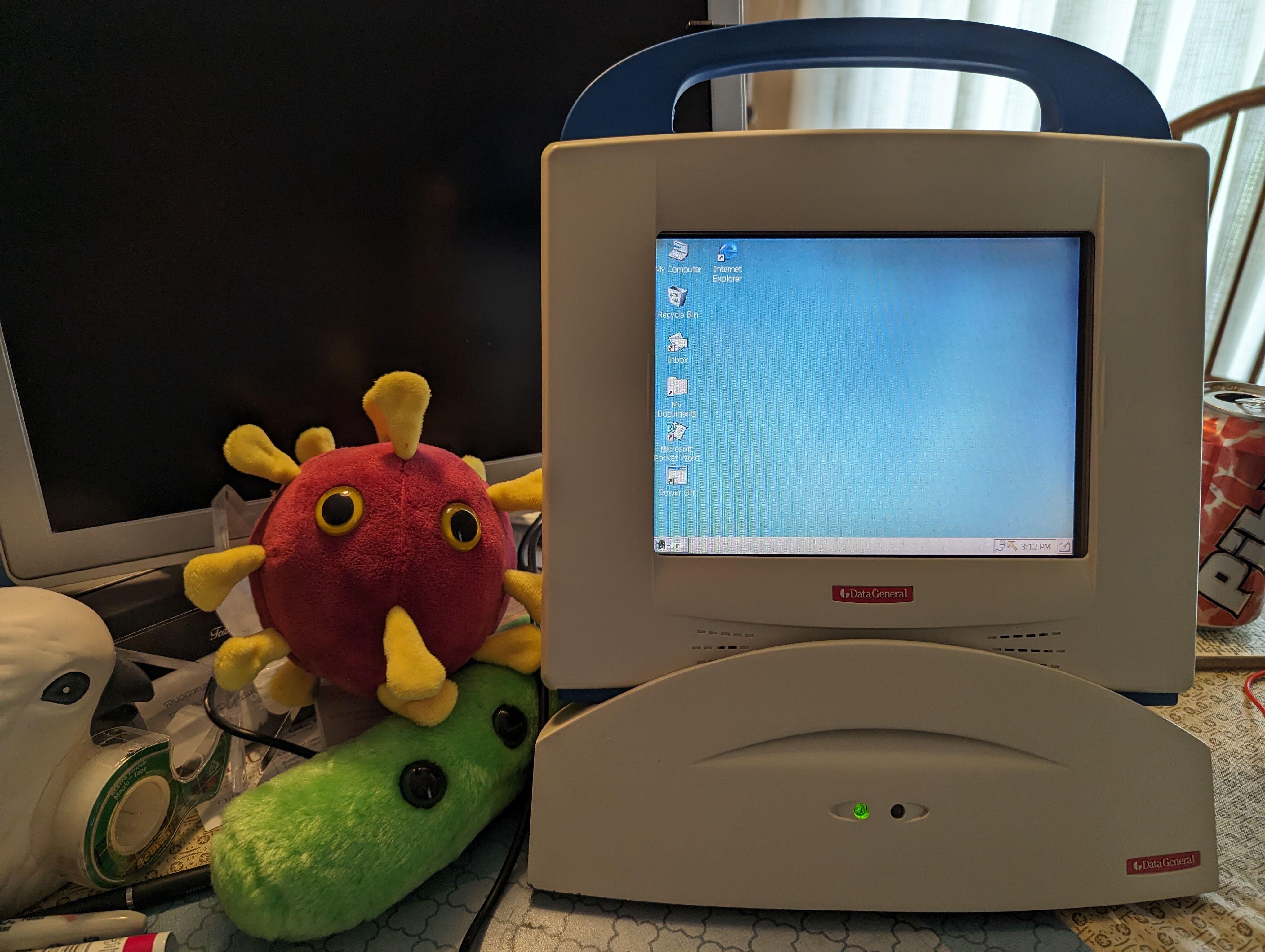

The WiiN-PAD (yes, really, they spell it like that) is the first PowerPC Windows CE system I've ever found. Does anyone know of any others?
This is a little handheld slate intended for medical applications with Windows CE 2.12. It has internal flash and a camera for reading barcodes, and it can be docked to use a PS/2 keyboard. The system runs on a Motorola MPC821, one of their early embedded CPUs, though I suspect it's been downclocked from its rated 50MHz to around 25MHz or so.
There is virtually no software for this thing - no love exists for PPC WinCE. But Platform Builder 2.11 will make compatible binaries and I was able to port a couple things to it. The processor is run using the PowerPC page endianness switch, though it is still internally big endian.
This appears to have been the last computing device Data General developed before the EMC buyout, by the way (circa 1999).
