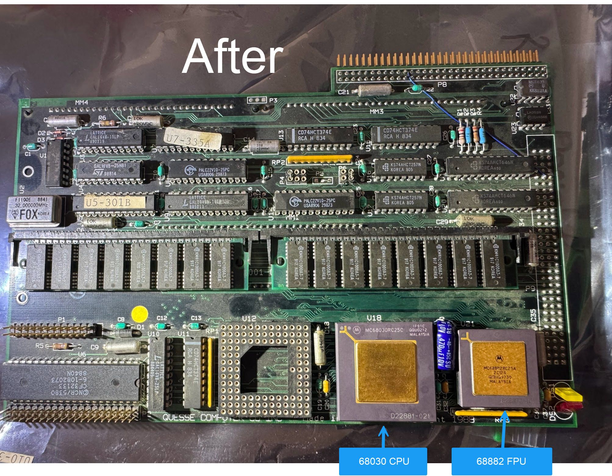

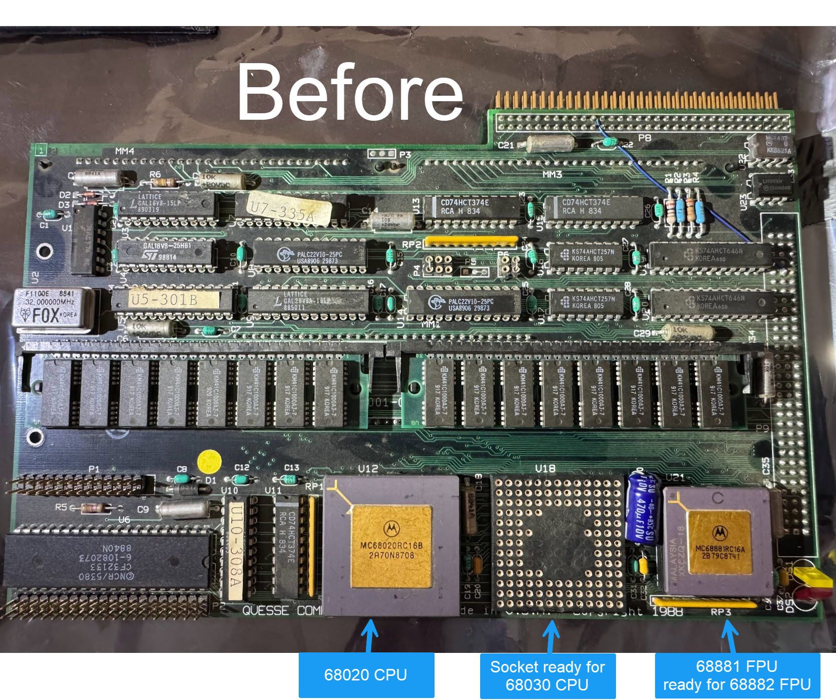

I was blessed to find a Total Systems Gemini 020 for Macintosh SE (Also called the Quesse PDS accelerator for SE). These accelerators, which came out around 1988, were designed to be upgradable to the 030 and had excellent performance, besting the SE/30 and IIx in real world tests. See MacUser August 1990, page 86.
Yesterday I upgraded mine from a 68020 CPU / 68881 FPU to a 68030 CPU / 68882 FPU (25 Mhz parts). I have not yet replaced the 32 Mhz crystal oscillator, so the board is still operating at 16 Mhz. I'll update this when I try to swap in a 50 Mhz crystal oscillator, hopefully allowing the board to run at the full 25 Mhz to meet the CPU and FPU ratings. Total Systems had a 25 Mhz 030 version of the board (as referenced in the MacUser 1990 article).
Unlike many 030 accelerators for the SE, including the nice modern MacEffects Performer, the Gemini 030 at 16 Mhz gives true SE/30 performance due largely to the use of on board 70NS 4MB RAM instead of motherboard RAM.
All of these tests were done with the board installed on a Mac SE FDHD, 4 MB, BlueSCSI V2 running System 6.0.8, Gemstart 2.2 control panel, and Speedometer 3.

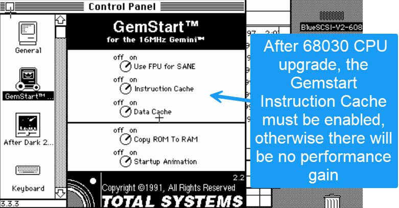

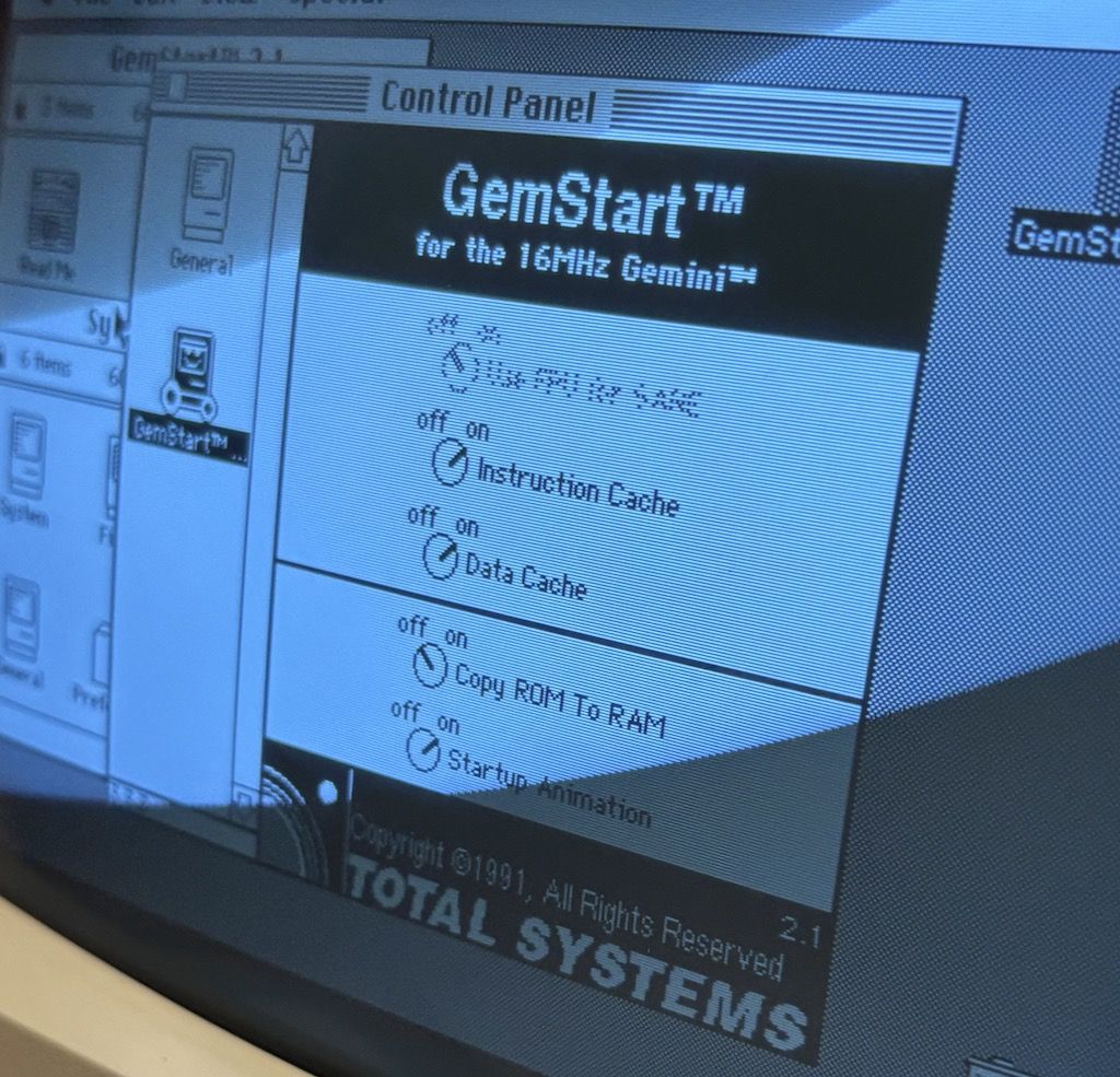

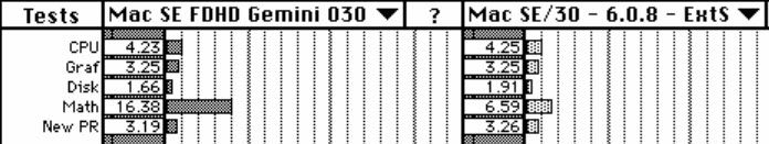

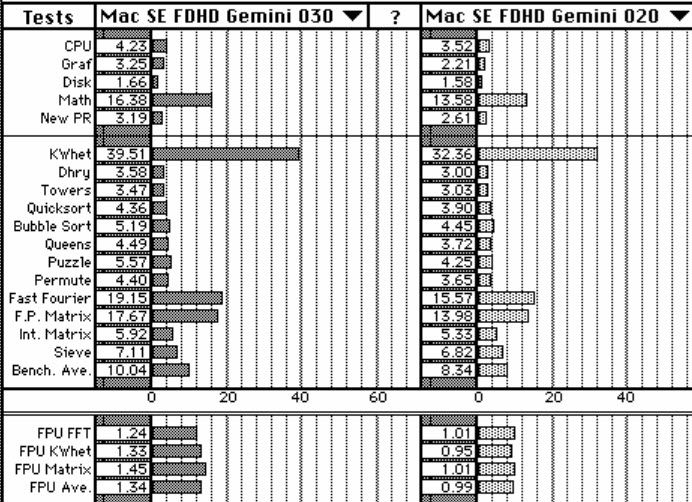

Performance increase after the upgrade (Speedometer 3): (Mac SE is 1.0)​
Total Systems Gemini 030 16Mhz vs. SE/30​

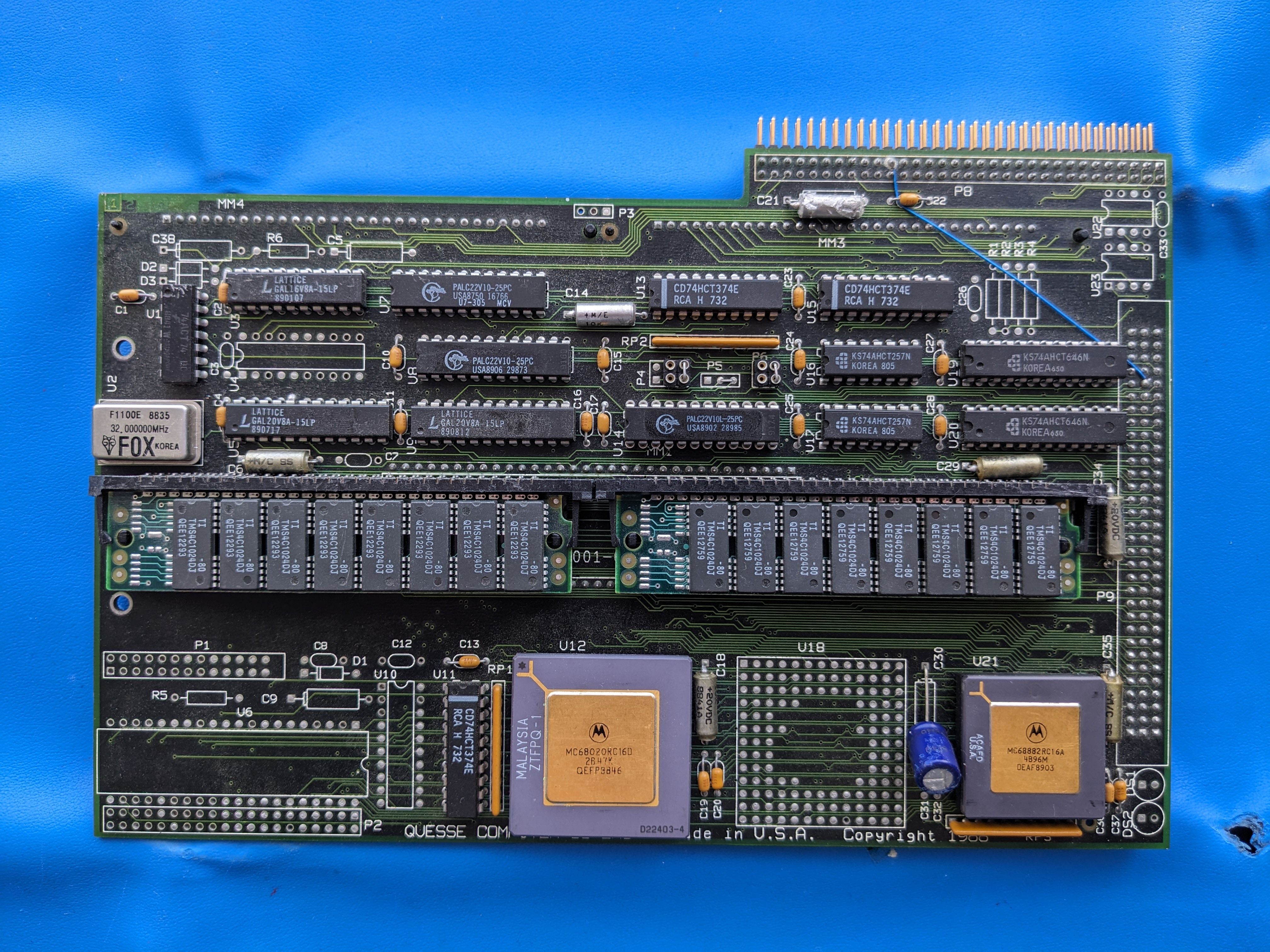

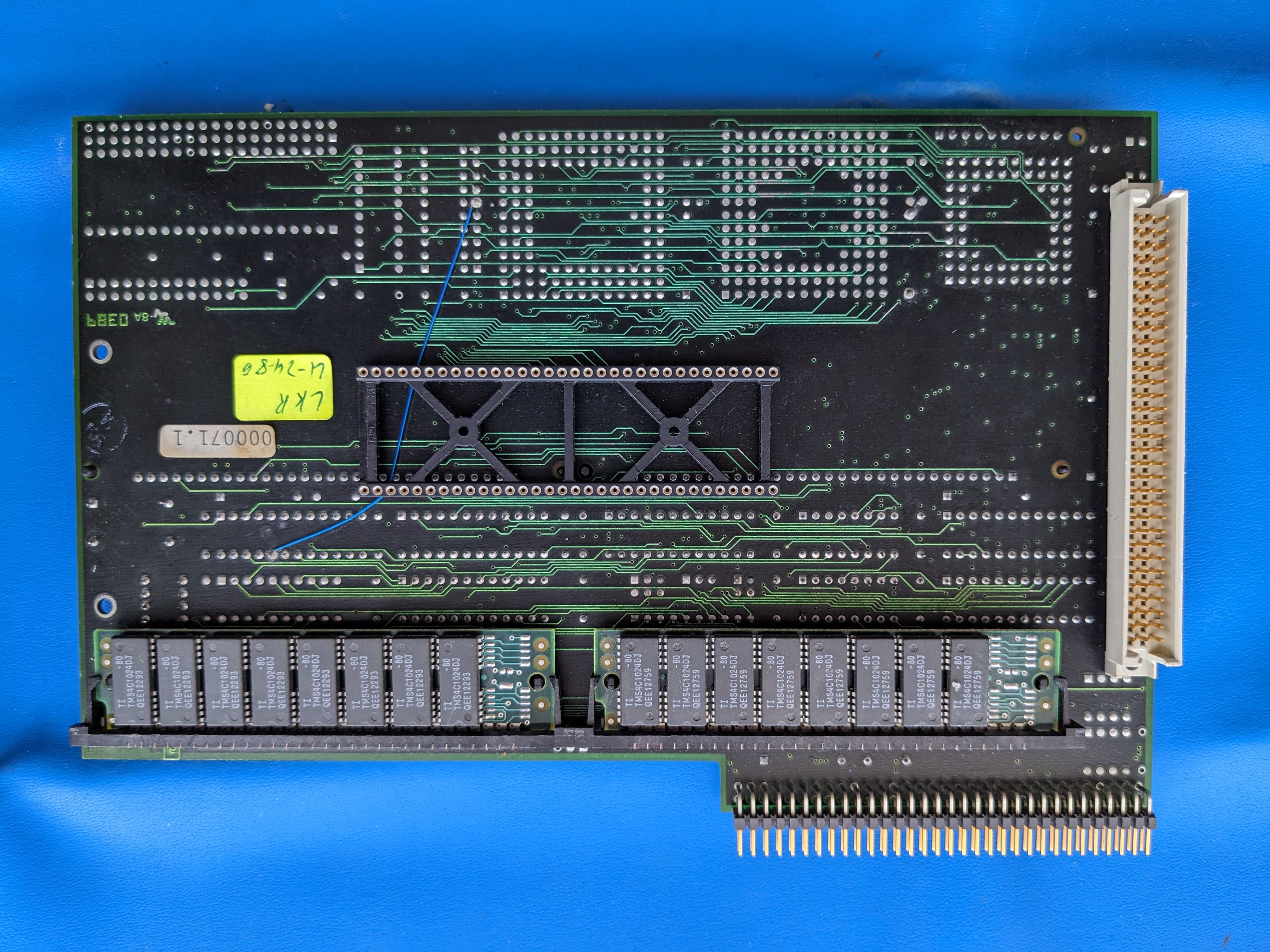

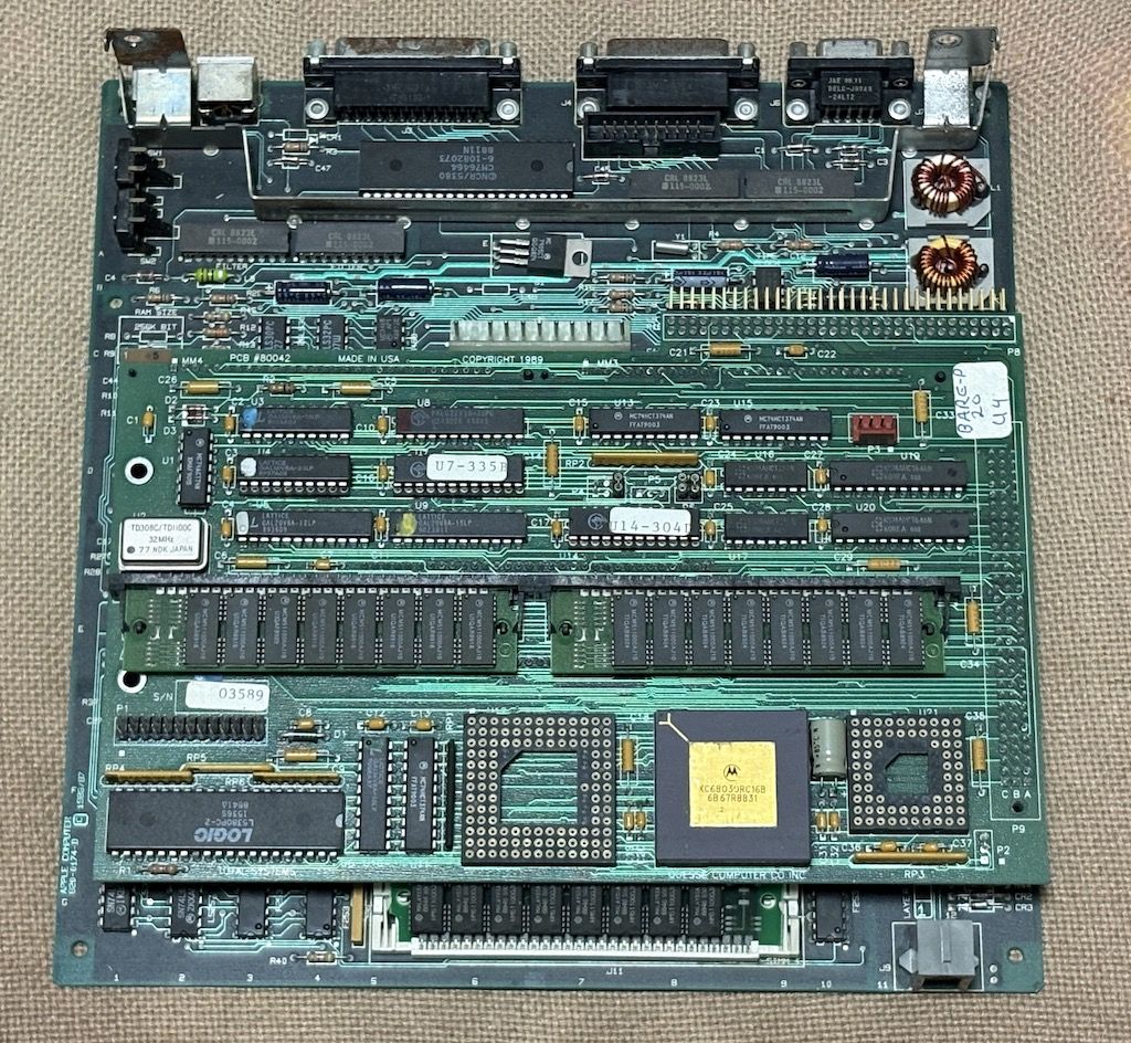

Interesting, I have the same board, but it looks like mine is not set up to run an '030 as-is. It is missing some ICs and the '030 socket compared to yours, though the PCB has provisions for them. Previously I assumed this is because mine is an early board, only having Quesse branding compared to other versions with other vendor branding, and that the other vendors that rebranded these boards sold them with an '030. However I see yours also only has Quesse 1988 branding and does have the necessary parts to ride the '030.
My board is a little quirky. I have tried many different drivers, including GemStart and Extreme Systems. Most times (maybe always, I don't remember for sure) on the first boot the processor is recognized as an '030, after a restart it is properly identfieid as an '020. When I bought the board it did not have an FPU installed. When I tried to boot with the board installed I got some sort of error related to the FPU, this was a couple years ago and I don't remember the exact error. I installed a 68882 I had around and the error went away. The board seems to function fine and be stable after the reboot so the CPU is properly identified.
My board has a couple bodges, I assume they are original, leading me to believe mine may be a very early version before all the bugs were worked out.

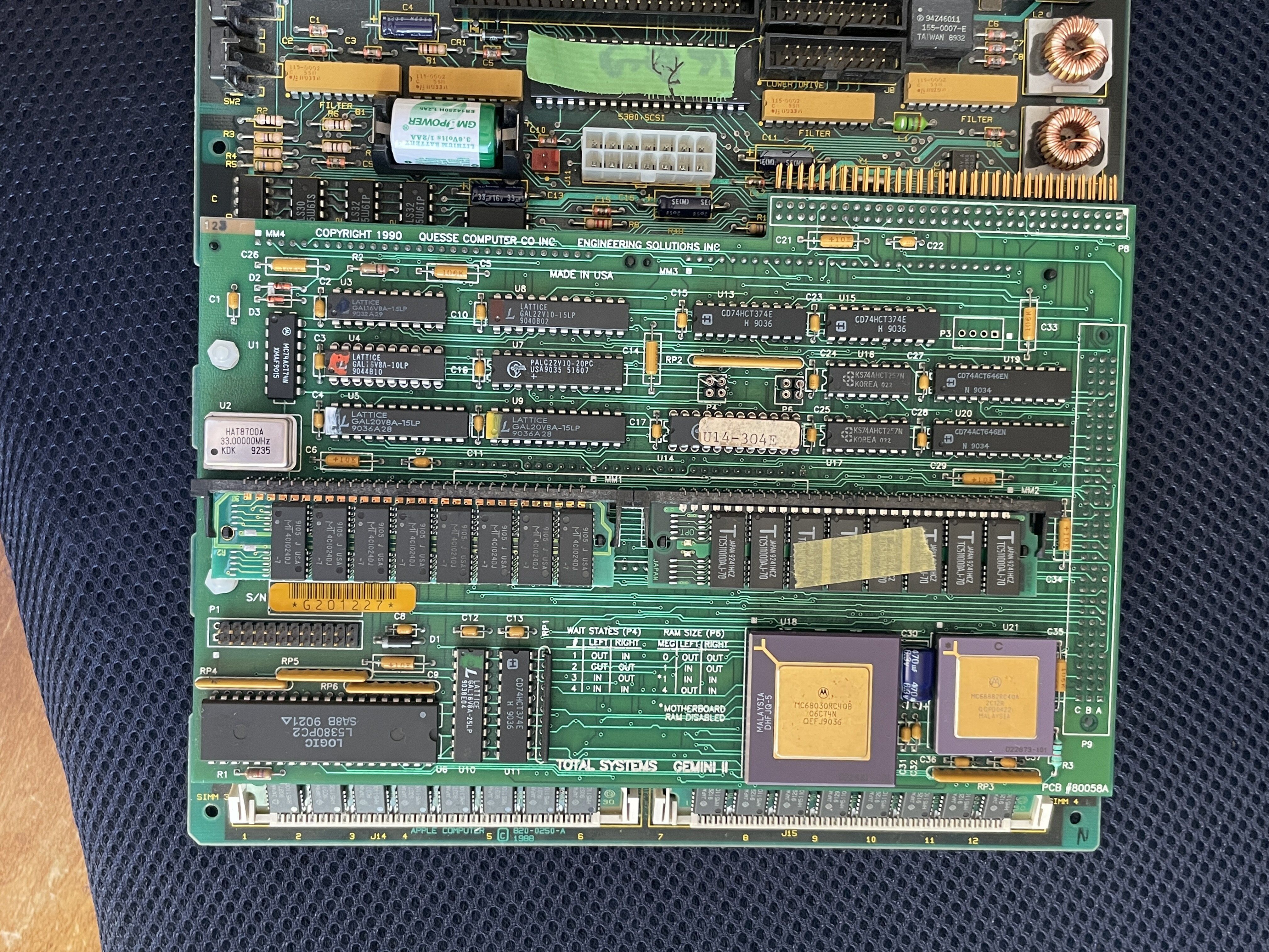

I also have a Gemini II installed in my Mac Plus or SE. I replaced the 20 MHz crystal oscillator with a 33 MHz one as is and swapped the RAM for 70ns modules. I haven't touched the memory wait settings on the board, leaving them as configured by the previous owner. It's said that 4MB SIMMs can be used, but when I tried swapping to 4MB SIMMs, they weren't recognized. I think the SE is more stable, so I'm aiming for 50 MHz, but while it boots, it isn't stable.

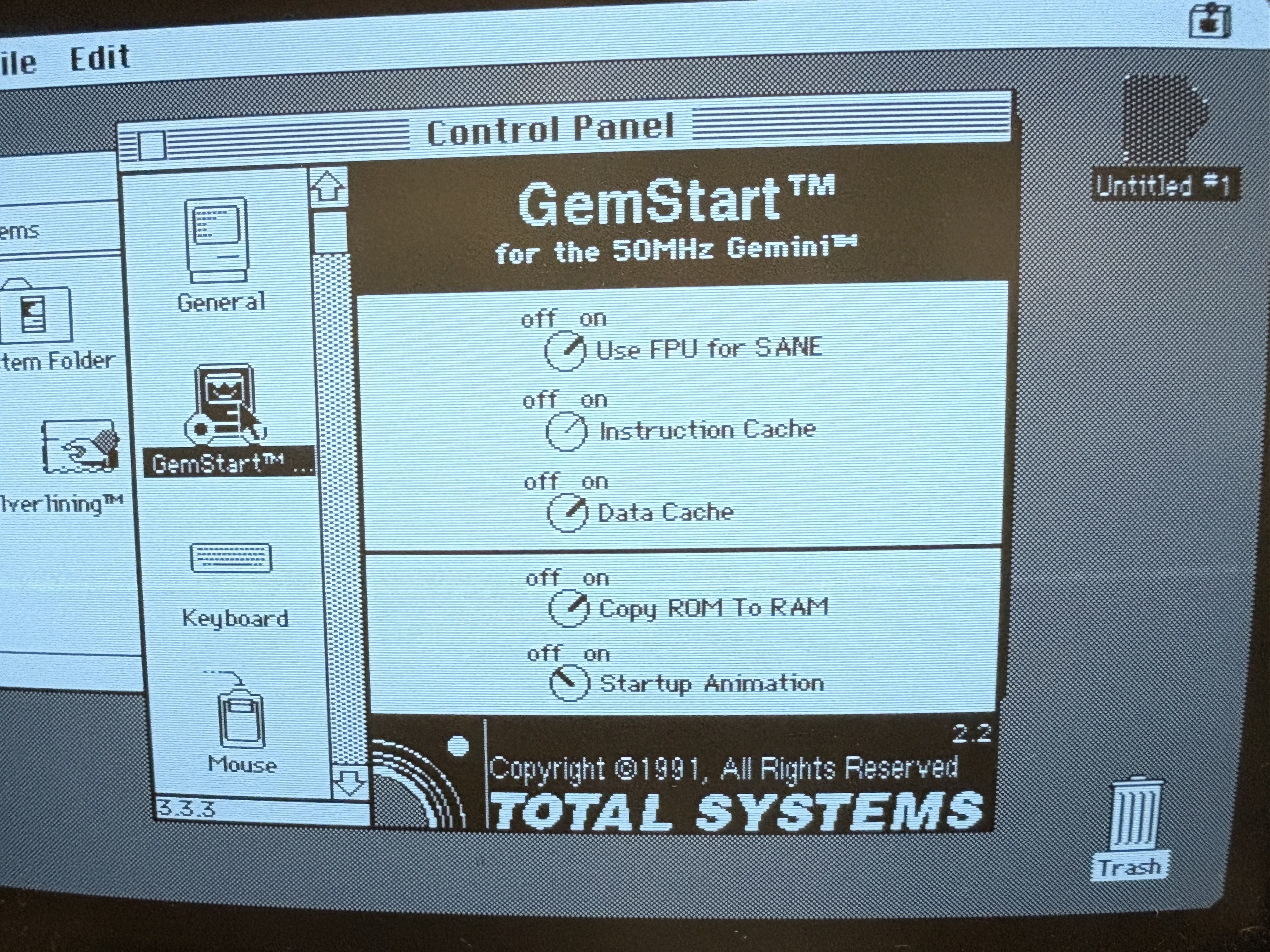

It may work at 50Mhz if you use the settings.

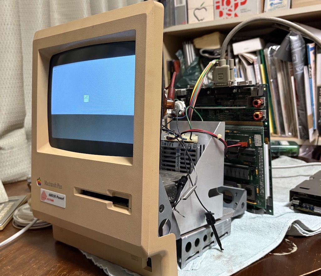

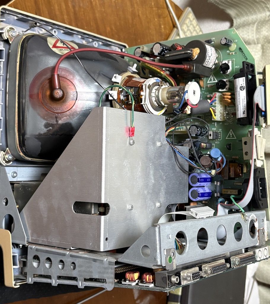

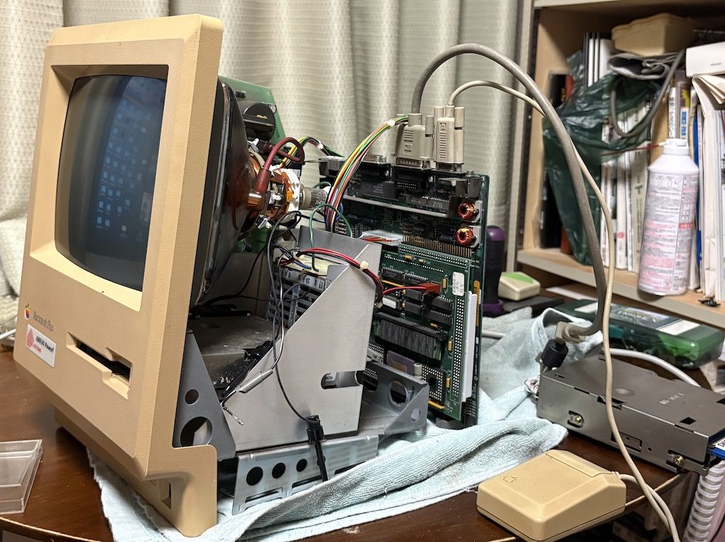

A few days ago, a Mac Plus with a Gemini sticker popped up in Japan, so after a fierce bidding war, I finally snagged it. Since it was a late-production Mac Plus, I was betting that the Gemini board inside would be the later high-speed drive version—but unfortunately, it turned out to be the Gemini I, which can also mount a 68020. Just now, I took it apart to check for safety and fired it up. After leaving it powered on for a bit, the power supply turned out to be degraded, and a capacitor exploded... but anyway, just wanted to report it here too.
