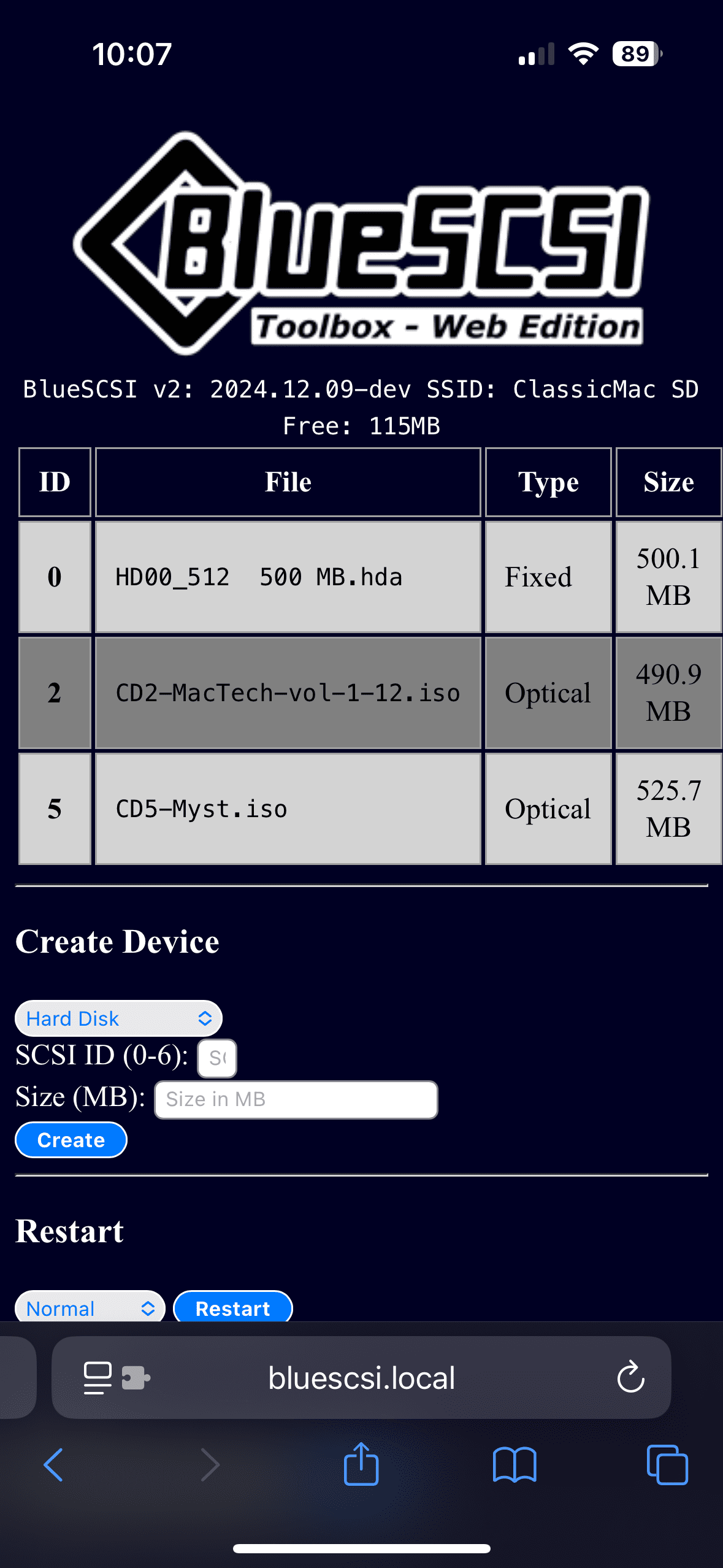

I saw that the capability of using a web-ui to alter ISO mounts, etc but then i found out that it required a separate Pico with qwiic connectivity to make it work. Meanwhile, i saw comments that an extra Pico was not required (?). What is actually needed in order to connect to a device and then swap the images?

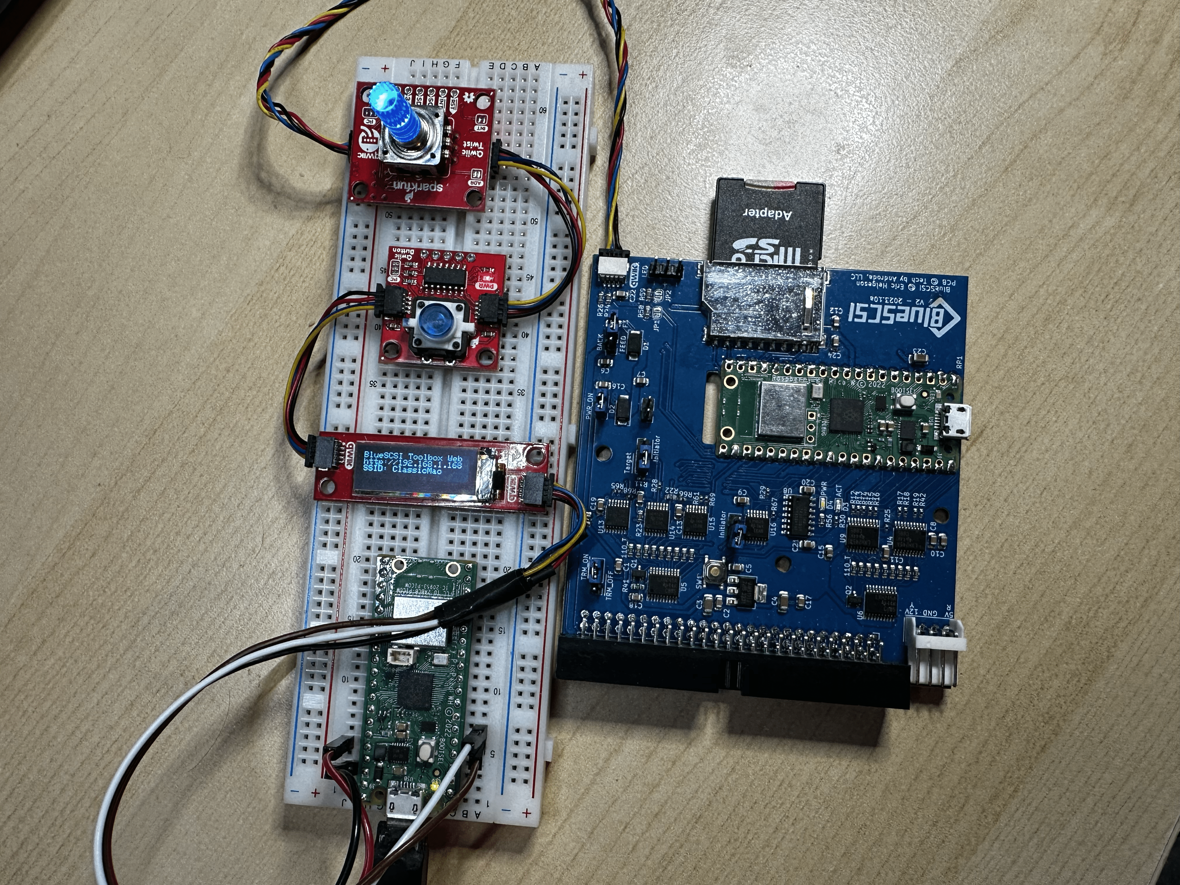

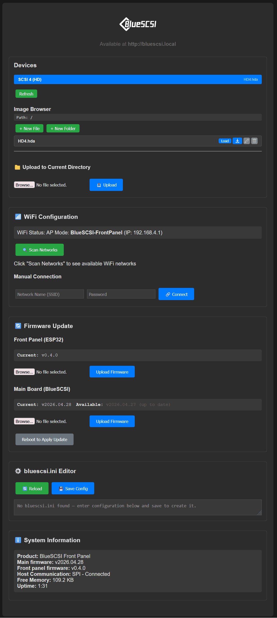

I initially started working on a quiic connected pico but that was scraped as noted earlier in this thread to sync up with PicoIDE's front panel - which connects via quiic(i2c) for v2 and SPI for Ultra.
Hope that helps. it's been an evolving story but now we're here and have something pretty great.
Edit; i've updated the main post to avoid confusion, you can still see the original edit/pictures for history.
