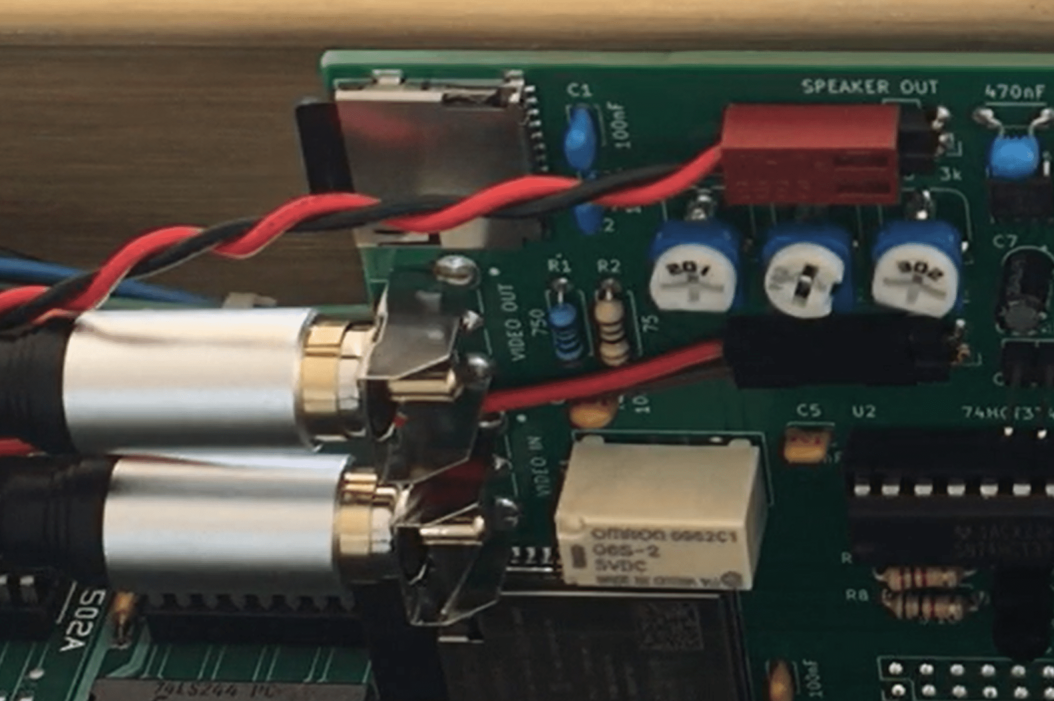

1. The audio pass-through jumper wires that came with the kit had jumpers with holes that were too big for the IIe speaker posts. Luckily, I had a bunch of debug jumper wires with jumpers that were the correct size. If you get this card, you may want to make sure you have some standard jumper wires or communicate with the seller before shipping.
2. The audio pass-through set up could have been more clear. The instructions just say to use "trial and error" until sound works and there is no IIe diagram to show the motherboard connector polarity, and I didn't notice any polarity markings on the in/out board connectors on the ESP32 SoftCard, but I might have missed them. And, both of the original audio wires in my IIe are black - ah yes, the black wire is on that pin! After 2 failed jumper permutations, I went to YouTube and found CVT's beep video that also happens to clearly show the jumper polarity orientation for the card. It was exactly what I needed in combination with visualizing how the original dual jumper connected to the board -- worked first time after that. (n.b. + upper pin, - lower pin) Anyway, it would have been easy to label the board and also provide an image of the motherboard audio header orientation in the PDF manual.
3. One of my IIe slots was a little dusty and the card didn't initially show up on the bus, even though it was powered. However, it did work when I moved it to a different slot. I probably need to disassemble the IIe, give it an ultrasonic clean and/or deoxit everything. It is probably at least 30 years overdue for a deep clean. :D
4. The RCA jacks don't fit through the rear slots of the IIe, but it's easy to unscrew the outer cover on the connector, at which points it fits through the slot opening.
