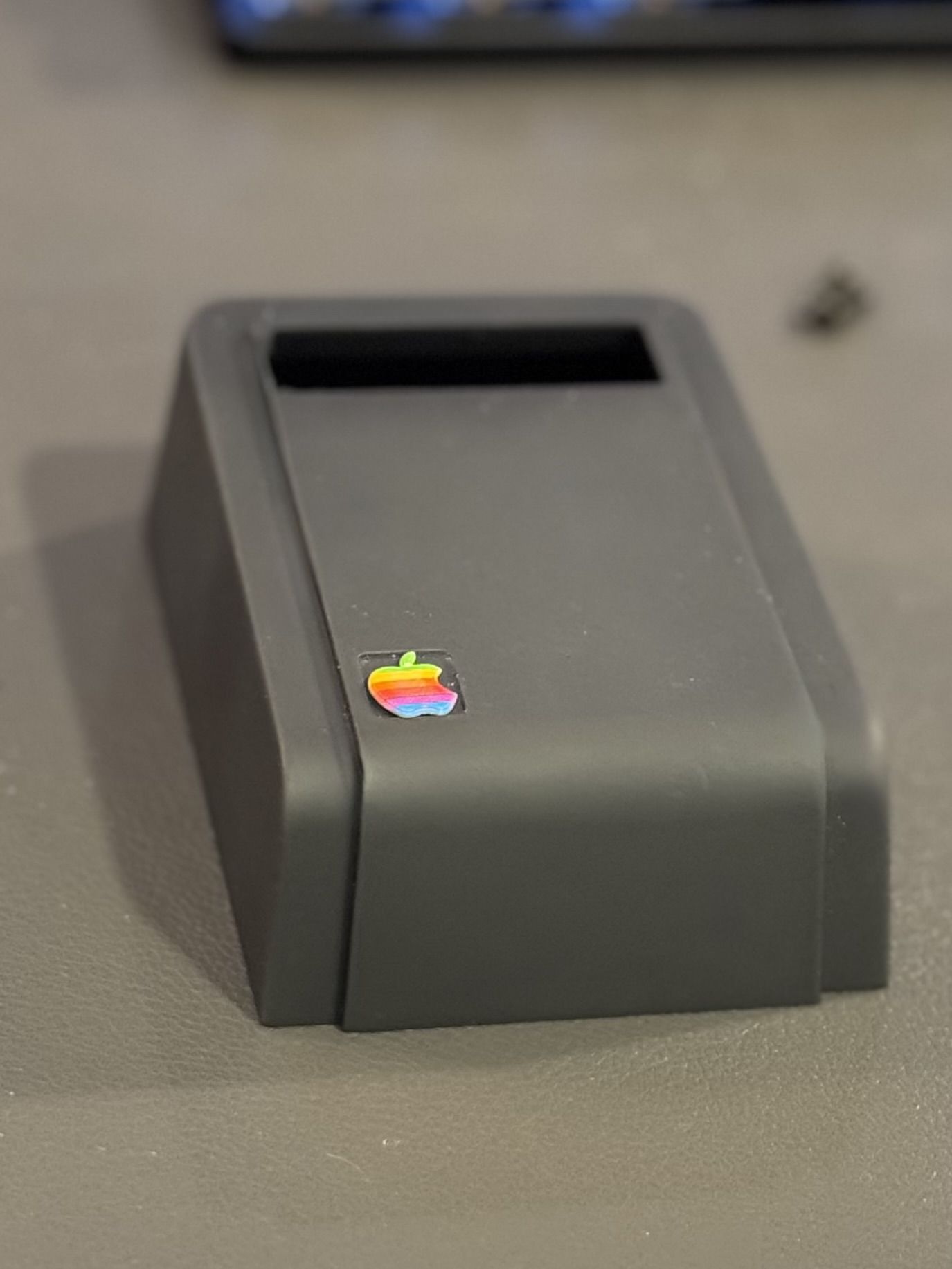

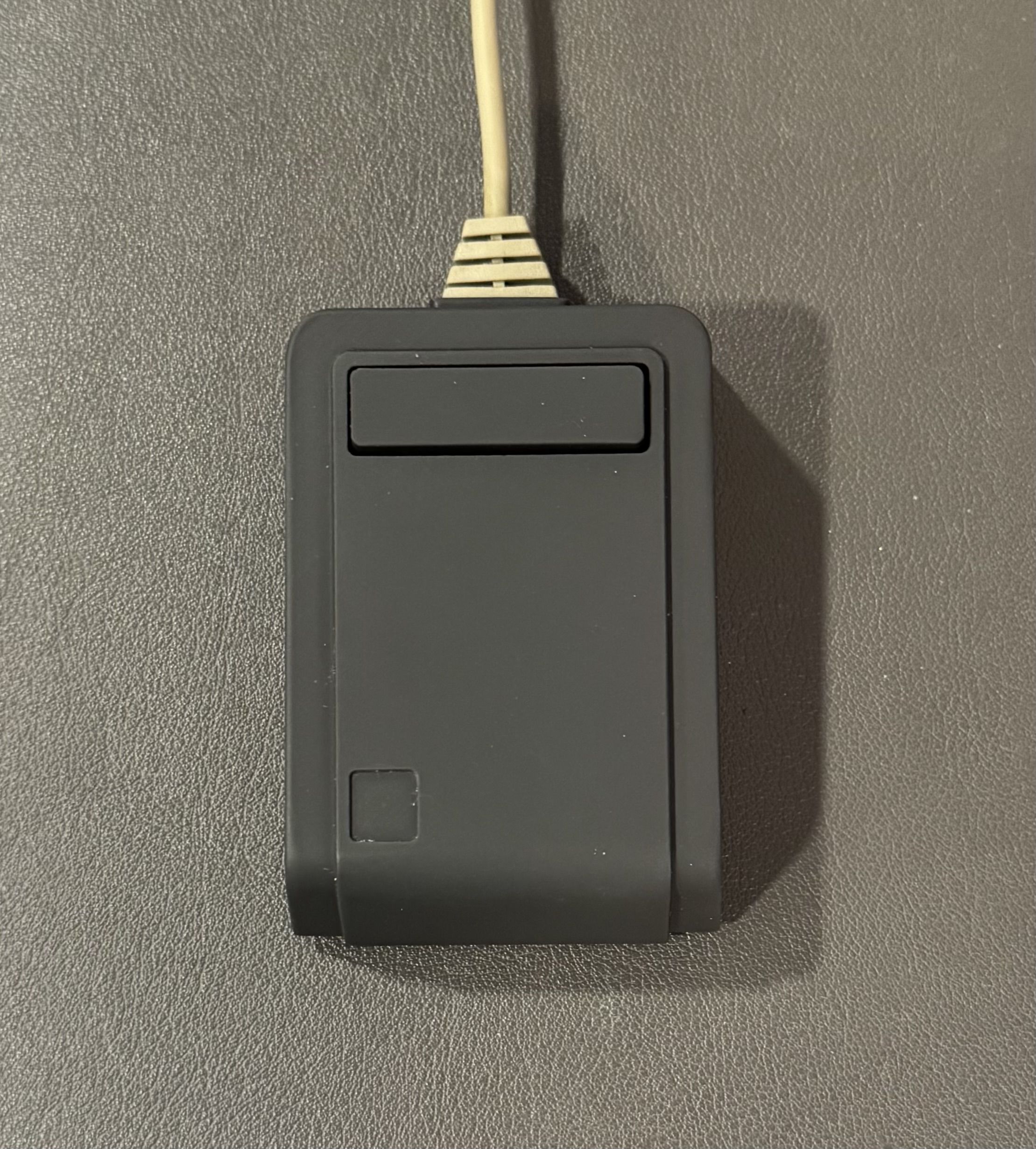

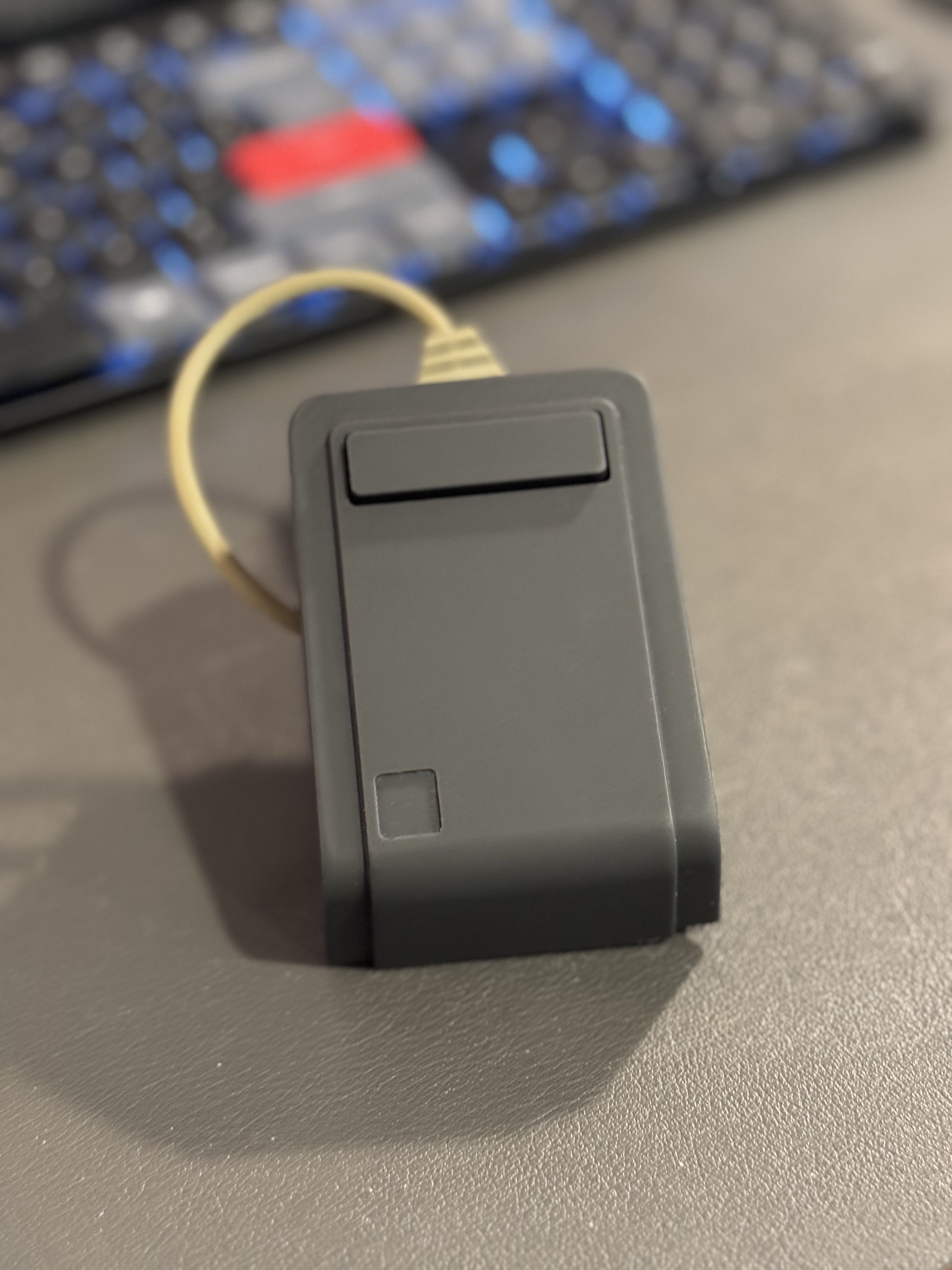

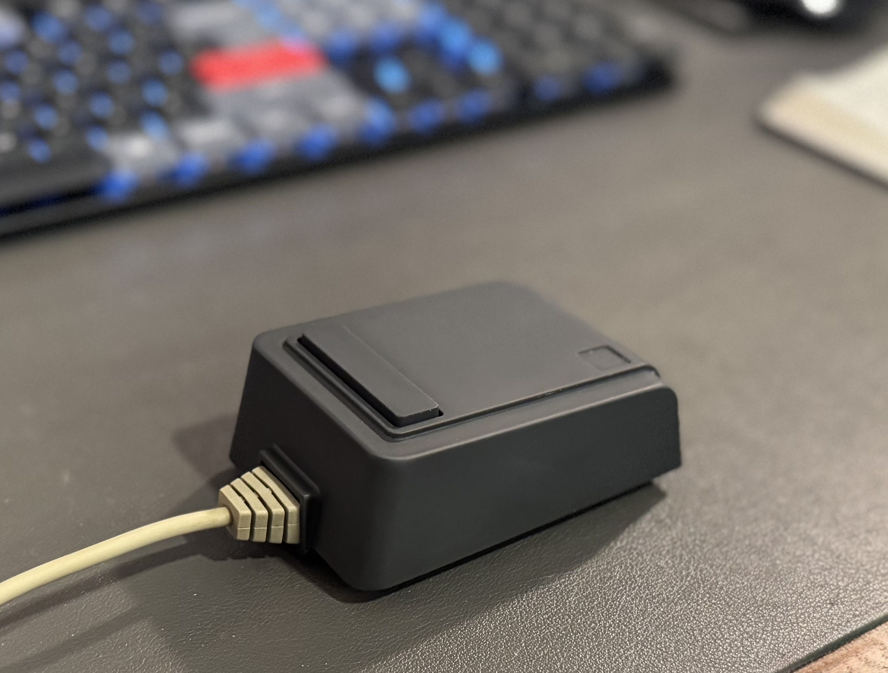

So, the new top case came in. I ordered it in the JLC Black Resin this time, which they claim is a darker black and I wanted to see if it would be a closer match to the Macintosh TV black color. And I'd say it is a very close match. I may see if I can 3d print a new mouse case for it, replacing my painted version. However, the finish on it seems to be not as consistent. Almost like there are sanding lines in one direction. It's only noticeable when the light reflects off the surface, but the standard black resin, while more of a dark gray, had a near perfectly consistent finish. Anyway, here are some photos of the top cases, including the one with the Lisa logo embossed in it.

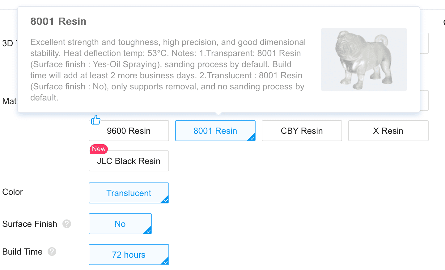

FYI, looks like transparent is unavailable again until early March (https://jlc3dp.com/blog/temporary-suspension-of-oil-spraying-and-spray-painting-services).
Was trying to get an order in for a transparent mouse to go with my upcoming transparent SE/30 case and transparent option is unavailable again. I did place an order for the Lisa Logo mouse in the regular black resin, as I like the look and feel of it better, despite it being a bit lighter than the Macintosh black plastic.

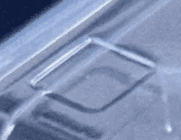

Also, I mentioned earlier that there are a few different revisions of internals for the Apple M0100 mouse, and only one of mine is the right one for this replacement shell. I decided to take a look at one of the other mice I have that is similar (larger board without cutout at the top for the supports, and a bump out in the top right of the PCB) and see how close it is to fitting. The lack of cutout means that the supports for the mouse button interfere with the board laying flat. Also, the bump out in the upper right also hits the plastic towers for holding the mouse button. However, the PCB bump out in the upper right, where the plastic hits, doesn't have any traces. So I carefully removed a segment of that bump out with a Dremel tool.
The lack of cutout was going to need a different fix, since the area where the cutout is on the correct board do contain traces. I considered cutting the board out and running bodge wires, but I decided a safer approach would be to see if I could remove the two support legs that help hold that tower that the back side of the button switch sits in. Worst case, it looses strength and the button will slip down too far. Given the lower case piece is a ~$2 3d printed part, I could always just order another if I need to, but it's cheaper than buying M0100 mice on eBay hoping to get one that will work. So I clipped off the plastic support legs that were in the way. With those two adjustments, my board now fits!
I'll try to open up the mouse and show the modifications. but it got me thinking that maybe I could adjust the lower case to handle the board without having to cut part out of it, while also trying to preserve some of the support for that tower that holds the button. So I modified the original design in TinkerCad. I removed what I hope is enough space from the right side, angling the cutout to allow the board to slide in if necessary. I also removed the two support legs in the middle that interfered with the second board. To help support that piece, I added supports in the middle, under where the button will rest.
It won't match the original, but it gives a part that I believe will work for either board revision. It still won't work for the one that is all one board with the button soldered on, but I may look to make a revision of this bottom case that could handle that as well. @Stephen, any objections to me posting this as a remix if it works when the printed part comes in?

EDIT: unfortunately, it looks like the standard black resin that I was using and preferred may no longer be available. I tried to pay for one of my orders today and received this message:
So I followed up with JL3DP support and it sounds like the oil spray finish needed for transparent prints is on hold until after the Chinese New Year. So they should be back soon.

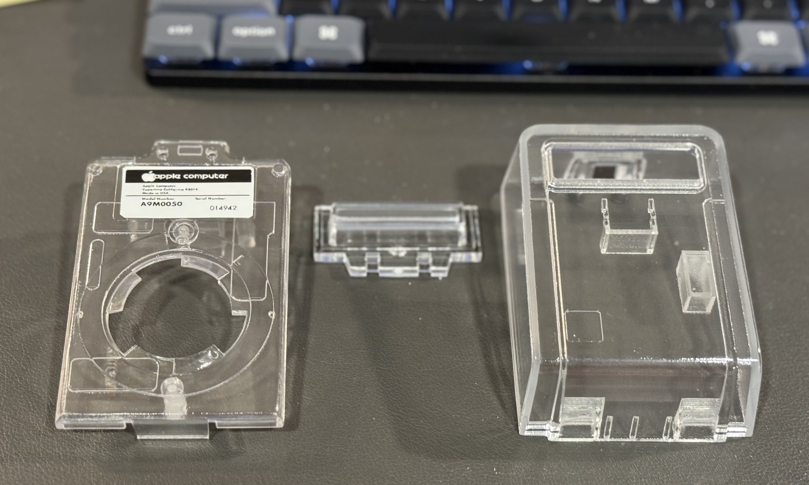

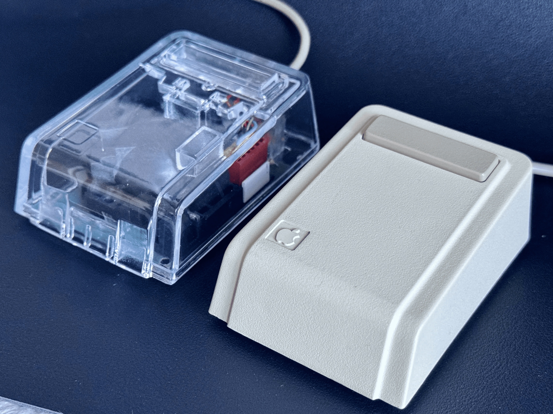

So, the Lisa Mouse I ordered from PCBWay finally arrived. The production and shipping process, at least for this is WAY slower than JLCPCB, which is unfortunate because I paid way more for shipping (JLC3DP shipping for this mouse parts usually runs me $1.50 and arrives in about 1.5weeks. PCBWay was $20 shipping. I ordered this mouse on January 21. It arrived on February 25th. Not great...
HOWEVER, I must say the quality is very noticeably better. Here's some side-by-side shots with the JLC3DP version:

So if you're looking for a display piece, it may be worth it to get the PCBWay version for the most visible parts.
Also, they had no issue with the Apple logo.

So it seems the on the LEFT in your photos is PCBWay because it "clearly" looks better than the one on the right in terms of transparency. And the fact it has the Apple logo is a huge difference that cannot be understated. I therefore would consider the COST and WAIT TIME to be insignificant in light of that, and I shall start using PCB way to create any 3D prints where QUALITY MATTERS. Because... wow. The difference is big.
Yes, you are correct that the one on the left was from PCB way. You can really see the difference in clarity when I put it over the paper with printing on it.
But I do agree with you that when quality is a concern, it seems like there’s a drastic difference. I may need to look into optimizing shipping costs with pcbway for my important parts. I just wish it wasn't 7x the cost!
It's maybe 2x better in quality, but certainly not 7x better.

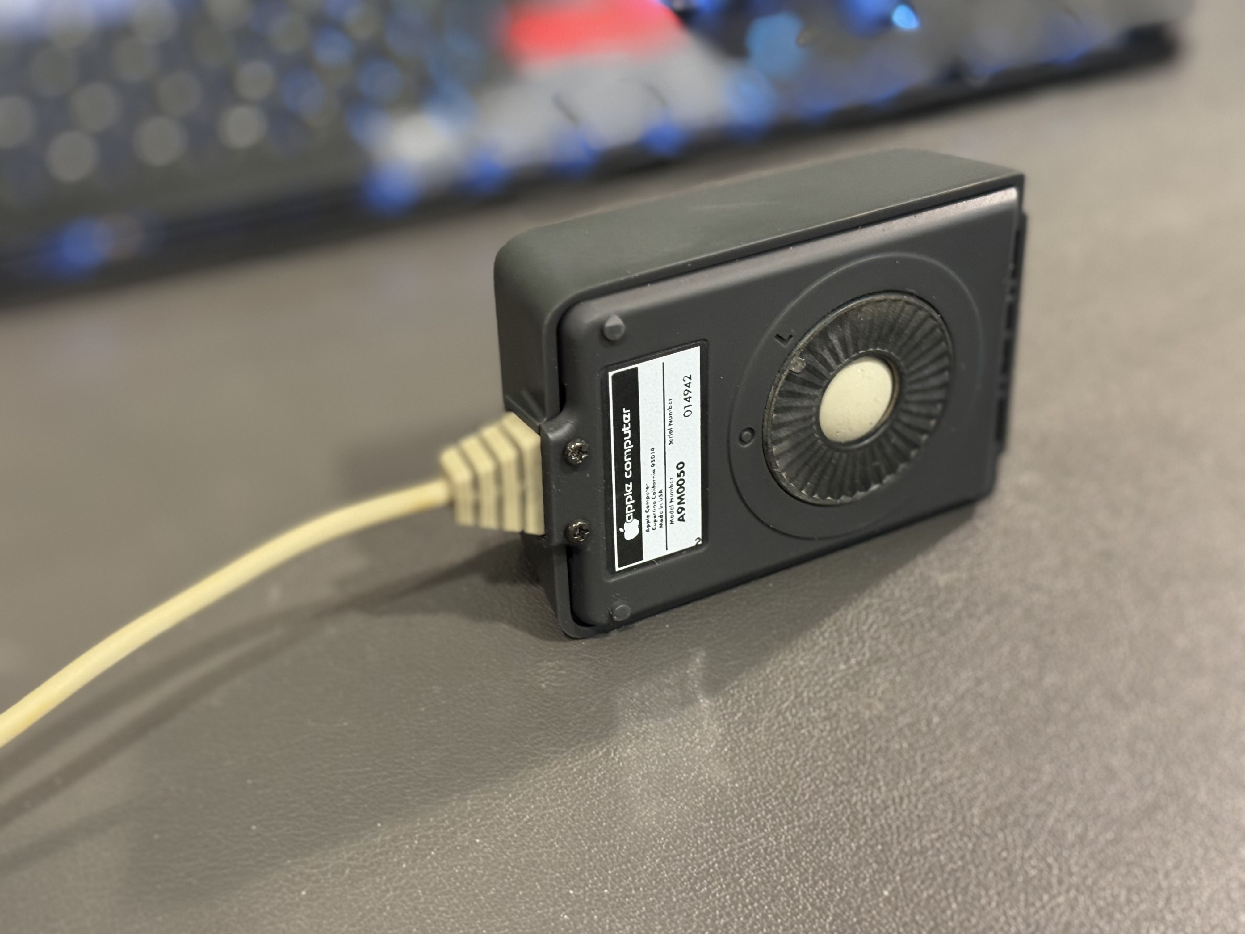

I received the resin print of my adapted version shown above, which was designed to accommodate the variant of the A9M0050 mouse that has a slightly larger PCB and it seems like it will work fine for both versions. I say "seems" because I can't be sure because I technically cut up the PCB on my larger version, but it looks like it it hadn't been cut, it would fit. The smaller PCB that the original @Stephen design was meant for should also work just fine. It will look less like the original, but it should be a more universal fit.
