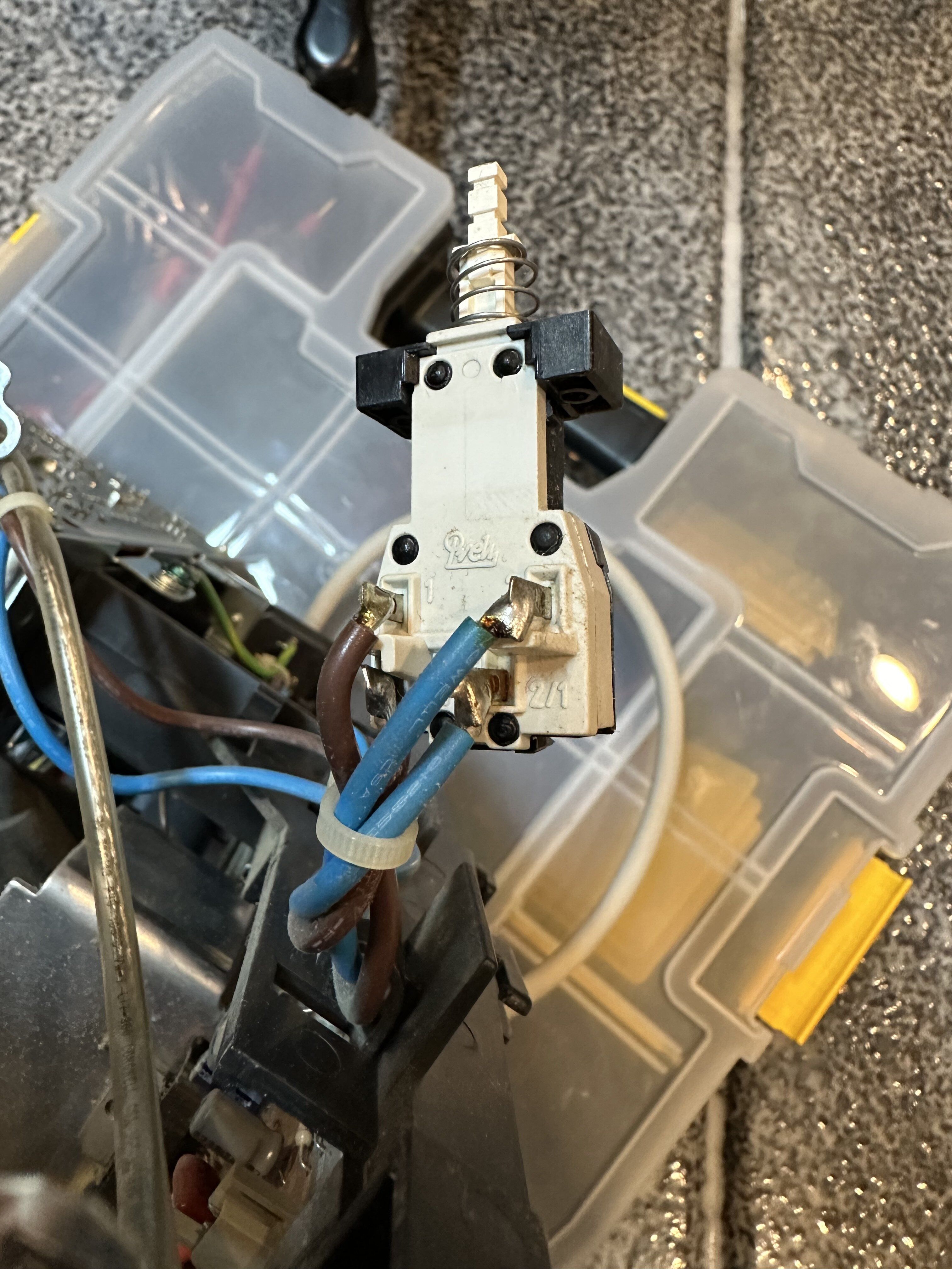

This is the switch. I ultimately bridged the same-colored wires together to have it be always-on.

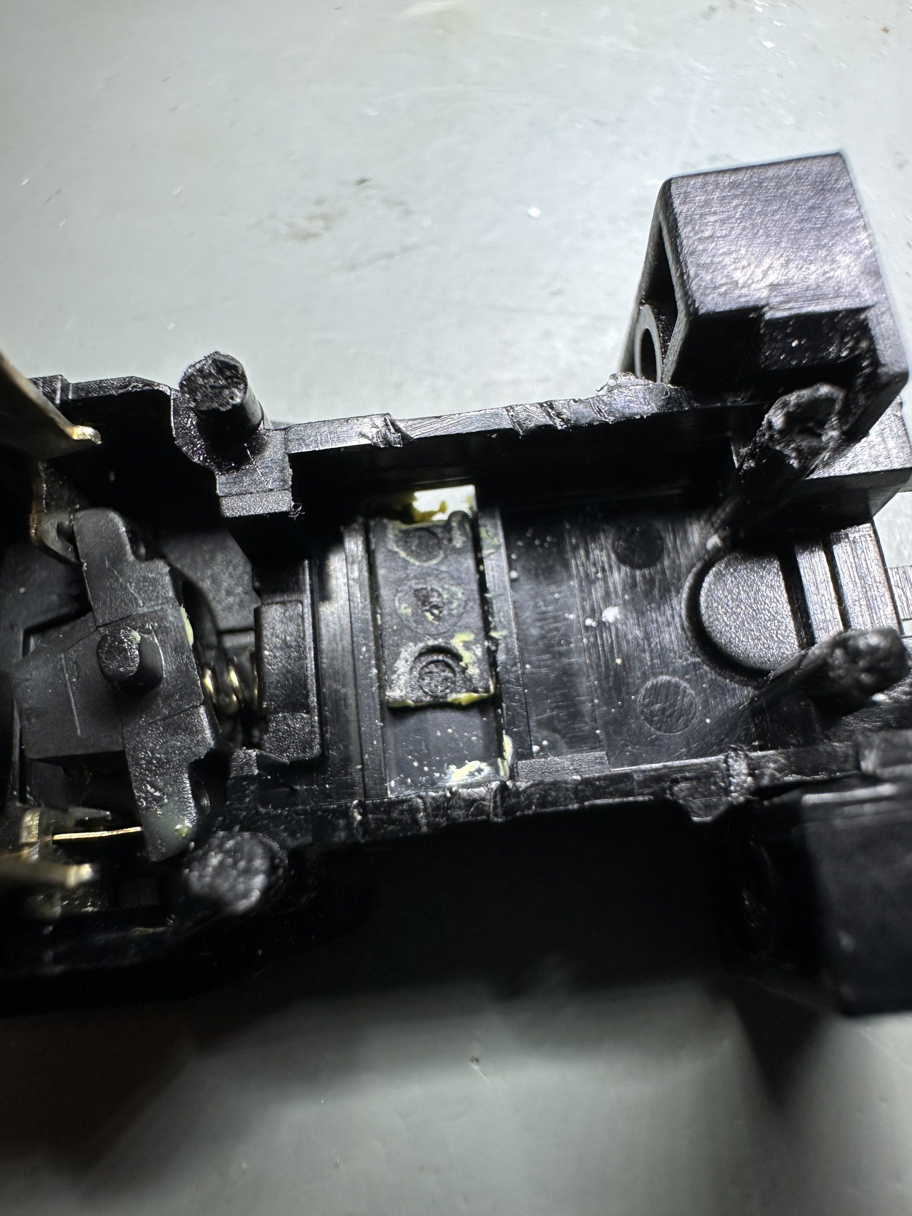

Here you can see the black rectangle with the nub that sheared off.
