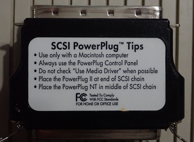

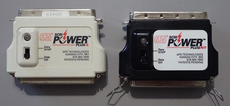

A couple of curiosities I picked up -- APS SCSI Power Plug II. I assume these allow you to 'hot swap' or 'hot power' SCSI devices.

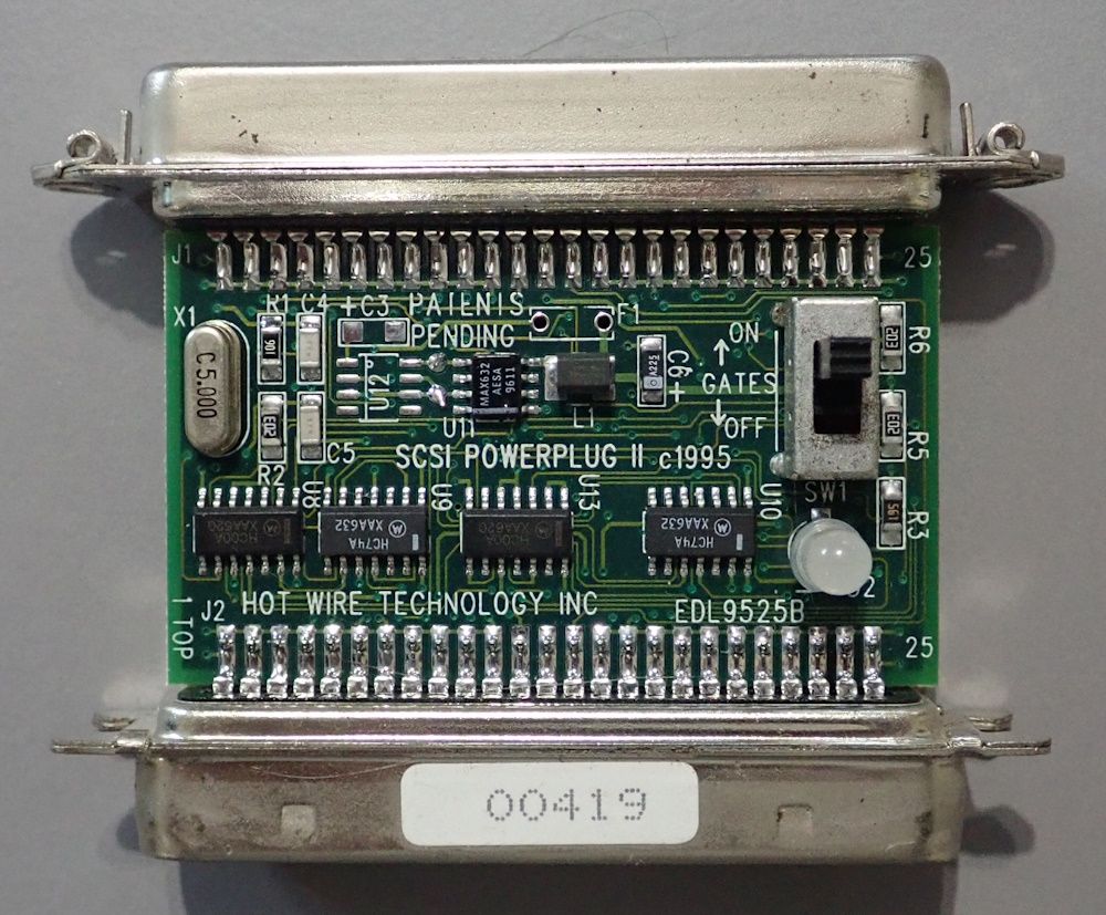

Insides pictured below:
X1 is a 5 MHz crystal.
U11 is a MAX632 step-up voltage regulator
L1 is an inductor needed by the MAX632.
U8, U13 are 74HC00A NAND logic chips
U9, U10 are 74HC74A flip flops

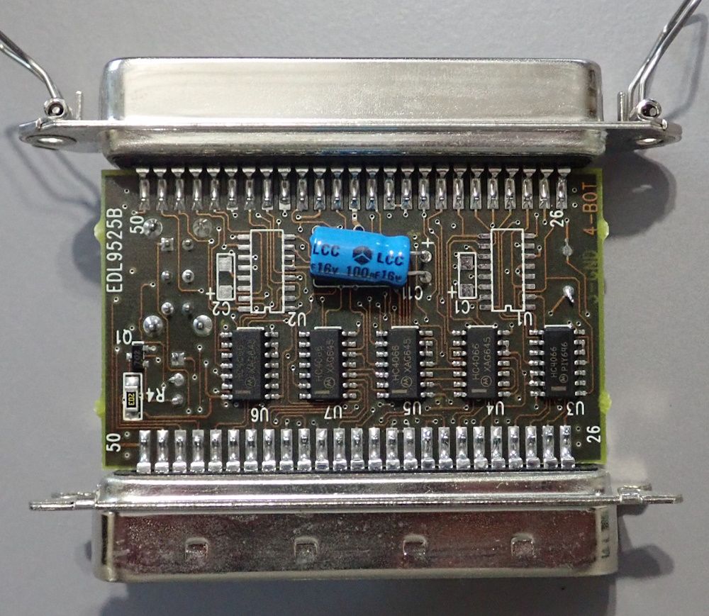

Below:
U1, U2 are Texas Instruments active terminators
U3-U7 are 74HC4066 analog switches
Q1 is a transistor to drive the led

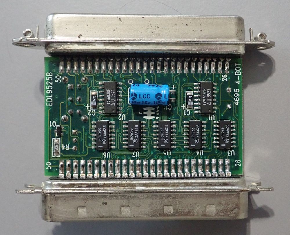

Below: The NT version is the same internally as the regular version, except it is missing the terminator chips. So, NT stands for 'no termination'.
