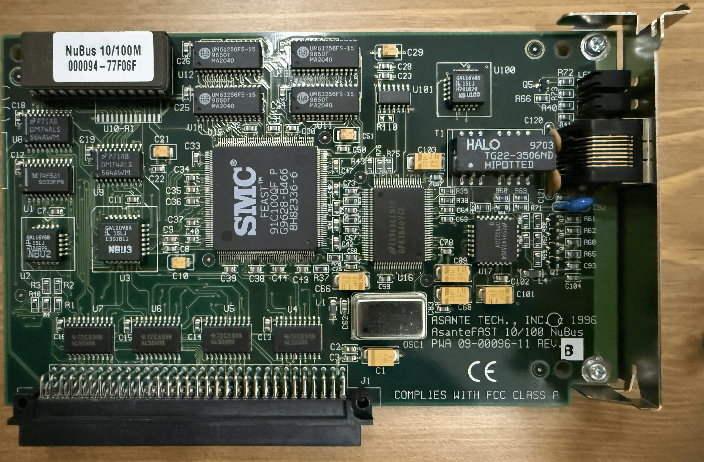

Hi, folks!

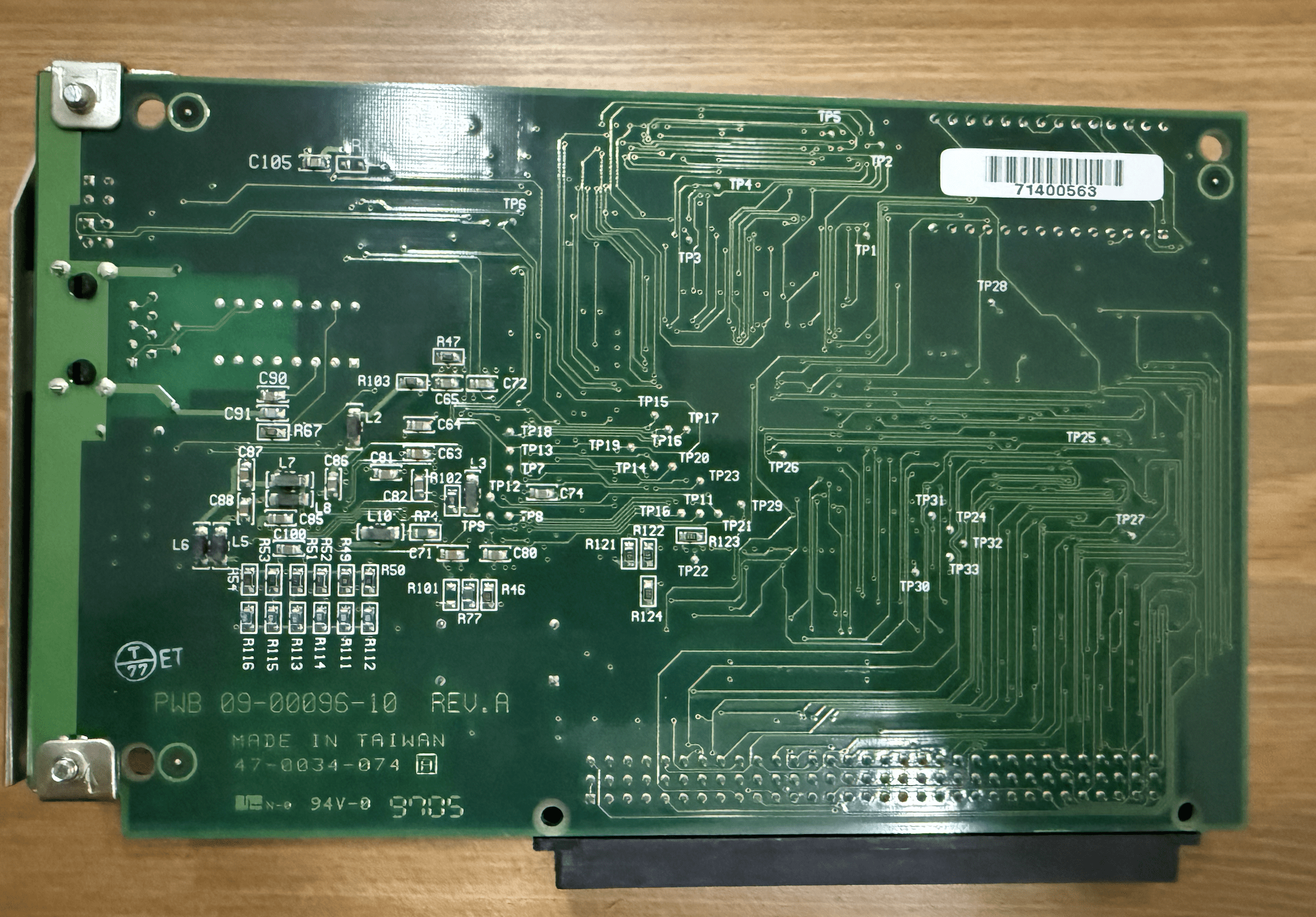

Recently I was lucky to get a network card with a 10/100 Mbps AsantéFast applink.
The card is new, as far as I can tell, the card, driver and additional software were sealed in packages and there is no trace that they tried to open it.
I installed it in Quadra 950 to check how the network works -- surprisingly fast when compared to the built-in network card that I use through the adapter.
But that's the question. If there is any way to check the bandwidth of the network so that real numbers are visible, not my feelings when copying even large files. Any ideas?
I usually use iperf for modern systems, but I don't know what might be needed on Mac OS 8.1.
I took a few photos to leave the information about the card here.

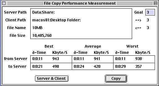

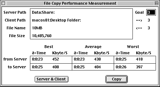

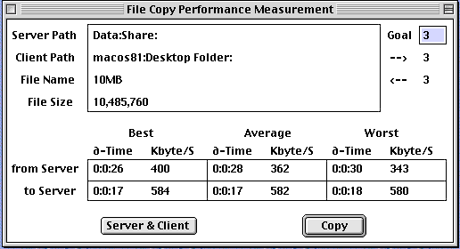

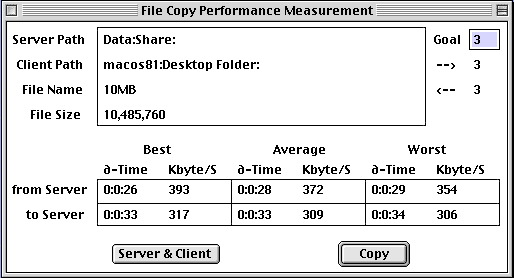

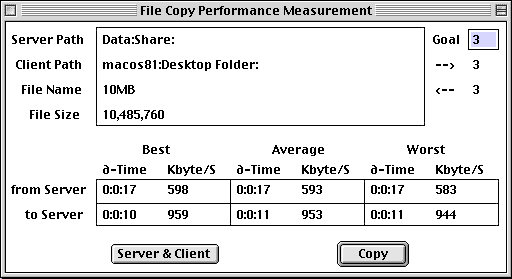

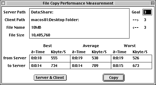

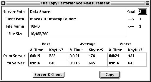

I did some testing.
The server was Power Mac G4 QuickSilver with an shared directory and a 10 MB "dummy" file
Quadra 950 and built-in network card
Quadra 950 and built-in network card + PPC CPU Upgrade 66 Mhz
Quadra 950 and Asante
Quadra 950 and Asante + PPC CPU Upgrade 66 Mhz
Power Macintosh 8100 and built-in network card
Power Macintosh 8100 and built-in network card + NewerTech G3 300 Mhz
Power Macintosh 8100 and Asante
Power Macintosh 8100 and Asante + NewerTech G3 300 Mhz
To say that I'm surprised is to say nothing. Previously, I was sure that an external network card always gives an increase in performance.
It turns out that the 10/100 statements were marketing. Probably the real benefit of this network card is that thanks to the support of 100 Mbps uplink, it is guaranteed to connect to modern network equipment.
