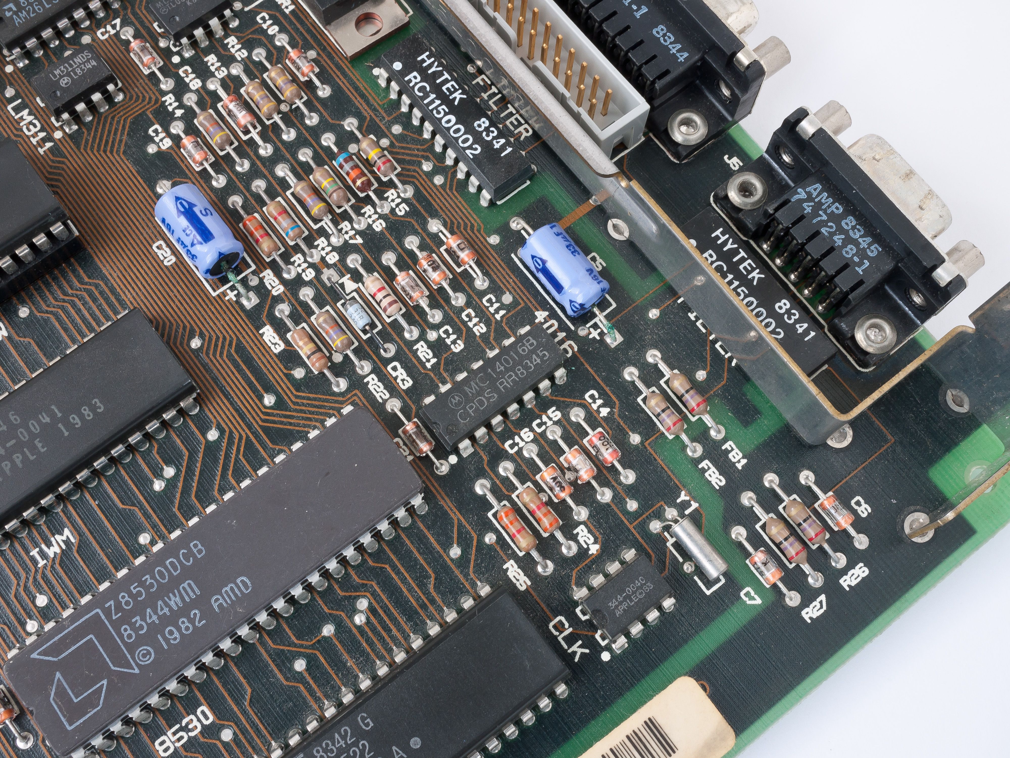

I was going through photos today and found my stash of Macintosh 128K Photos. One in particular shows something that inspired me to create this thread in the first place. Two axial caps had clearly leaked (note the greenish substance below, and bear in mind that photo was taken back in 2012):
That's not a one-off either. I've had axial on my analog boards spout leaks like that over time.

So yes, motherboards for the Mac 128K, 512K and Plus do in fact need recapping, regardless of them "working just fine."
