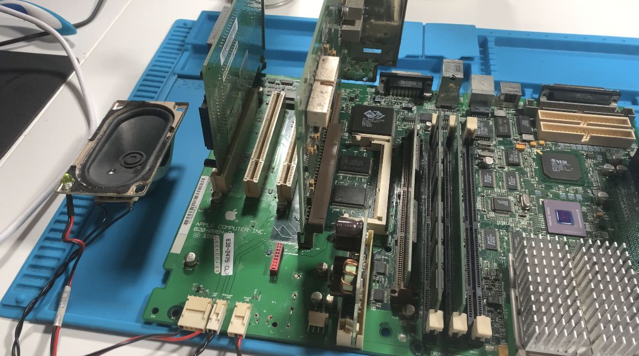

I picked up the filthiest G3 Desktop from eBay. Stripped it down and did a cleanup of the battery corrosion, replacing it with a CR2032 coin cell.
With the logic board on the bench, connected to an ATX PSU (with the PSU Type jumper set appropriately) and with the speaker and Whisper PERCH board installed, I head the startup chime!
However, it’s not quite right still. Sometimes it’ll refuse to power on. Sometimes the PSU will stop and start a few times before the chime. Currently, I’m struggling to get it to start at all.
Unpredictable startups makes me suspicious of the SMT capacitors, so I’m planning to do a recap of the board.
So, a couple of questions: does that sound like a reasonable plan of attack? And also, I’m struggling to find a schematic for the Gossamer logic board. Does anyone know of one online? Oh, and I know the machine’s a bit too obscure for anyone to have bothered putting together a recap kit, but does anyone happen to have a list of caps on the board? I have a couple of caps whose labels are illegible. I may well be back here asking if anyone has a Gossamer, and would they mind checking the cap specs at a few positions, if that’s okay!
Thanks for your help!
Chris
(edit to add: I’ve no idea what, if anything is on the display — I’m still waiting for Mac-to-VGA adapter! Anyway — once I’ve got it starting reliably, I can at least get the scope on the video signals to see if they appear okay, even if I don’t have the adapter yet!)
Here’s before and after. Cleaned up really well with white vinegar and a distilled water rinse.
I’ll start putting together the cap list — at least the ones I can read!
(edit: the underside was pretty much untouched — cleaned up fine with some IPA only. But, I admit I’ve not checked incredibly closely for bad traces — I didn’t worry as the machine was starting up (mostly) fine)

Whilst I’m waiting for the VRM board caps, I’ve been having a fiddle.
The machine was in a state where it did absolutely nothing when power was applied.
I noticed a bit of gunk at the top left of the board, near the PSU Type jumper, so I gave it a spray with some IPA to start cleaning. To my surprise, the PSU fan started whirring — I’d accidentally left the switch on!
Now, the machine still wasn’t starting. The fan on the PSU would repeatedly spin up, and the power LED was dim.
I turned it off, finished my cleaning, and on a hunch got my multimeter on the PSU Type jumper pins.
I was getting continuity on the MAC side, even with no jumper! So I gave that a thorough clean and now I only get continuity on the pins which are jumpered — the ATX pair for me.
Now the PSU fan spins normally and the power LED appears to be full brightness. But still, the machine no longer chimes. Ugh. I hope something hasn’t popped!
