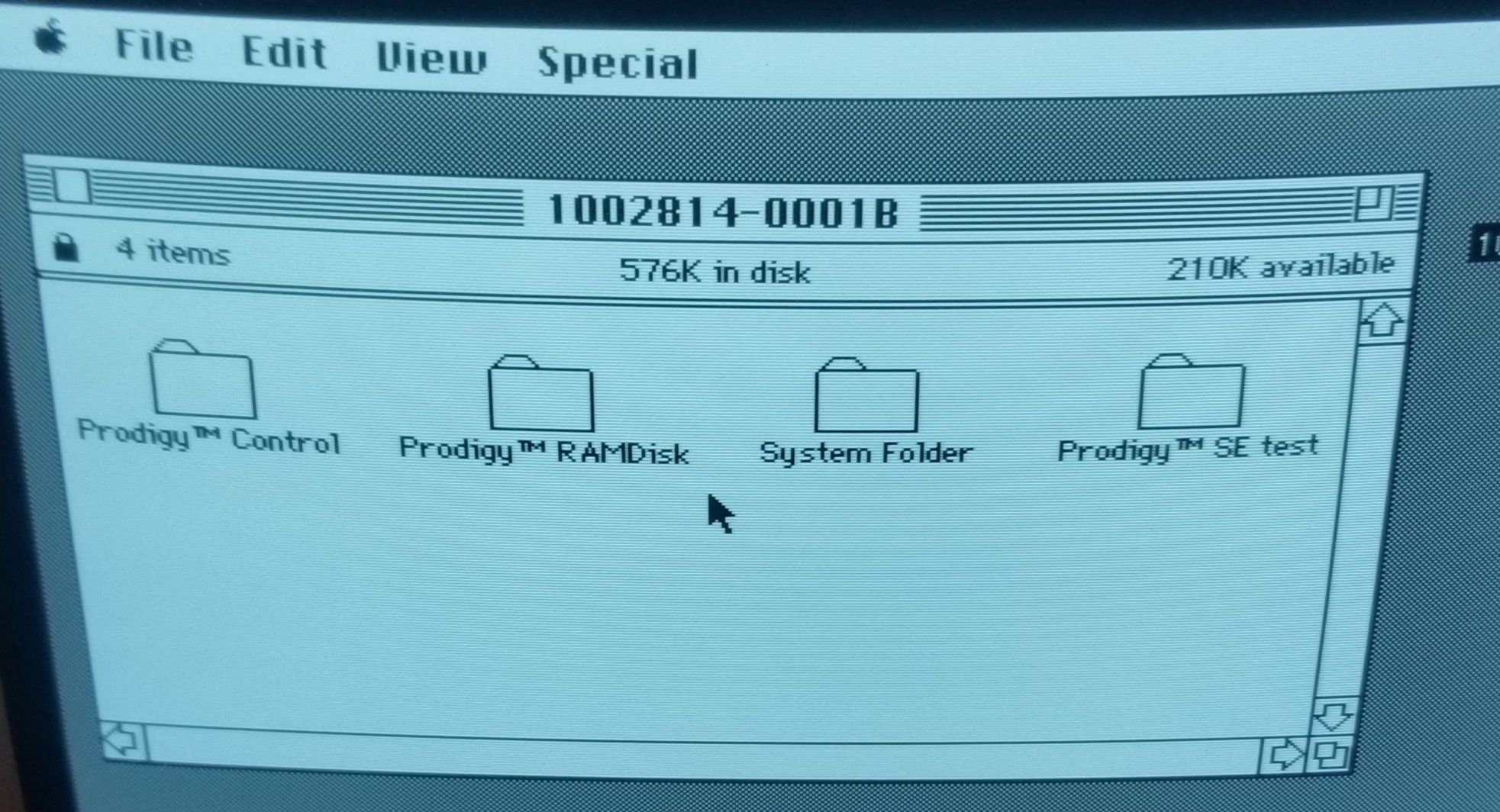

With the ROM programmer, I was able to read and verify several identical AM2764A PROMs (that used to run in an old SMS SCSI controller).

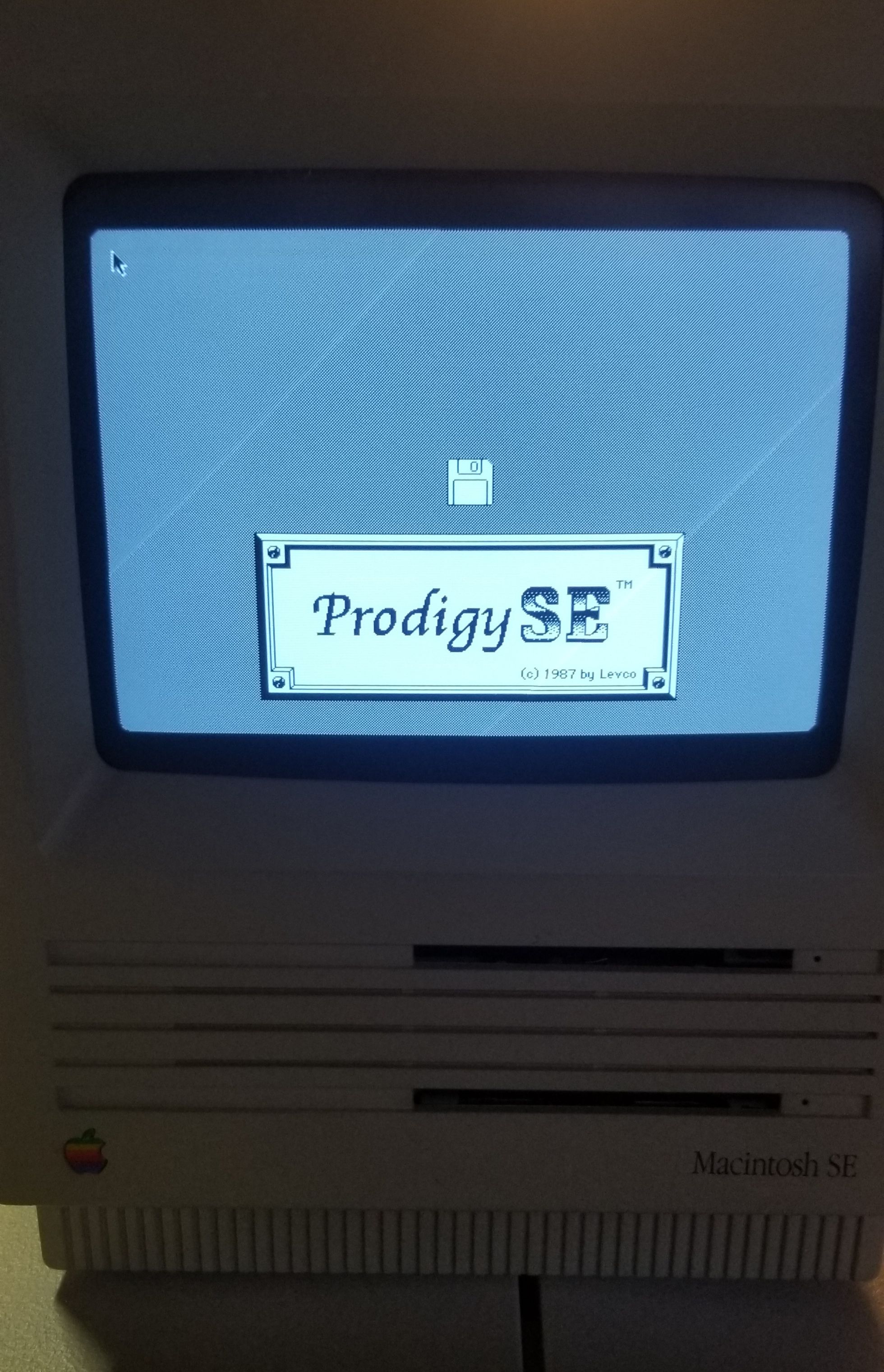

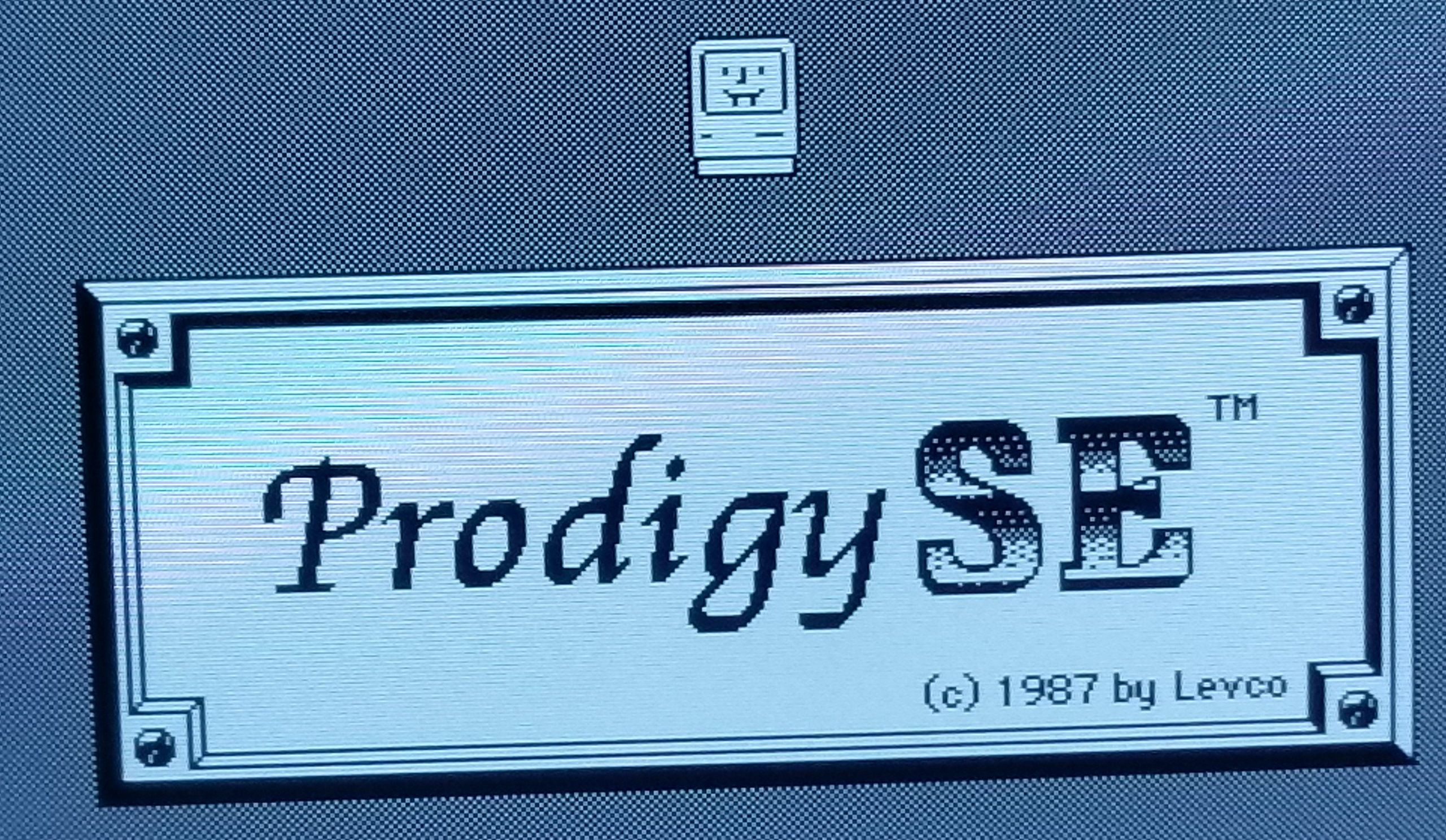

I tried using the ProdigySE in a "reloaded" SE config with new ROMs, SWIM and 800K drive on an older 4Mb SE board, and it seems to power on OK, but hangs as soon as I put in a disk. This symptom was the same whether I used SWIM or IWM. Has anyone else seen this kind of issue in a non-accelerated SE? I will try the same test using my new rev SE board. I am trying to figure out if the RAMDisk hang I am seeing changes with different ROM or RAM configs.
I have already ruled out System version - no version fixes the hang. The RAMDisk should just work, but there could also be some other issue with my SE motherboard or ProdigySE board. The other possible issue is that the SE RAM modules prevent the ProdigySE from fully seating into the expansion slot...but it seems to work, except for the RAMDisk. But, there could be a pin contact issue. I might look for a male-female mezzanine connector to raise the slot a bit. However, on the side of the connector closest to the SE RAM, the Prodigy connector pins are longer to account for this issue.

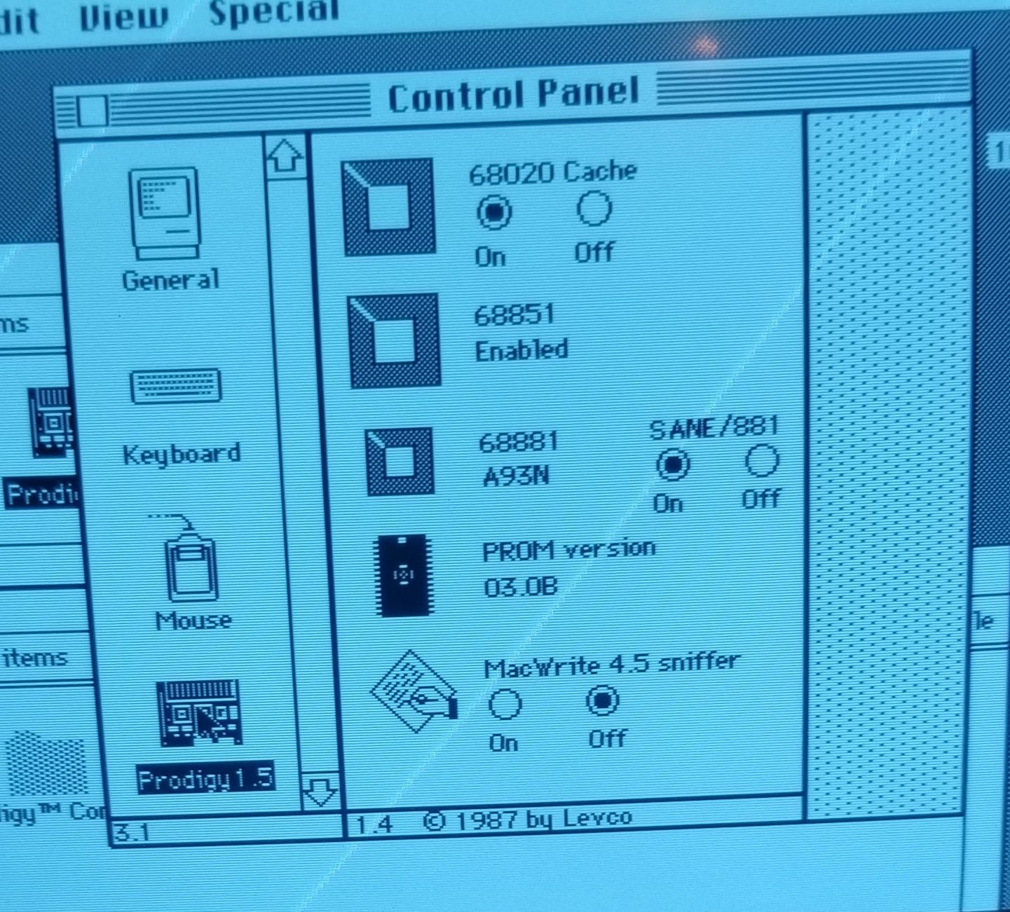

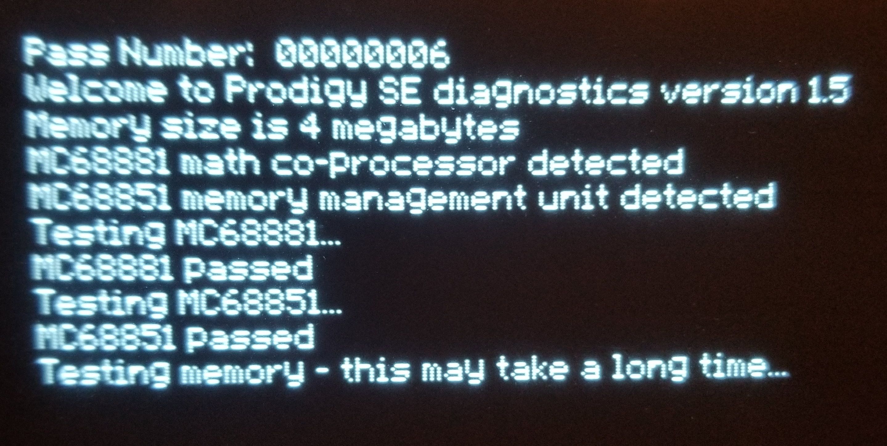

It looks like the ProdigySE board probably requires something to be in the PMMU socket -- either the Levco BMMU placeholder or an actual MC68851RC16A. When there is nothing in the socket, there's no power-on beep, no boot process, and my ProdigySE generates a checkerboard pattern.
This issue occurred because I tried pulling the PMMU to see if it was related to the RAMDisk lockup noted above. I know someone else with the same config board, albeit with Levco BMMU blank, and their RAMDisk is working. But, no luck.
However, discovering the checkboard pattern is an interesting detail and probably indicates that the blank has some included sense and/or is a shorted-die placeholder PCB. Also, it was helpful to use the PMMU in my Mac II in place of the HMMU to test out VM, and it worked. So, worth the effort.
If you have a ProdigySE and you see the pattern below, there may be an issue with your PMMU socket or whatever is plugged into it.
I was able to locate a 2Mb Prodigy/SE board, so I should be able to do some more VM experiments and also compare my PMMUs to the one in this board (if VM) works to see if my new old stock PMMUs are any good.
