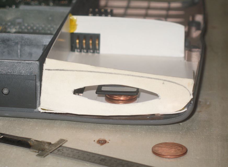

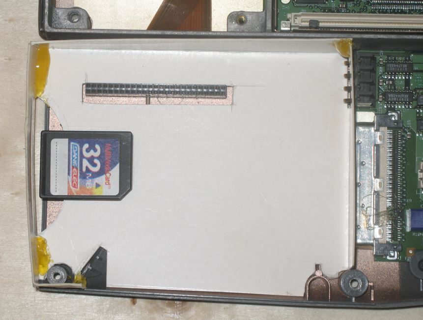

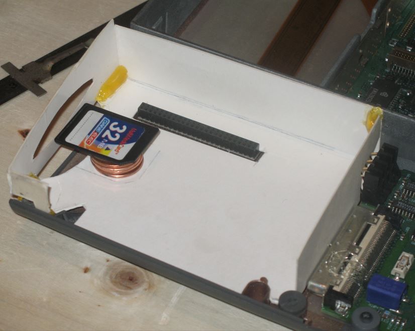

BlueBird-SD-Module: a boutique build for BlueSCSI in Blackbirds?
One last shot, putting this stuff away in the project box today.
Not pretty:
__ vertical full size USB is a no go, TinyUSB flat on board should align well with puckered lips
__ forgot to mark out the LED activity light on right
__ everything's out of whack, but centering openings up shouldn't be hard to visualize.
__ size of lips can be smaller given push-click-eject SD access
__ may give in to temptation and make a pretty overlay for one last pic?
Dunno, whatcha think gang?

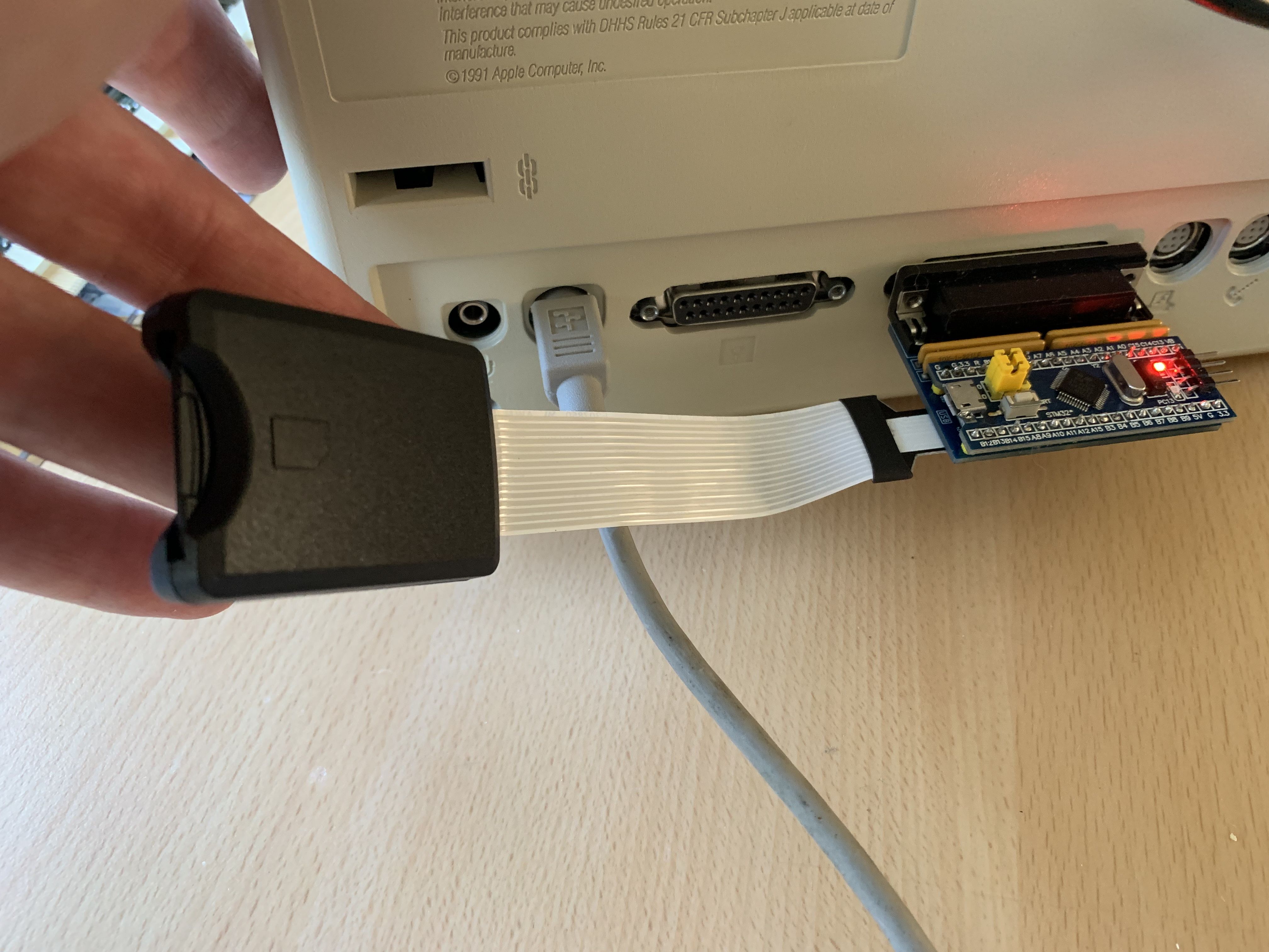

Yep, that's the type to be avoided due to its slip-out SD card feature. Mentioned reasons for avoidance upthread…..
it has a decent locking system to the card:
-See video below-
