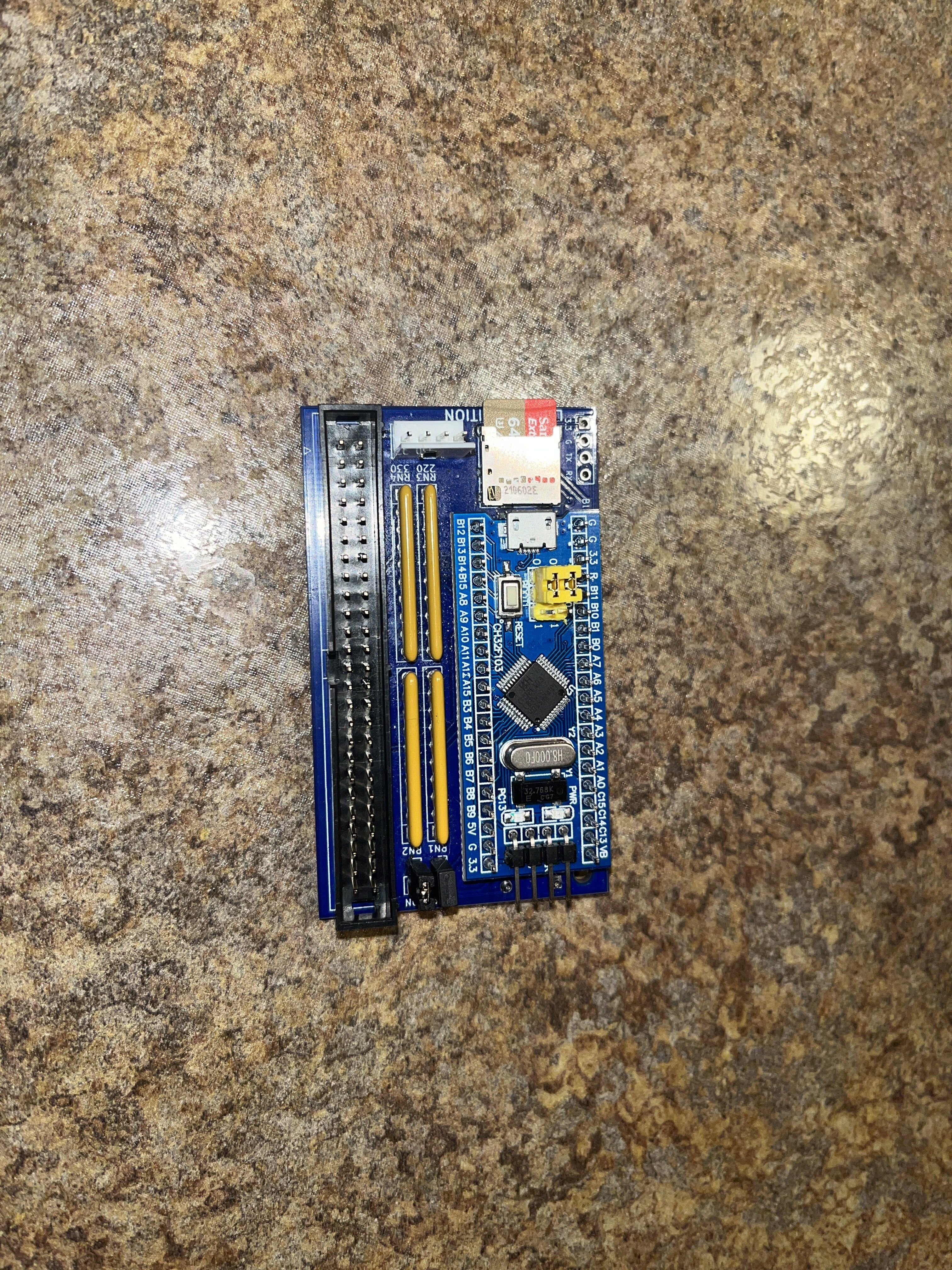

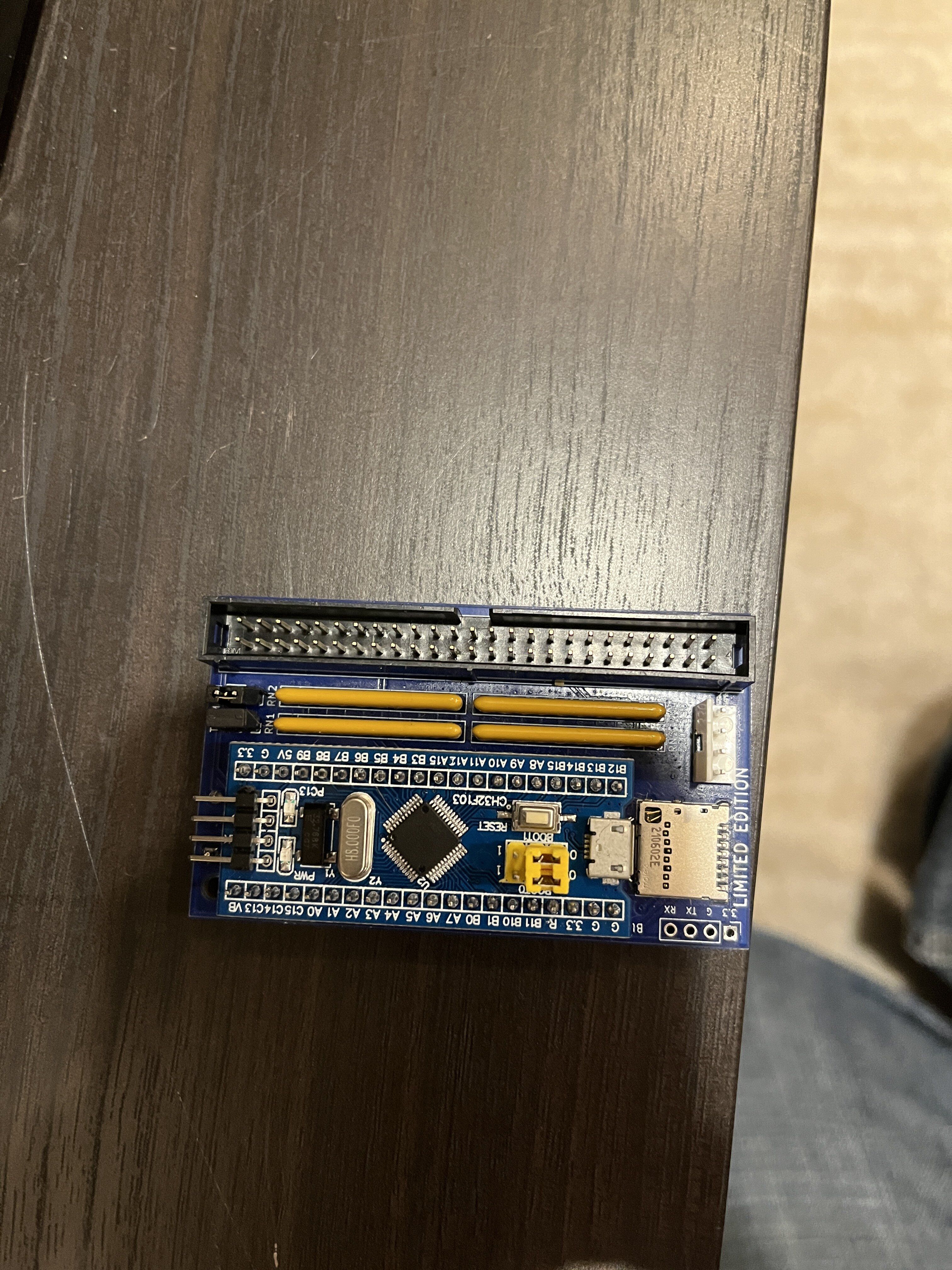

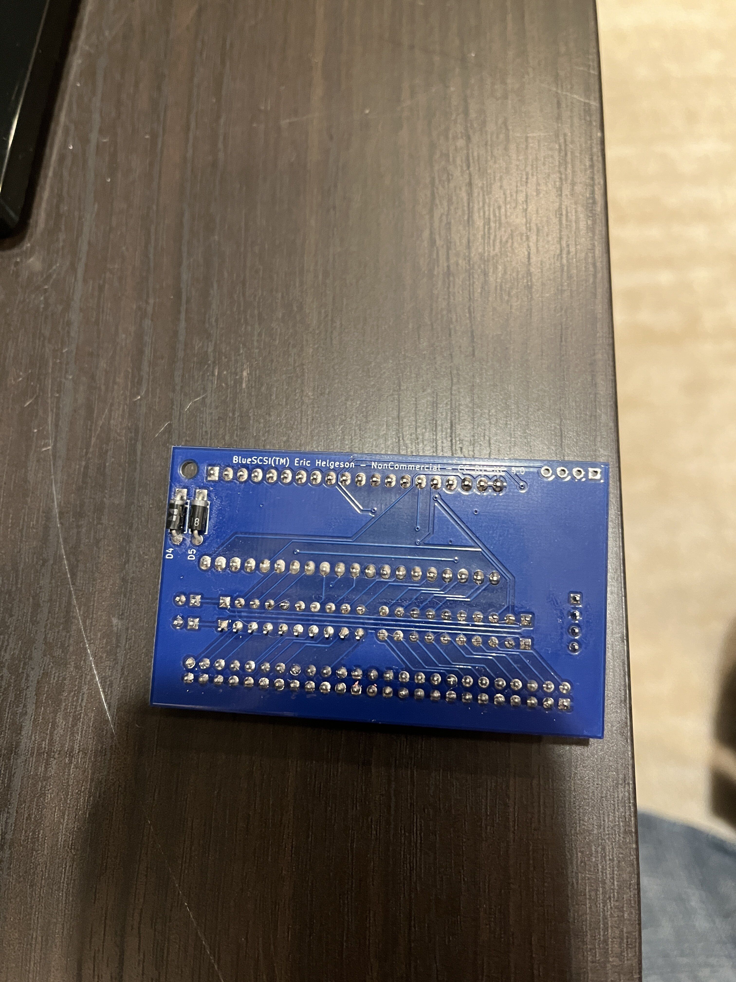

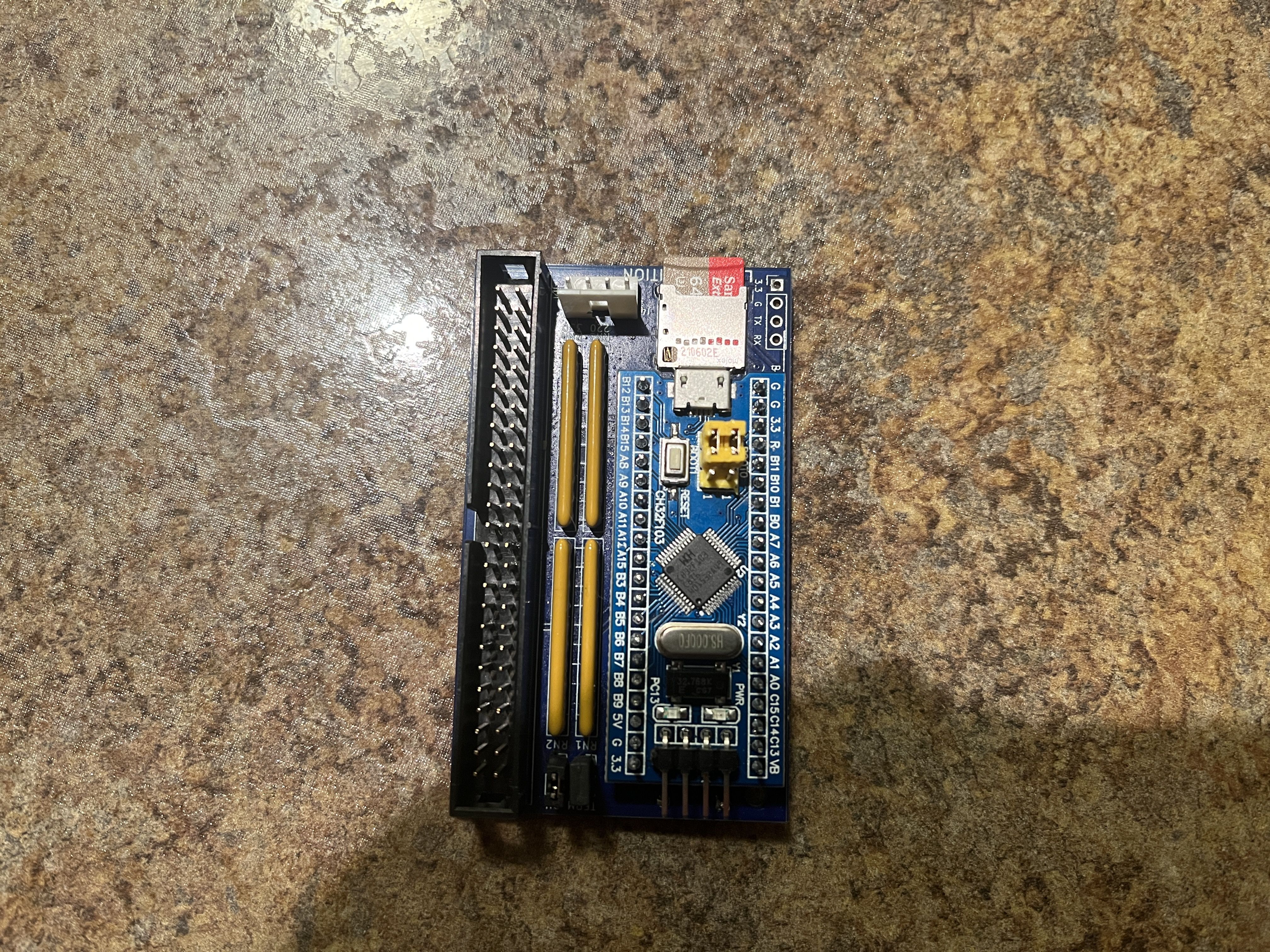

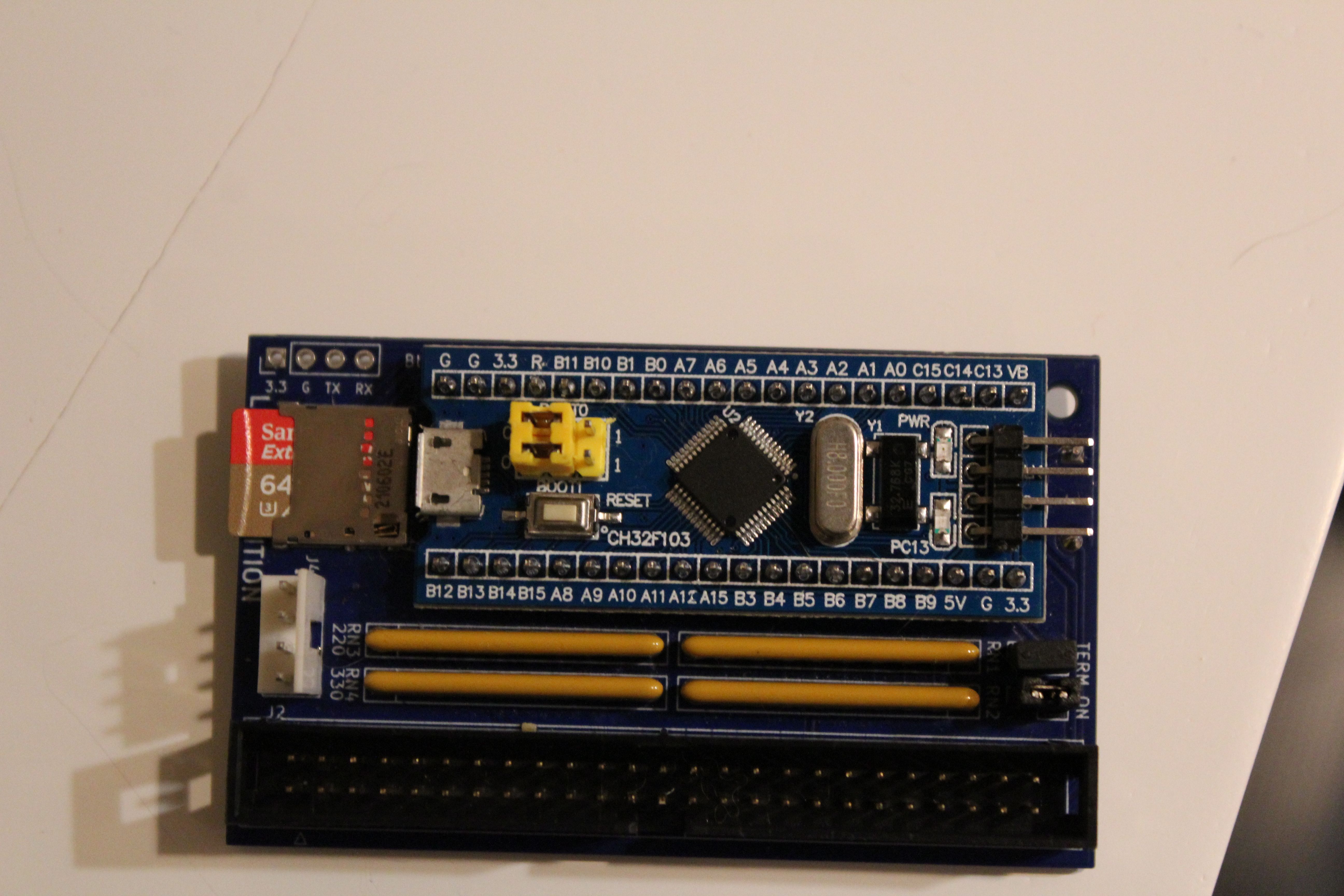

Well I went and used this as an excuse to finally upgrade my SLR! I also grabbed a work light to brighten the scene. I don't have a macro lens for the new camera but hopefully these pictures are clear enough. I did not expect this to turn into a photography project, lol

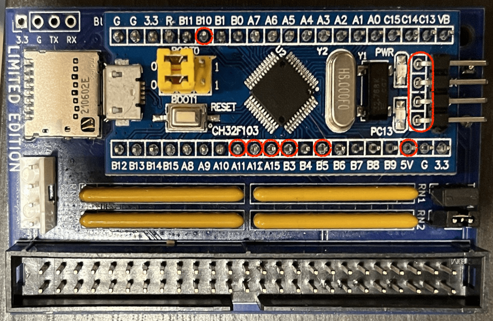

Big difference! :) Even the location at B5 looks soldered just fine.
A work light? I learned the hard way that it's not the best lighting for photography or a green screen. Nevertheless, I am not sure that not all iPhone models can equal well-equipped SLR cameras. Using the camera is nice when the phone doesn't produce the needed results.
Other than the solder blob at C14 which isn't hurting anything, I cannot see anything wrong.
I guess the white I am seeing under the main chip on the BluePill is silkscreen. Even so, I can't help but wonder if that chip being a fake instead of authentic could have something to do with it.
