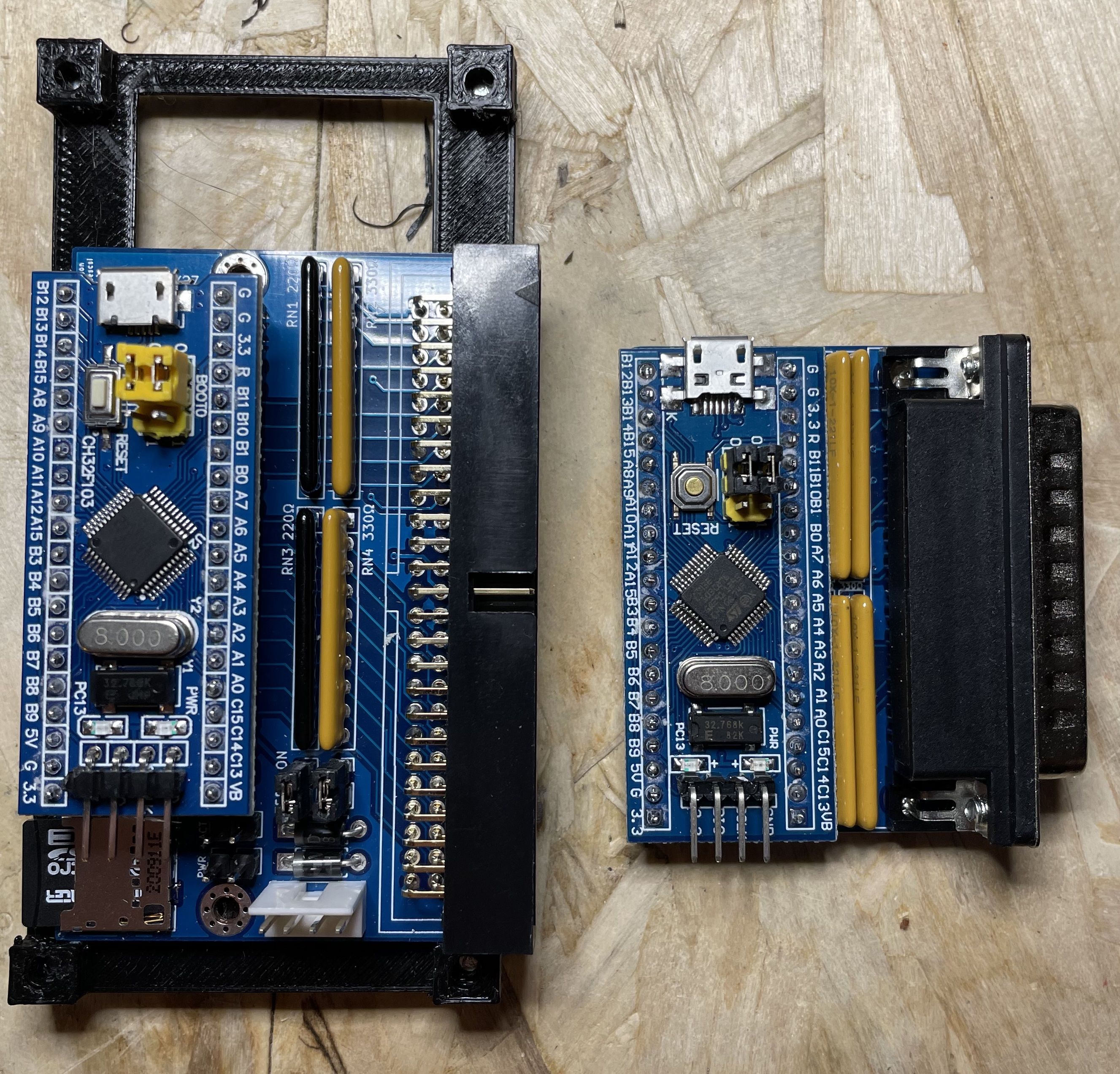

Happens to the best of us! If you need a spare v1 board just let me know (though the rpacks should be failry easily to remove with your equipment)
Thanks, I got 'em swapped around and now both units are working as they should.
While I was at it I desoldered a couple other parts from one of them to help facilitate a custom mod I'm working on... :devilish:
