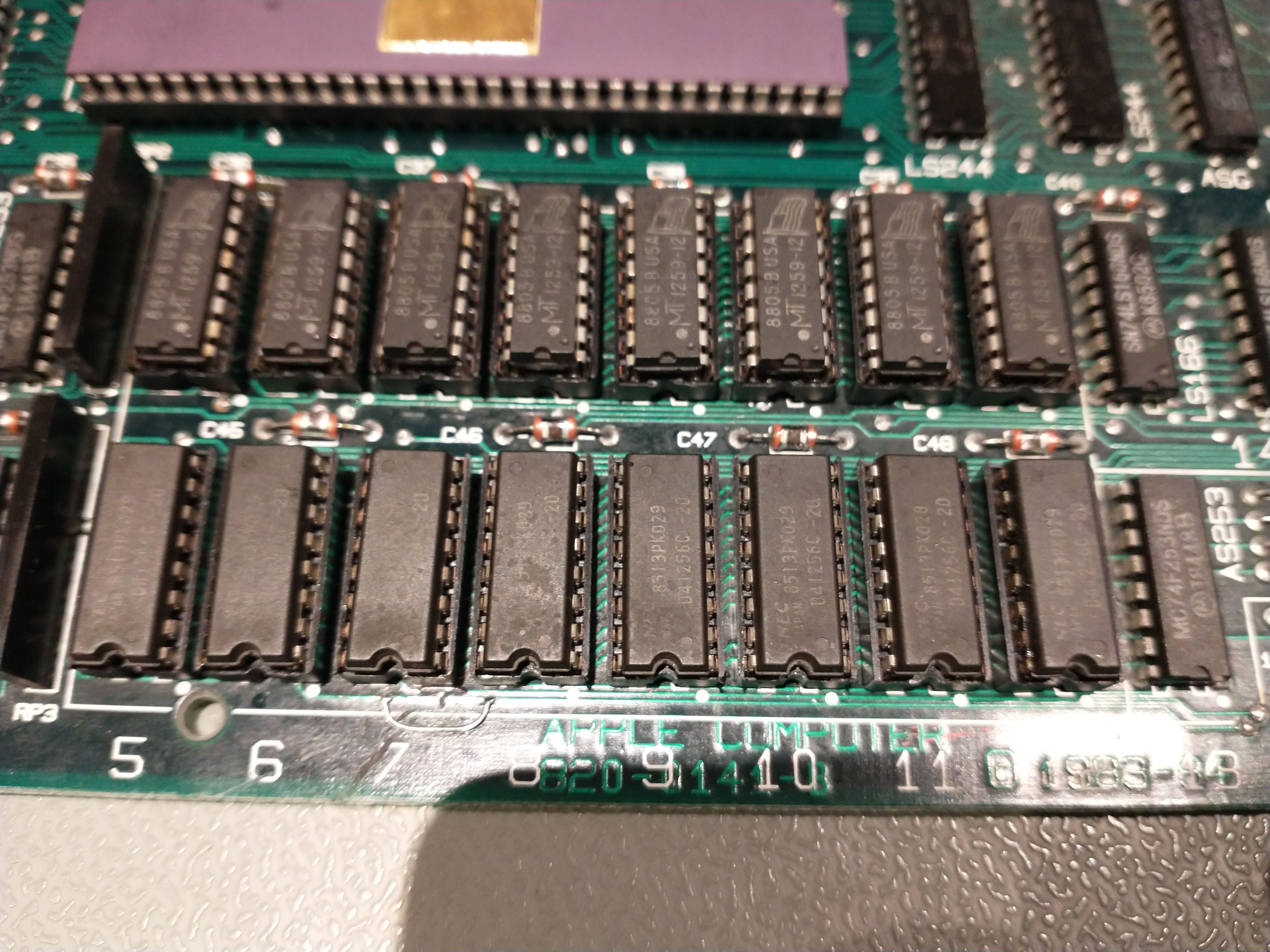

I've recently got around to removing the 18 DRAM chips and socketing them. When I chip-tested the 41256 DRAMs 4 of them failed test so I was excited that my 512K
Mac would soon live again.

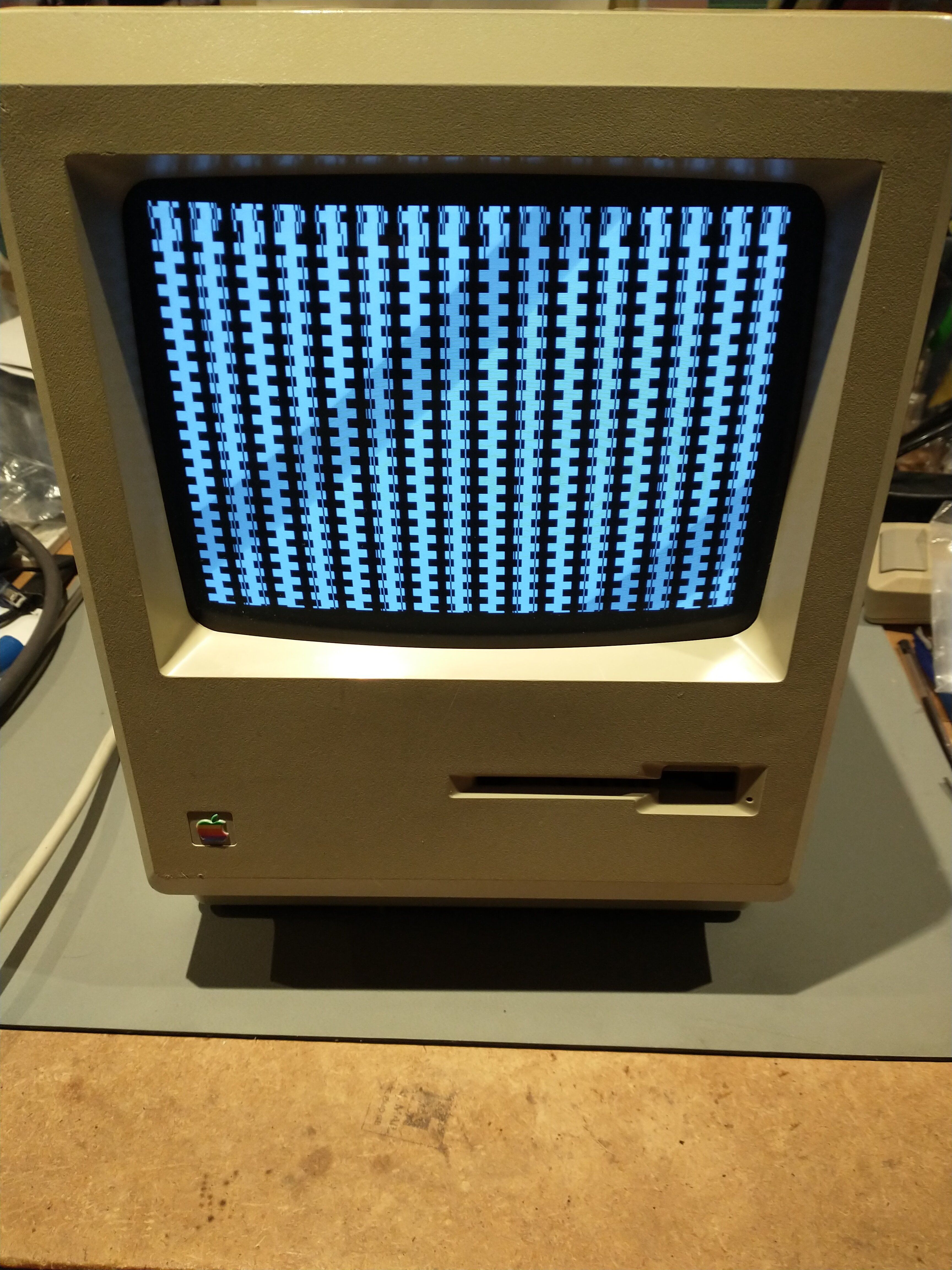

Having added sockets and fixed any bad traces, and then tested 18 chips before inserting them, I still have the same problem with the board, see attached photo.

The RAM chips in the newly-socketed faulty board are all good, I've tested and retested them twice - original fault from 12 months ago still appears.

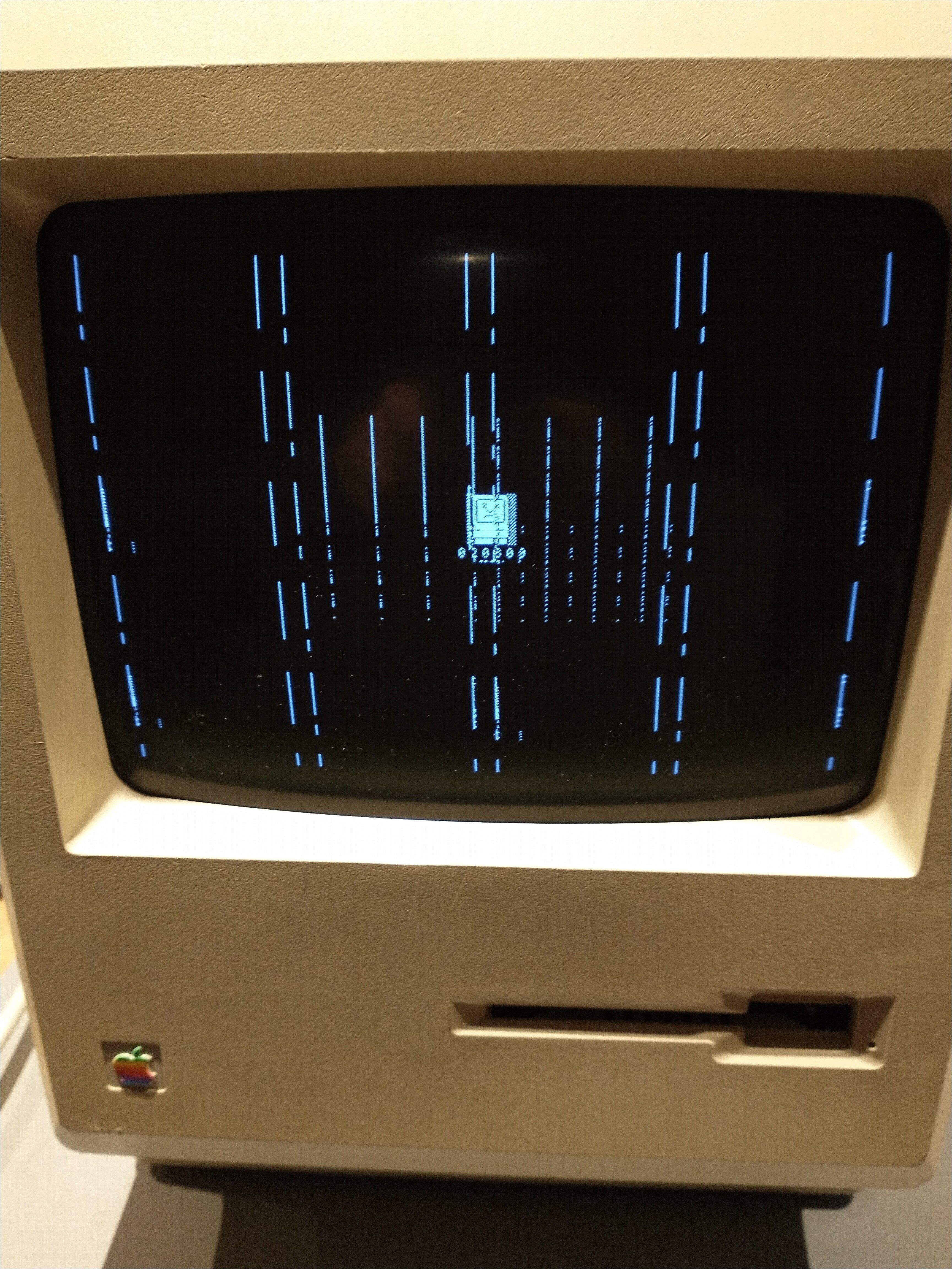

Although I removed 4x 41256 dram from the soldered in chips, that later tested faulty, this scould have been caused by the hot air gun. I still get the same box pattern at powerup. If I remove one bank of Dram chips the pattern changes to every other box in the pattern. The chips I'm using now are 8x41256-100 and 8x41256-120 in the other bank. Could this make it fail post?

Made some more progress with this 512K Mac today. I received 2x 68000 processors from eBay and 64 pin DIP socket from Mouser. Today took out the suspect 68000 which only produced screen bars. Soldered in socket and tried a 68000 processor. Now get a raspy bong noise and what looks like a 020800 error. Tried the 2nd 68000 processor and get the same error. So both new 68000 Processors are okay, the ROMs are tested in another 512K, and the RAM checks okay in a tester. So now at least it's alive again and talking to the ROMs.

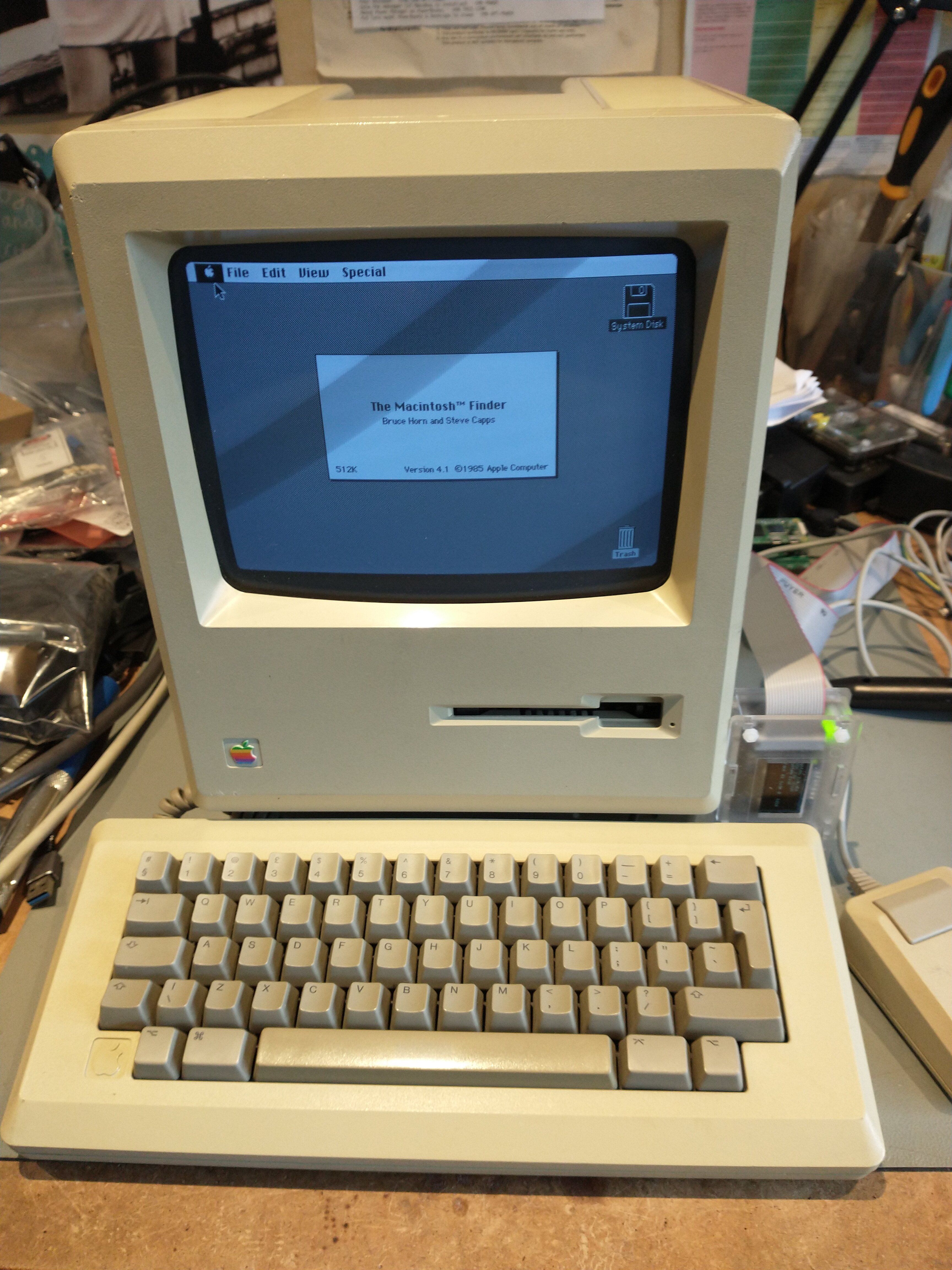

Pleased to report that the 512K Mac is fully working again. I fitted 16 matching 41256-15 chips from eBay and it worked straight away. So they either don't like 120ns chips or/and mixed speed chips. In the end I had a dead 68000 processor and 4 dead RAM chips. I now have a 512K Mac with socketed RAM and processor.
