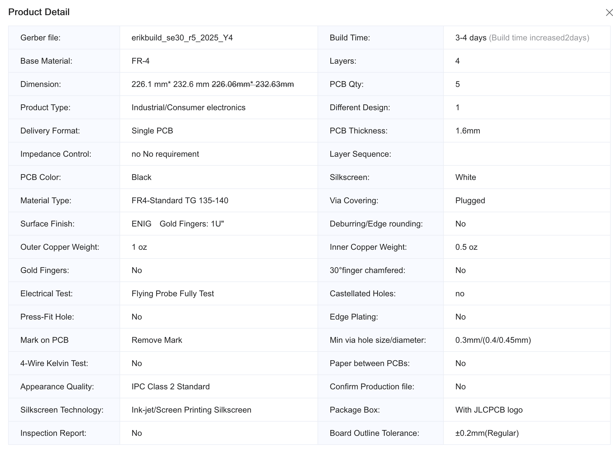

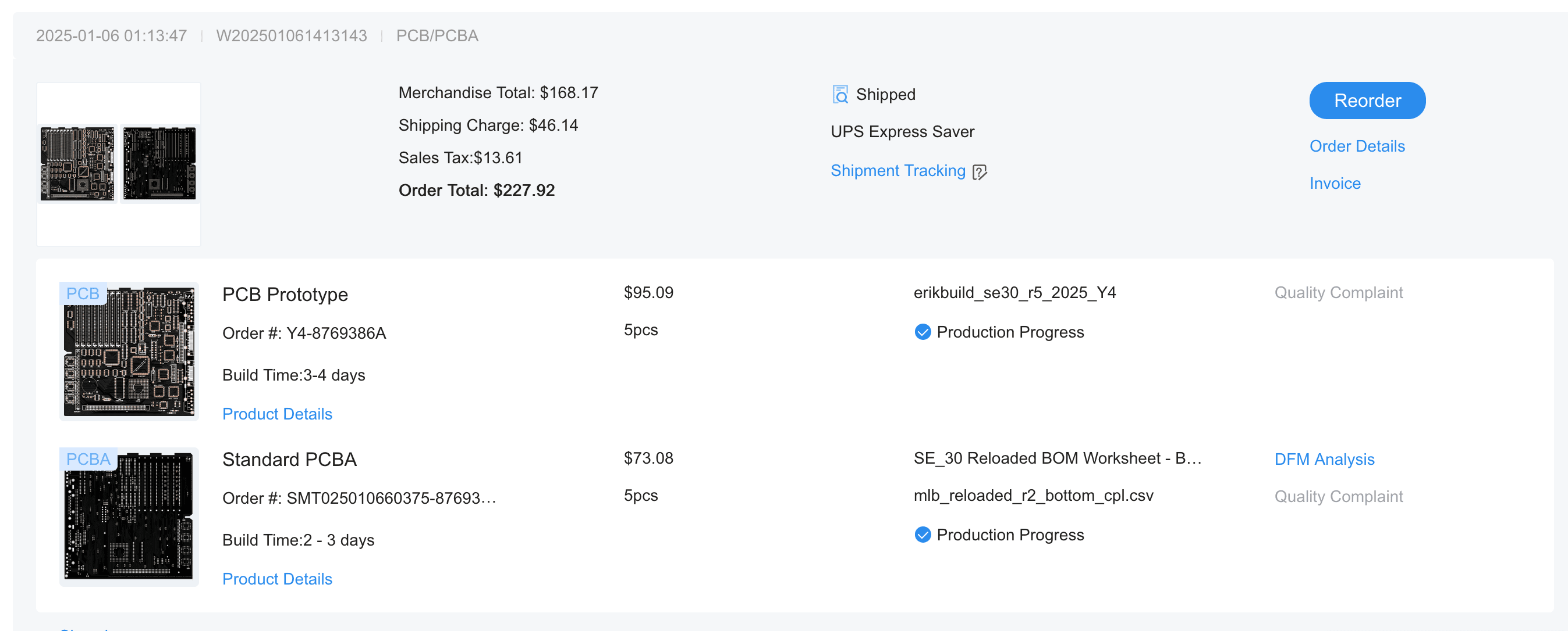

Absolutely, I'd be happy to if you are interested. I'm out of the office today, but I can grab some photos of the boards tomorrow when I'm back at my bench. I had ordered them from JLCPCB in black -- I think they look quite cool, but no worries if it's not your preferred color. Definitely shoot me a DM if you are interested.
I'll also post in the trading post this week -- I ordered 5, and will ultimately offer my 4 spares at my cost + shipping (though I may hold back 1 spare until my own build is done and tested).
Specs of my JLCPCB order (with rear pick and place) attached. I paid $227.92 for 5, so they came out to $45.58 each.
