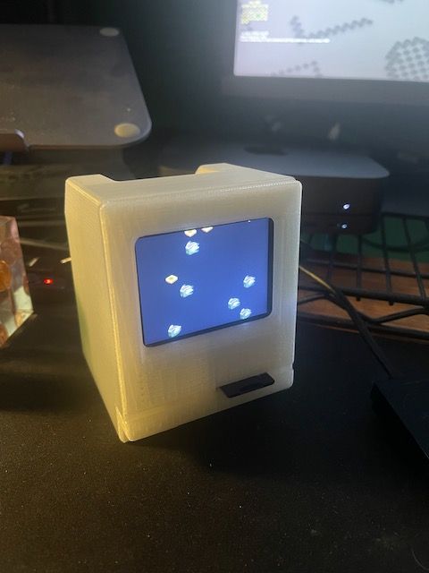

Here is my Tiny Mac running After Dark flying toasters:
Good luck, and enjoy!
