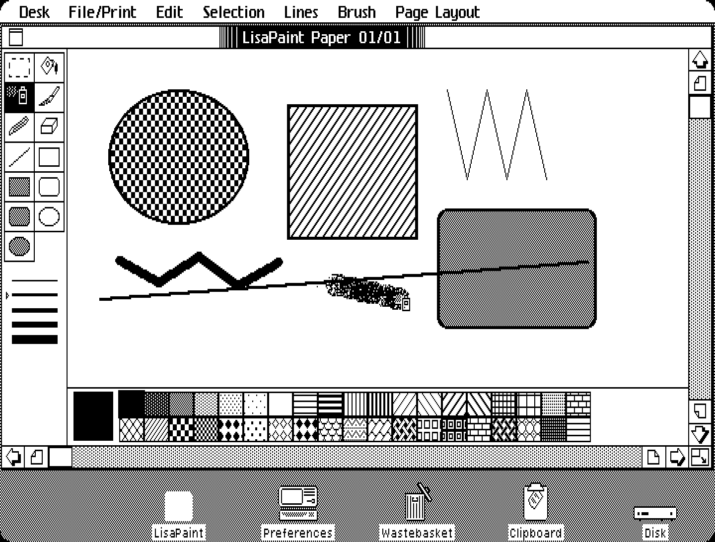

I wanted a way to write Lisa applications in C, so I put together a small cross-development environment based on the Retro68 compiler. If you're interested in developing Lisa applications in C, you can check it out here: https://github.com/pappadf/lisa-c

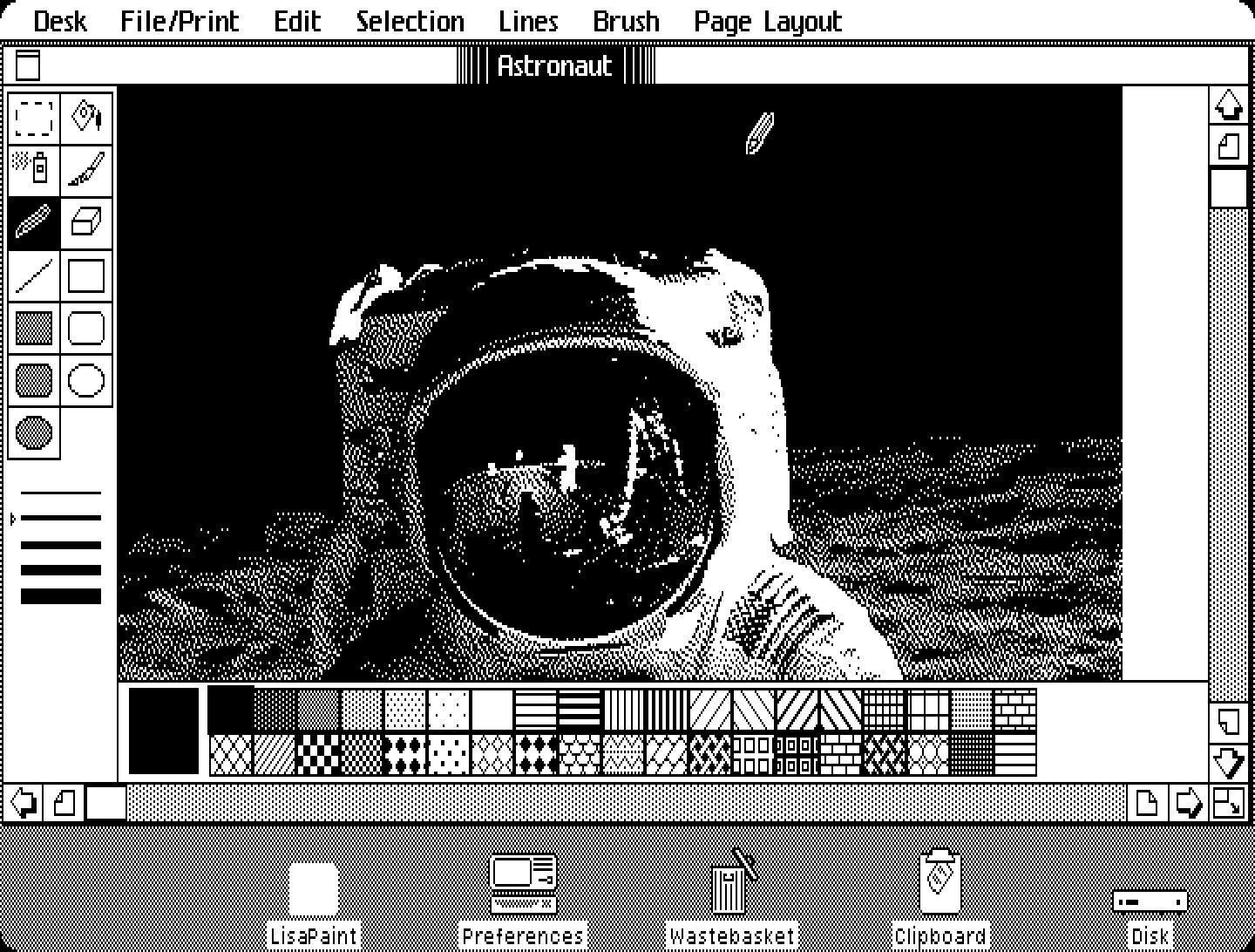

I also needed a demo application to test the C environment, and I've always felt that a "LisaPaint" was missing, so I created a simple first version.
You can find the code here: https://github.com/pappadf/lisa-paint
And you can try it out live here: https://pappadf.github.io/lisa-paint/

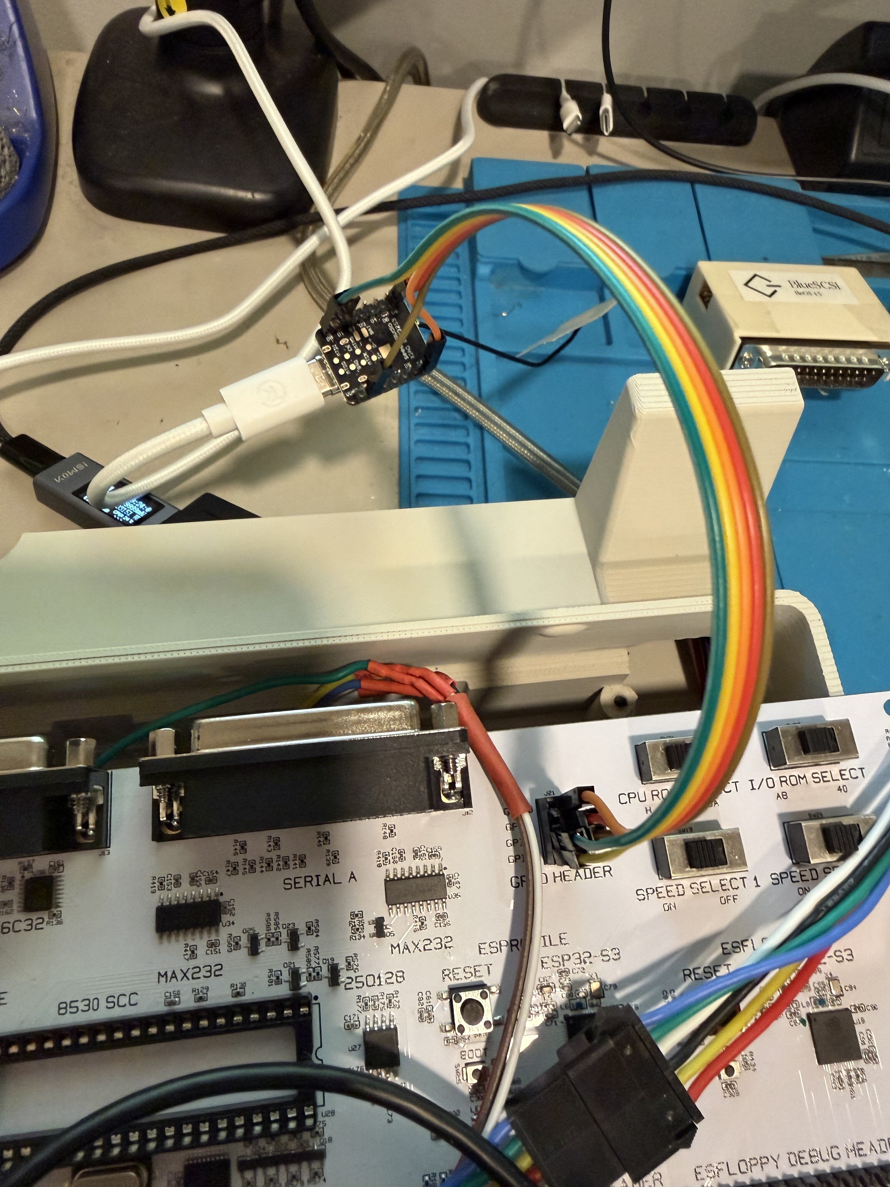

I’ve been looking for ways to add WiFi capabilities to the LisaFPGA I have set up in an all in one case that makes port access challenging. I was planning on slapping an ESP32 with WiFi onto its gpio pins and then having those communicate over the serial port to a custom app on the LisaFPGA side (probably written in Pascal).

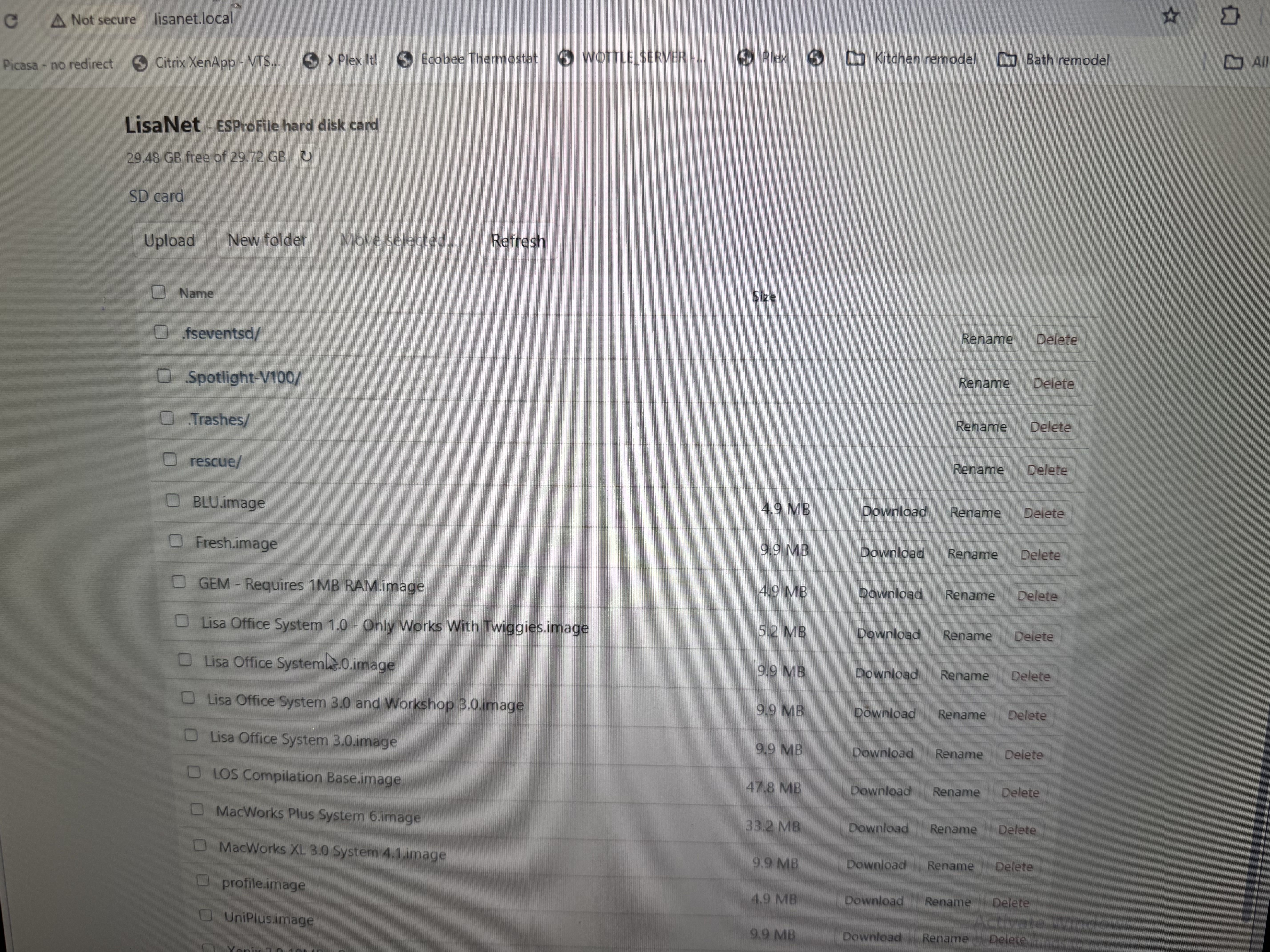

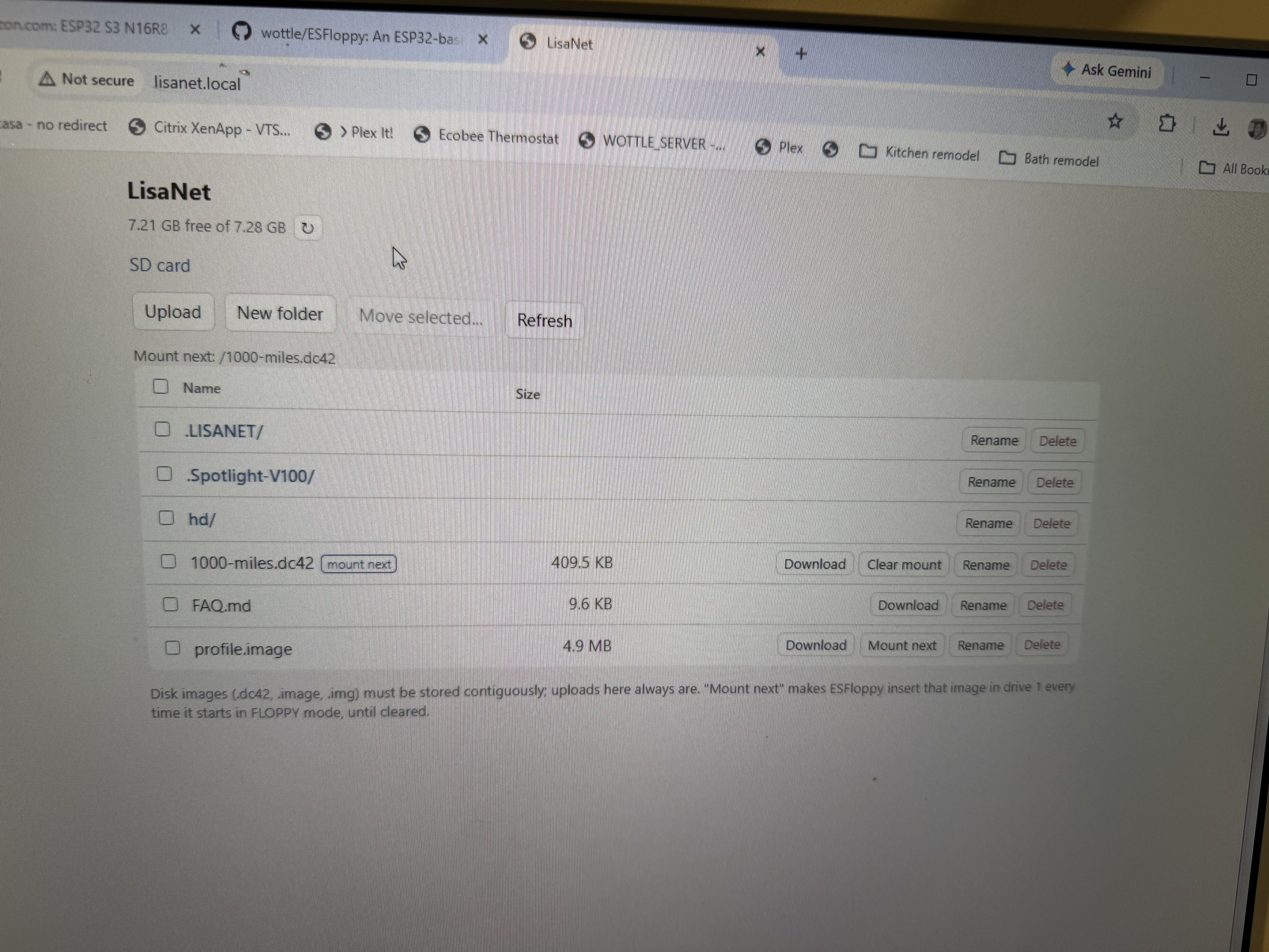

Yeah, for my needs, I think I'm going to go simpler. Just provide a simple wireless way to manage my ESFloppy and ESProfile images. I have it working with a tiny ESP32 S3 device and modified firmware for the ESFloppy and ESProfile.
