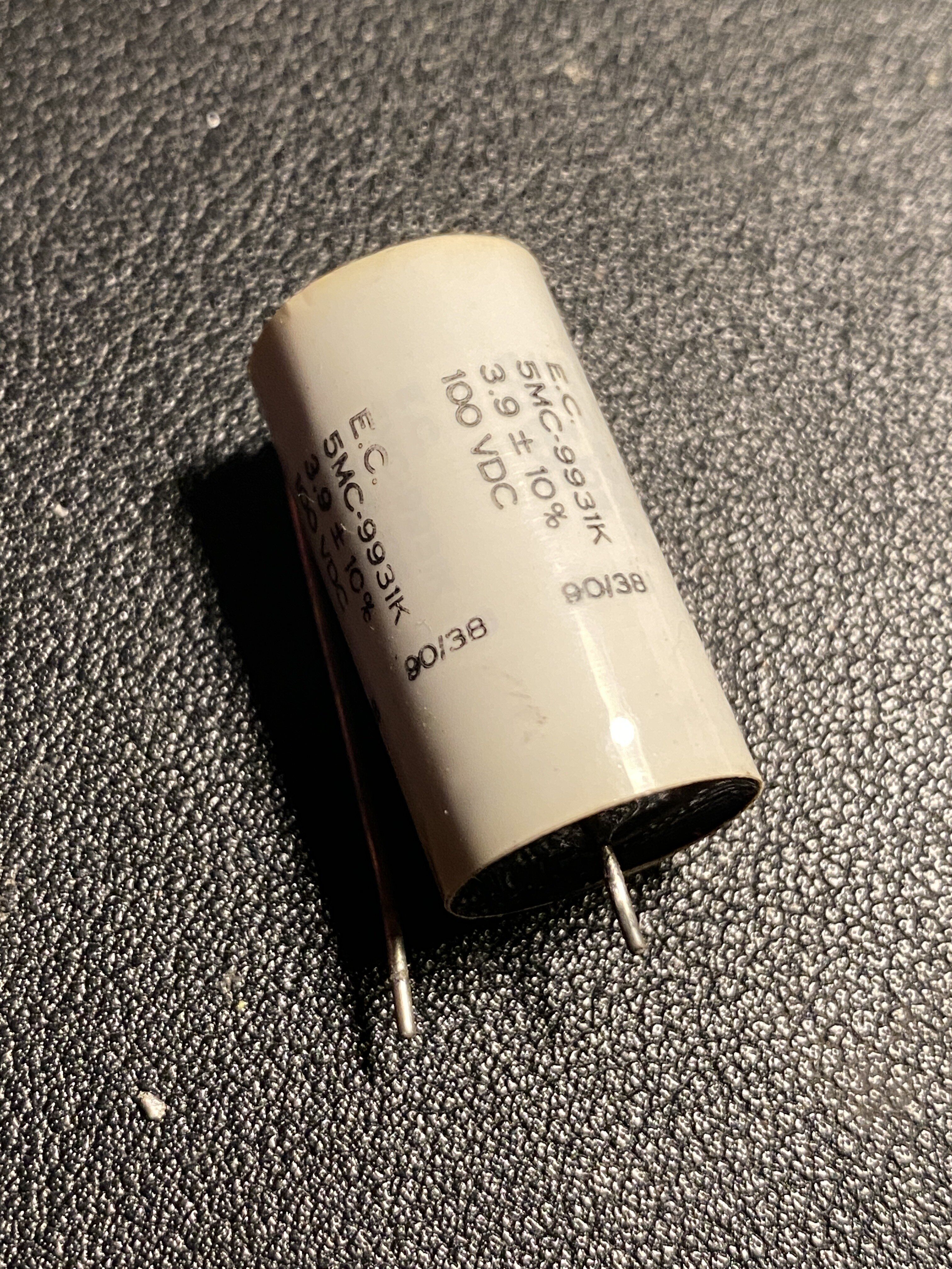

croissantking Tinkerer Feb 7, 2023 137 64 28 Nov 4, 2023 #1 I was just re-watching the excellent recapping guide by @JDW, on YouTube, for the SE & SE/30 analog board. On mine, C15 isn’t an electrolytic cap. Instead, it looks like this: Is it a film cap? It doesn’t need replacing, does it? Last edited: Nov 4, 2023 Reactions: JDW
S. Pupp Tinkerer Apr 2, 2023 95 51 18 Nov 4, 2023 #2 Correct - it does not need replacing. A couple of mine also came with a film capacitor instead of bipolar electrolytic. Last edited: Nov 5, 2023
JDW Administrator Staff member Founder Sep 2, 2021 2,862 2,227 113 55 Japan youtube.com Nov 4, 2023 #3 People who have boards with those white caps installed are lucky because they don't need changing. Too bad Apple didn't make all board using that particular cap!
