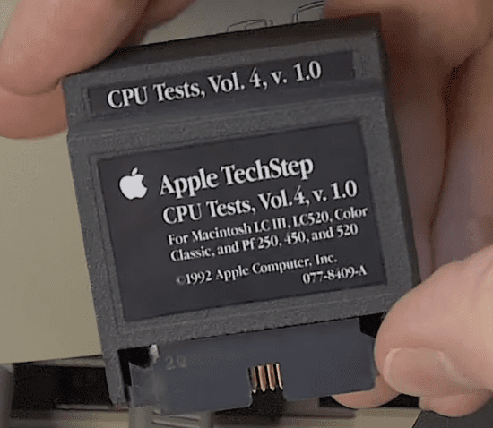

If you own a Color Classic with the stock motherboard and also have a TechStep along with the required Vol.4 Cartridge for testing the stock CC M.B., I've love to hear if you are able to perform all the tests.
I have the 84V 640x480 screen mod, which allows me to use the stock CC motherboard. However, I found I was not able to test my stock motherboard using a Vol.4 TechStep cartridge recreation. However, I also have the LC520 board and was able to use the same Vol.4 cartridge to diagnose that motherboard just fine, so I'm guessing it's probably not a bug in the cartridge recreation. It very well could be the existence of the 640x480 screen mod; but in order to find out, I need to call upon my fellow Color Classic and TechStep owners to do further testing.

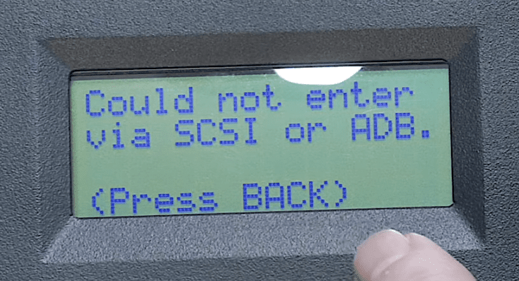

If it were serial port related, that still doesn't explain why accessing Test Mode via ADB and also SCSI didn't work in my case. If you skip to 40:57 in my video, you will see it says "could not enter TstMd via ADB." It then presents me with the option to access Test Mode via SCSI. I show myself attempting that, but it then says both methods of accessing Test Mode failed...

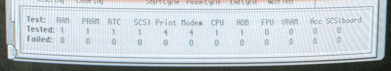

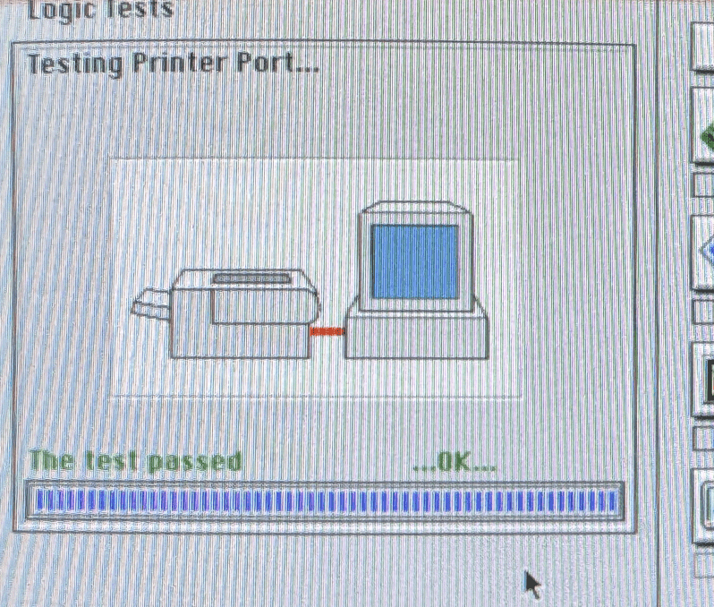

But here's the thing. I have two Serial Loopback Plugs, and Snooper 2.0 completes testing of the serial ports multiple times without error:
I tested that just now with the stock CC motherboard and of course 640x480 resolution via the 84v screen mod.

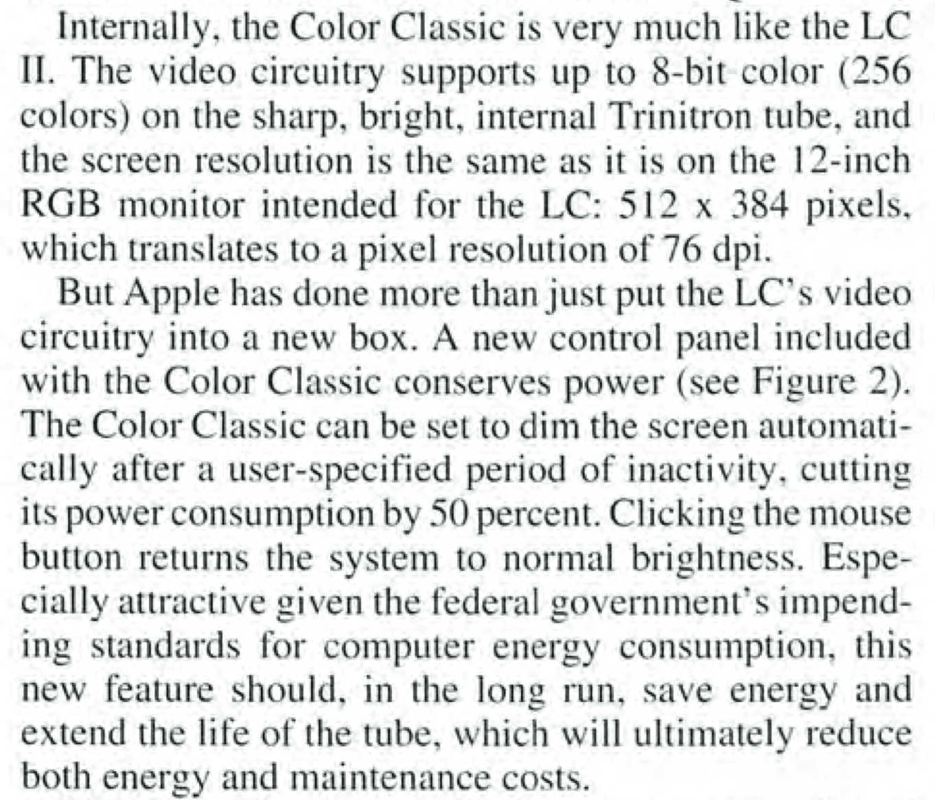

The stock CC is more like a Classic II or LC II
Indeed, and we see that in the April 1993 issue of MacUser magazine (which I subscribed to back in the day, and which later was rolled into Macworld, the digital version I still subscribe to today)...
And of course the same painful limitation...
And performance...

I did use an original TechStep, but I'm not sure where my original Vol. 4 cartridge is so I just built a new one yesterday. There shouldn't be much difference between the cartridges though, there isn't much going on in there.

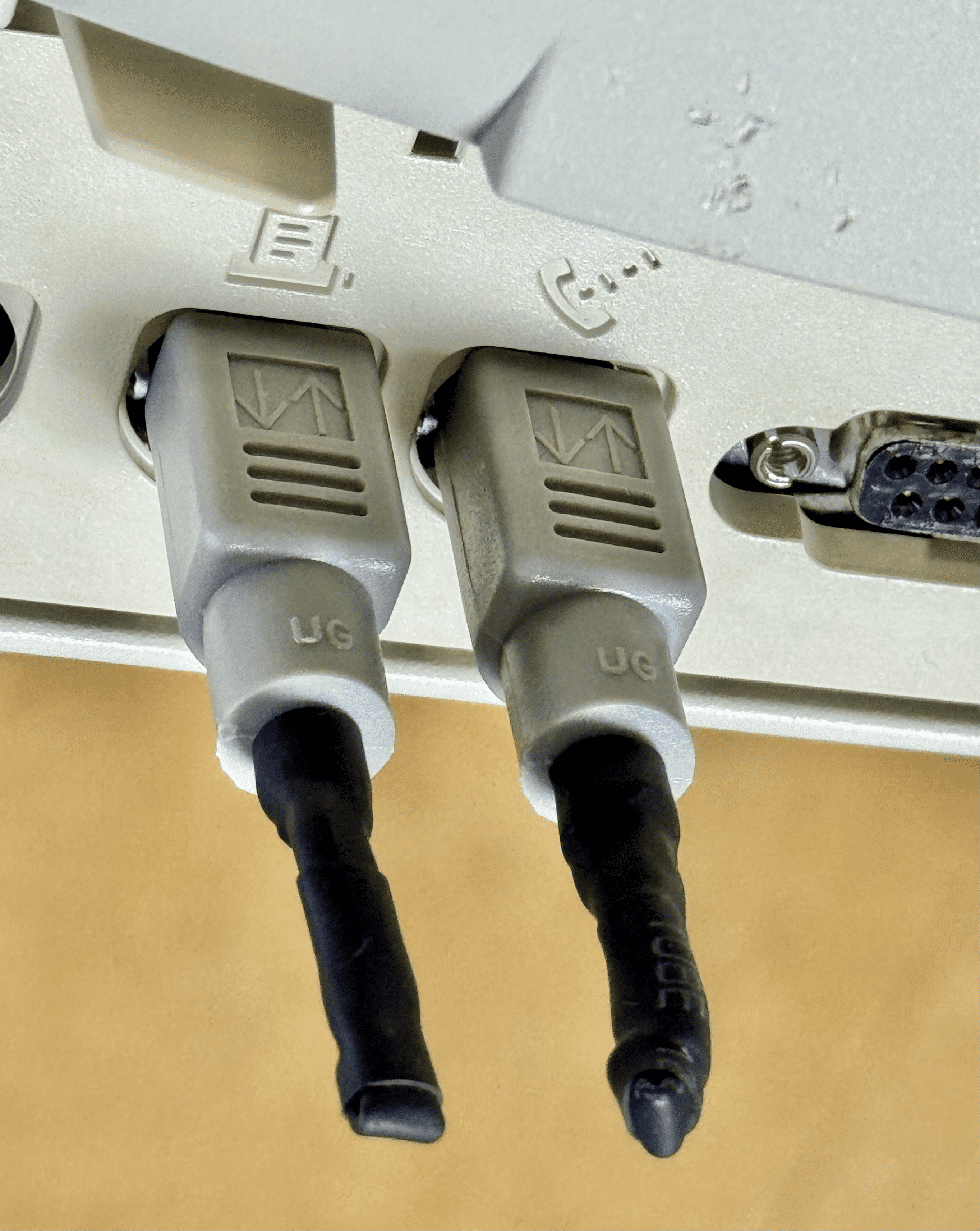

I have a stock CC and a TechStep replica. At first, it didn‘t want to enter test mode, but I had just one ADB cable attached. When I tried with two ADB cables, it worked with no issues. All logic tests passed.
Thank you very much for testing and reporting back!
So, we now have 2 people thus far with the stock resolution and with a TechStep replica cartridge Vol.4 (whether a removal one or one inside the memory of the Replica TechStep shouldn’t matter), and both gentlemen can diagnose the stock CC MB just fine when using two ADB cables.
