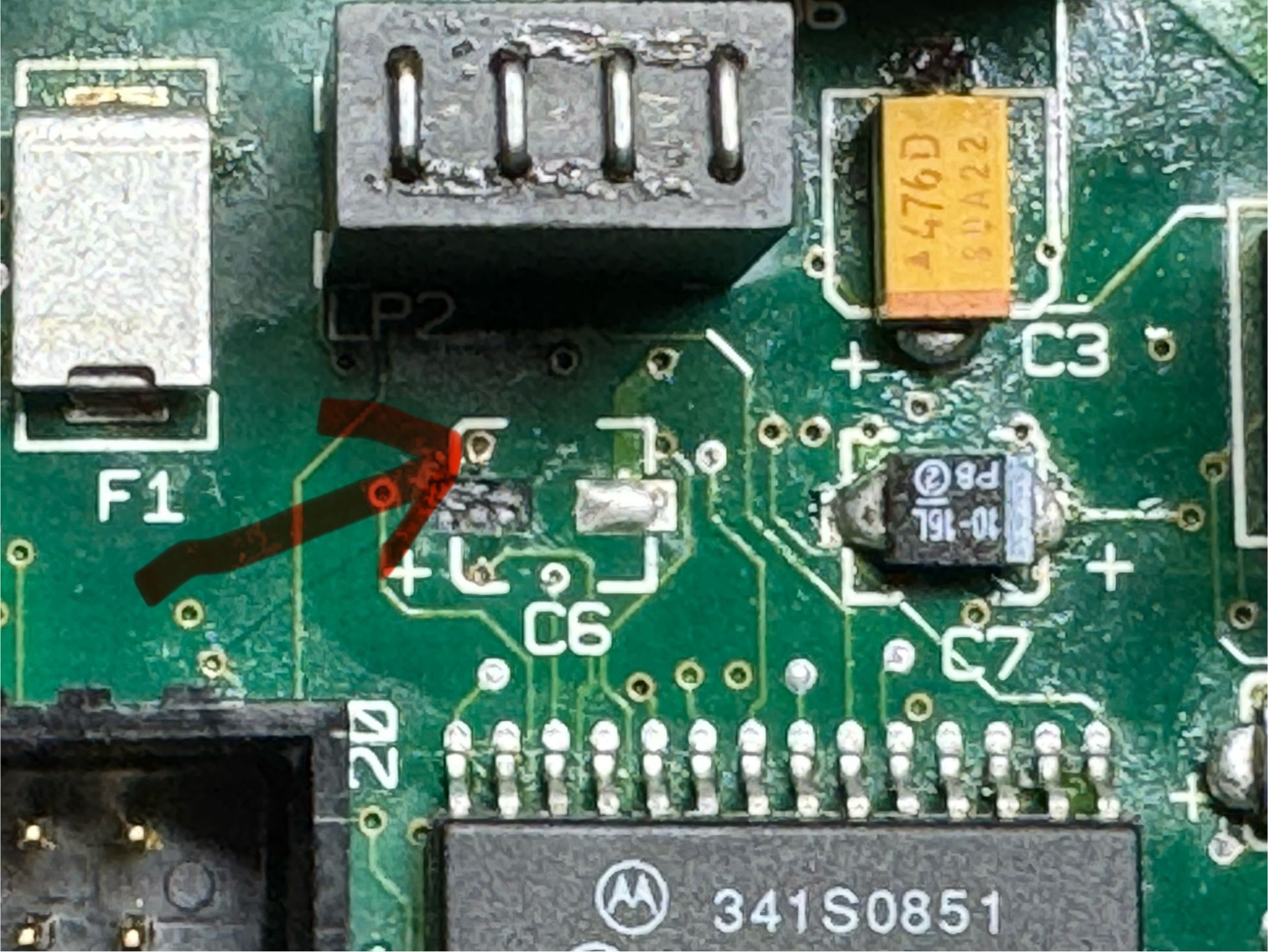

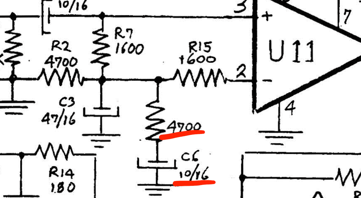

The + pad of the C6 capacitor came off. I checked the logic board schematics and noticed it would connect to a resistor. However, that resistor does not have a lable. Does anyone know where the pad would connect to?

I don't have a Classic II board handy, but looking at some photos it appears that the positive pad for C6 hits a nearby via and likely connects to a SMD resistor on the bottom of the board.
Thanks both for your responses. I might have found it. It’s R6 and the via connecting to it is just above the defective cap‘s pad.
