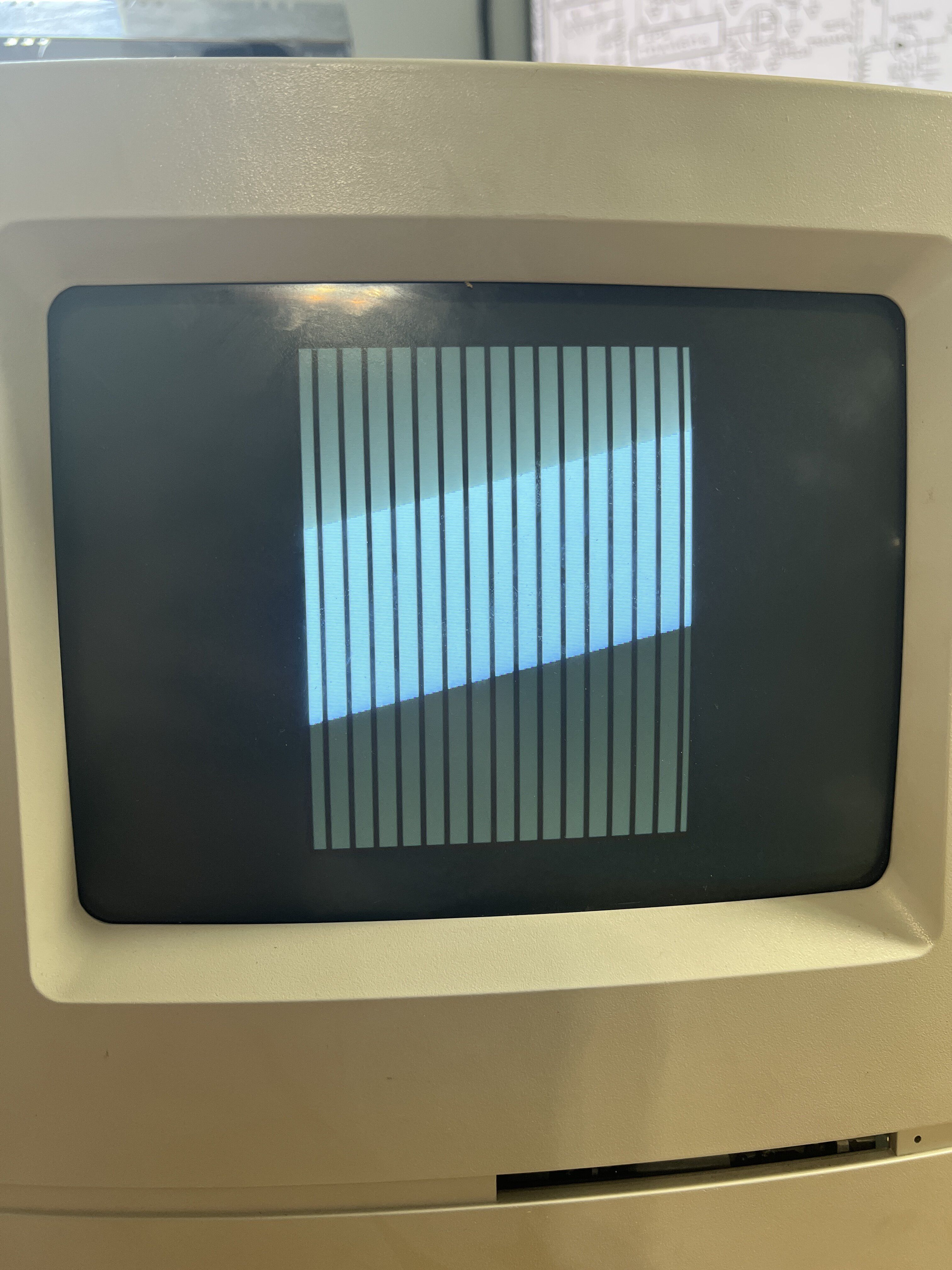

I solved the power issue by changing the opto chip. But now I have a tight vertical bars issue and this after a full recap of both boards. Anyone have ideas?
