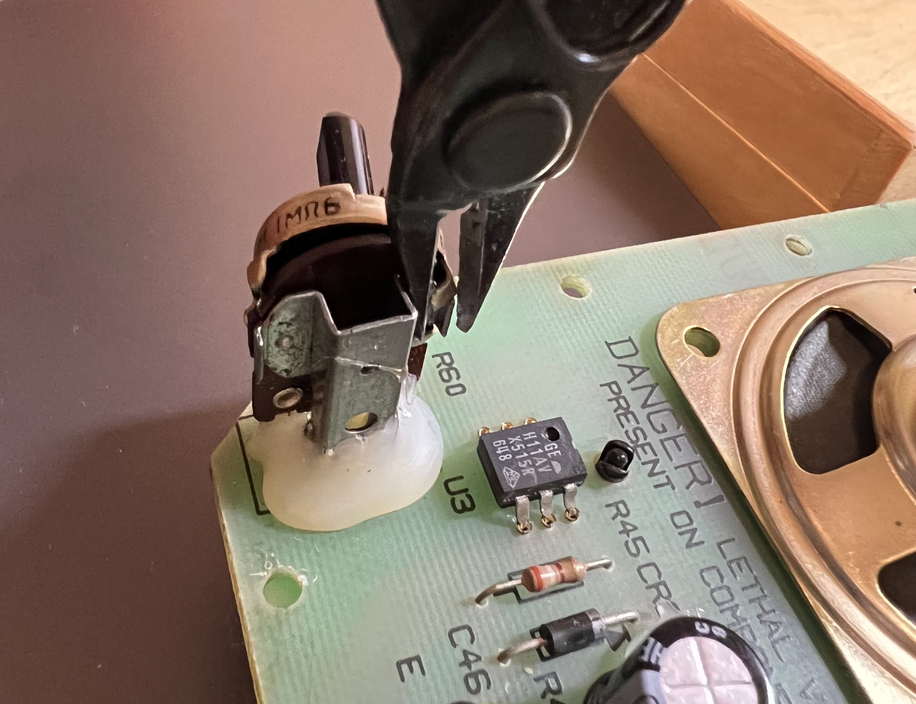

No desoldering is required! Use a pair of wire cutters or similar to bend open the four tabs keeping the housing closed.

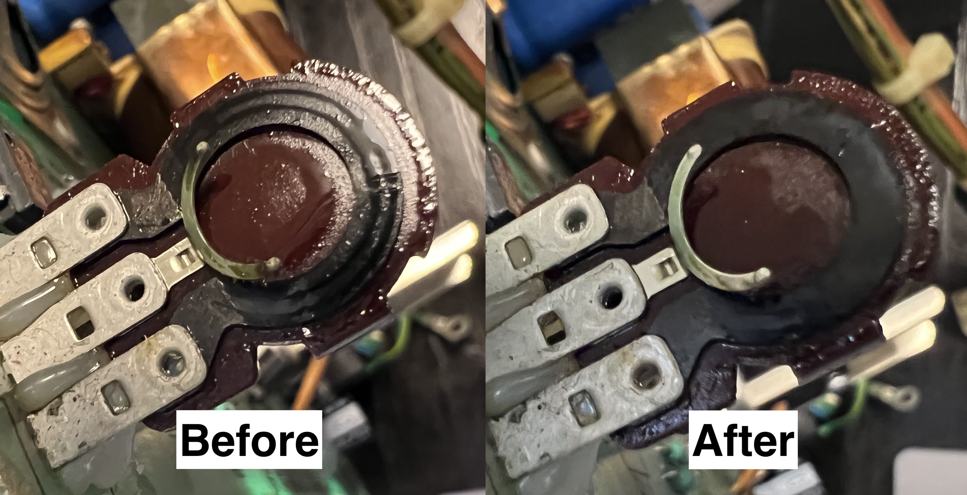

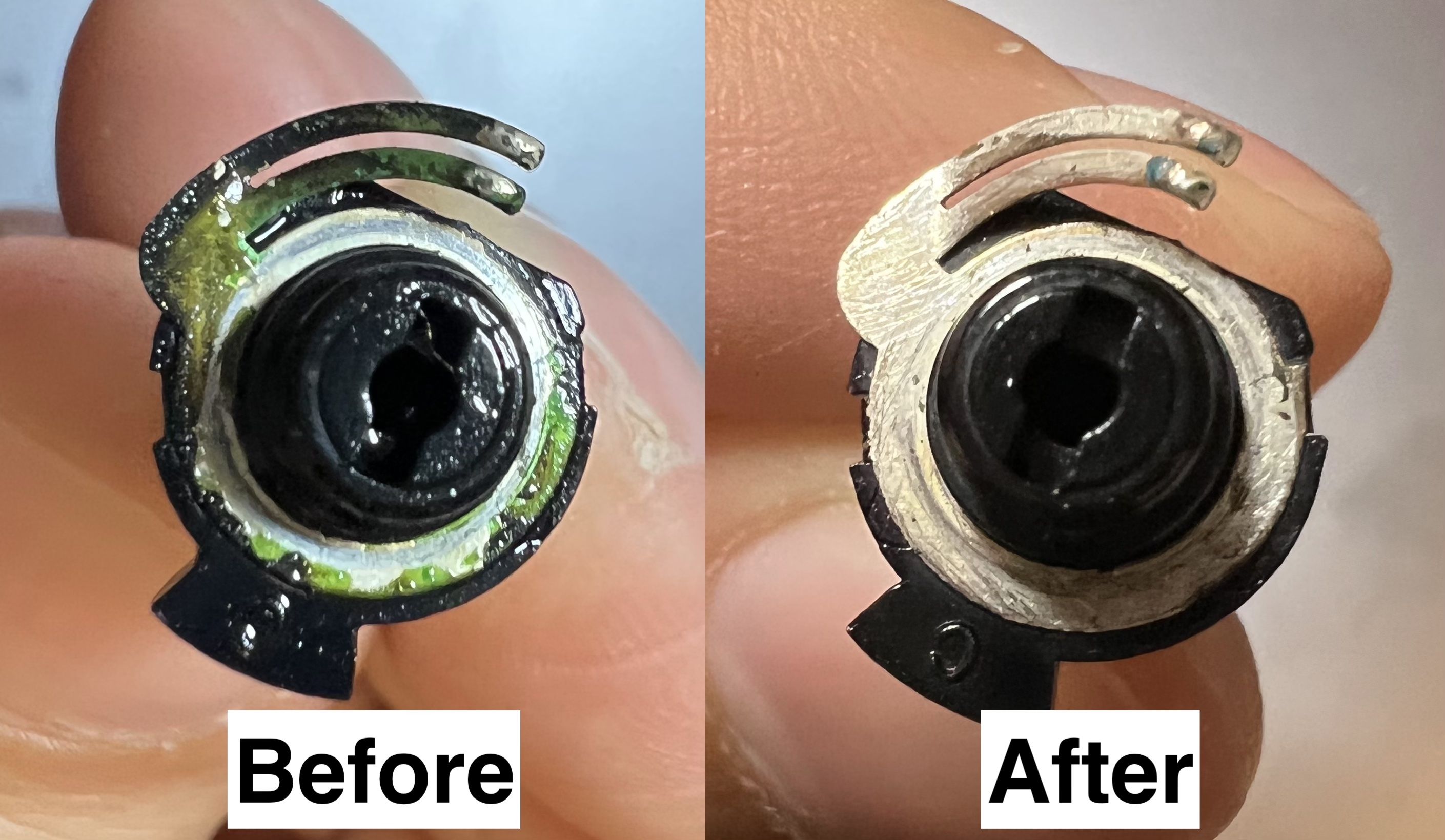

Clean off the metal contacts on the knob. Use IPA to clean the old grease, then use an exacto knife to scrape off any of the gunk and corrosion build up that doesn't wash off.
On the mounted part to the logic board, clean off the carbon track using IPA. Scape off any gunk on the metal contacts.

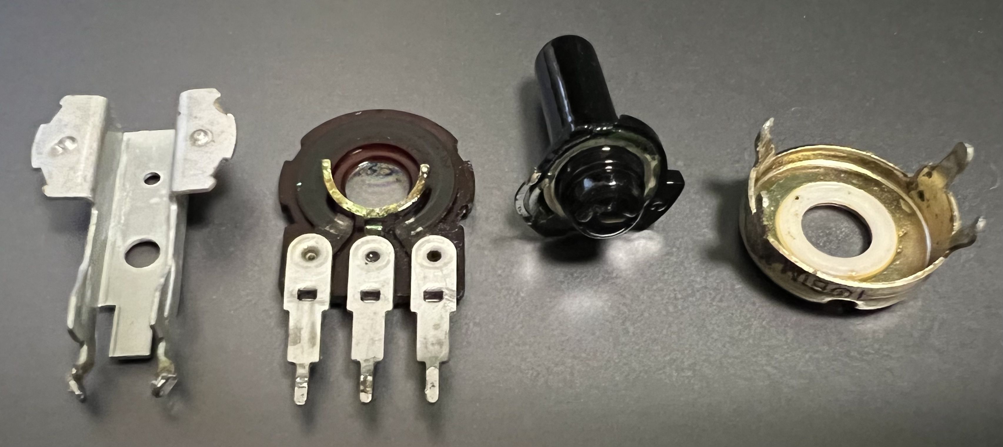

Here's a picture of all the components. When I did my first one, I didn't know I didn't have to desolder it from the board.
Before Fix:
After Fix:
