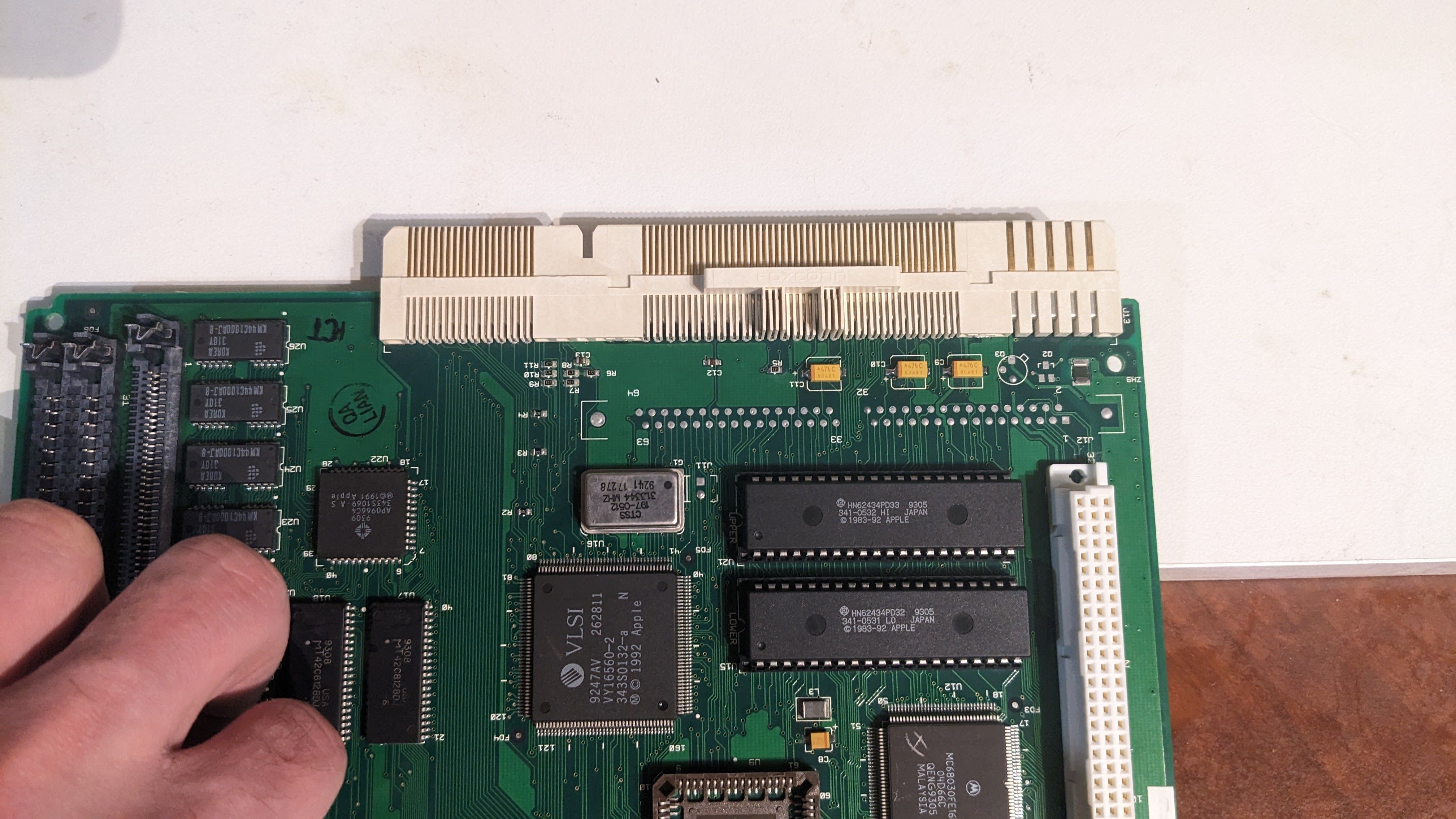

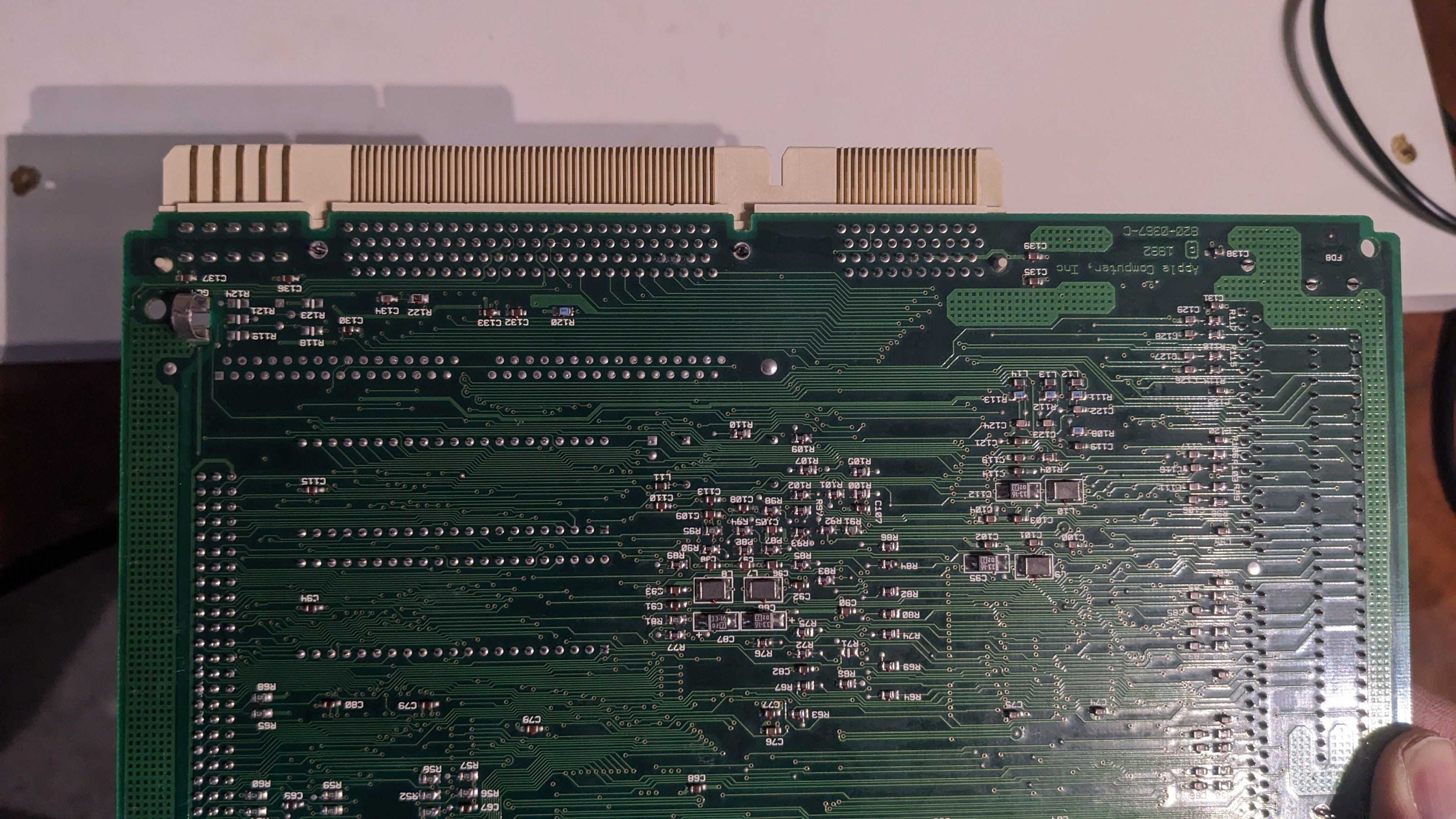

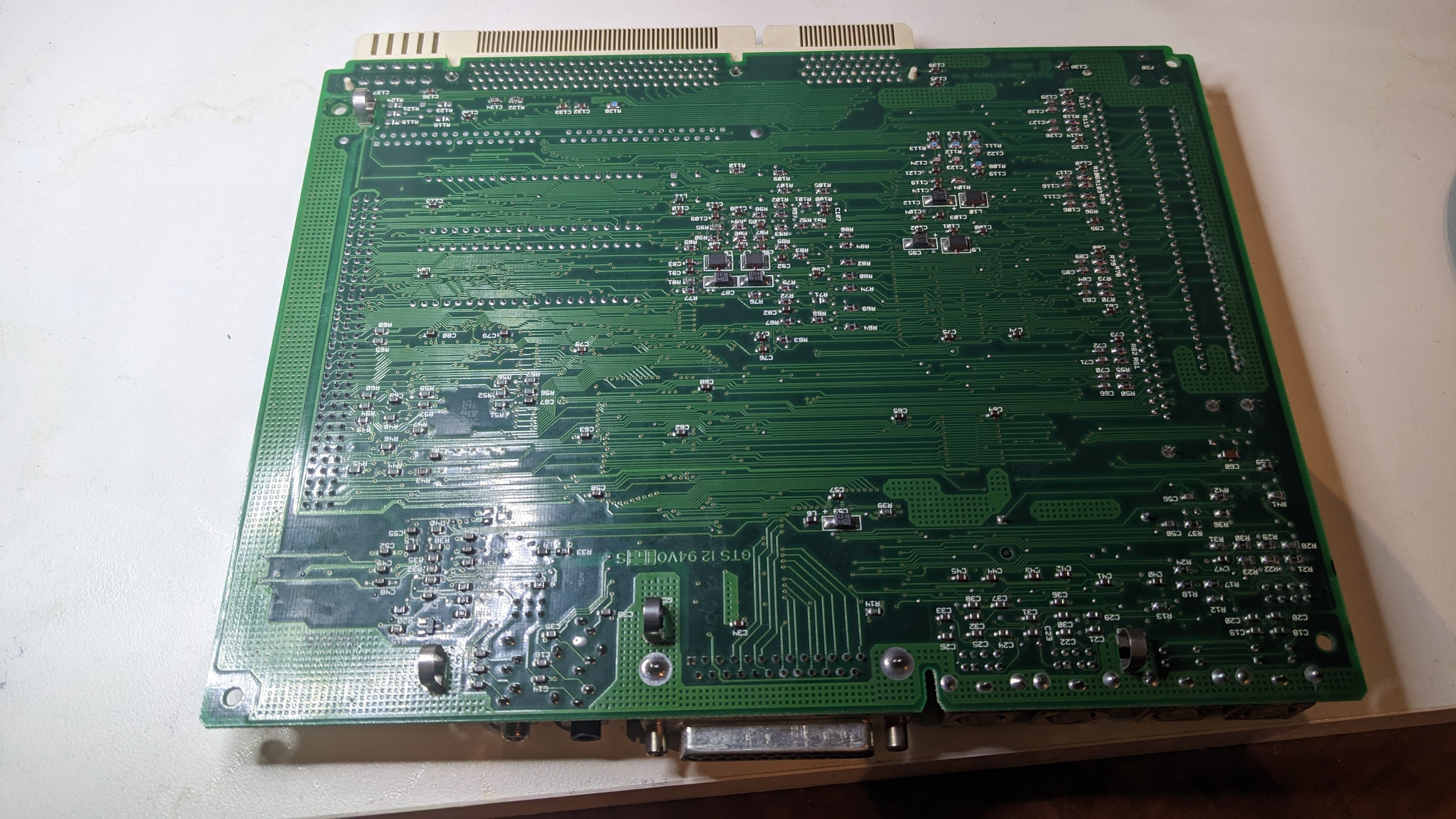

I don't have any real magnification I'm afraid beyond a simple digital magnifier but I don't think the edge connector on this board has any issue. It looks intact.

How well did you clean up the EGRET? In my experience cap goo around that IC will prevent boot. In some cases scrubbing with a brush and IPA will work, but in others I've had to remove the chip, clean underneath and then solder it back on. Good luck!
