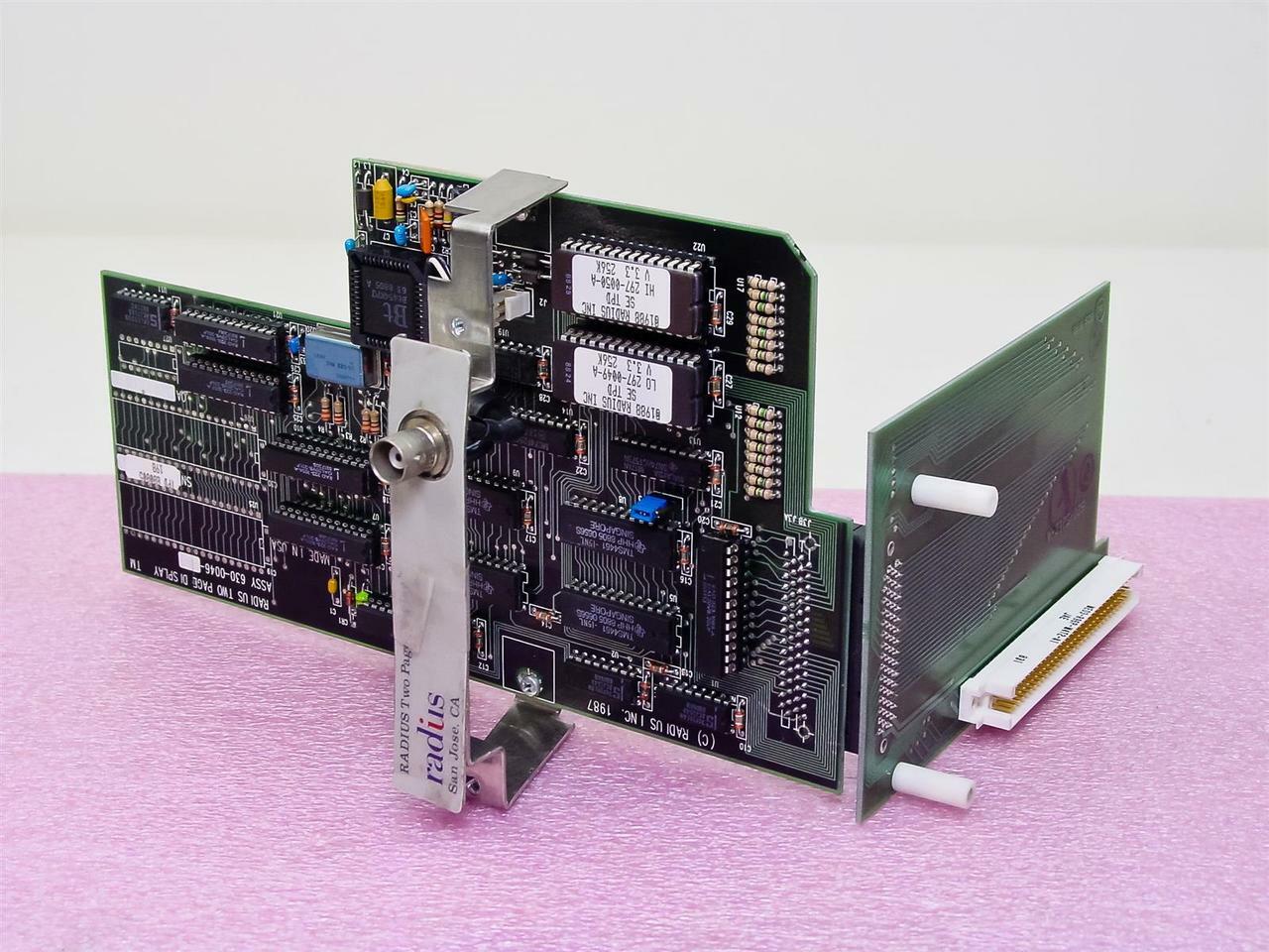

I just received my new toy a RADIUS Two Page Display for Macintosh SE.
Together with the RADIUS MagicBus PDS board and the main board with the BNC connection pig-tale with the metal frame to fix it into the Macintosh SE.
So to say the setup is complete.
radius-two-page-display-for-maciintosh-m5010-se-820-0008-a-1.35__33508.1489970681.jpg
Only thing is missing the RADUIS Two Page Display Monitor.
I am thinking to create some adapter board, to "mimic" the mono-color RADIUS Monitor, and able to connect some modern CRT to the RADIUS card,
but I did not find any information about the signal what the RADIUS TPD card is generating.
As I know that is HSync + VSync + Picture together.
Do you think some BNC to VGA from the CCTV techs. could work? Does any of you have some documentation about the RADIUS Two Page Display card and the monitor too?
(Pictures are from the Internet, my card is exactly the same)
