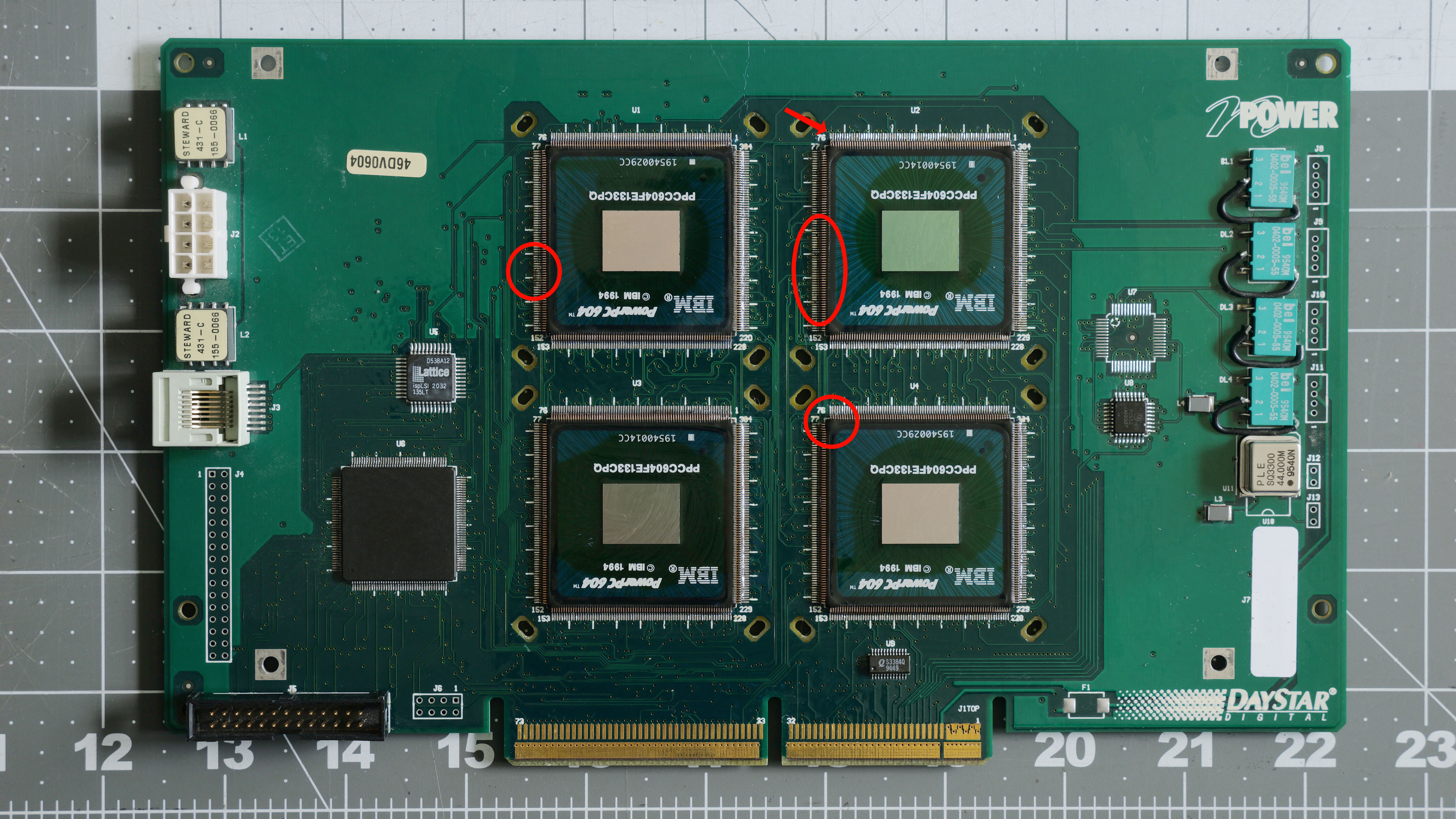

There's no info I can find about the card itself in terms of schematics. The heatsink puts a decent amount of pressure on the PCB, enough that the PCB flexes a bit, so my initial suspicion was that perhaps there were some loose solder joints between the CPU legs and the board. I reflowed all of them, but no change. Very briefly (less than 10 seconds) running the card without the heatsink let me find with an IR thermometer that the CPU at position U2 gets much warmer than the others. But I don't know if that's indicative of a short, or if that's normal since the classic Mac OS only uses one CPU unless application software is MP-aware.

So here's a super mahoosive photo of the card without the heatsink. The shiny parts around the CPU legs are flux residue, not solder bridges -- I inspected the card under the microscope for those.

Pin 76 of U2 looks like it may be bridged to its neighbor.
The circled areas have some pins that look tarnished.
Have you already checked those areas closely?

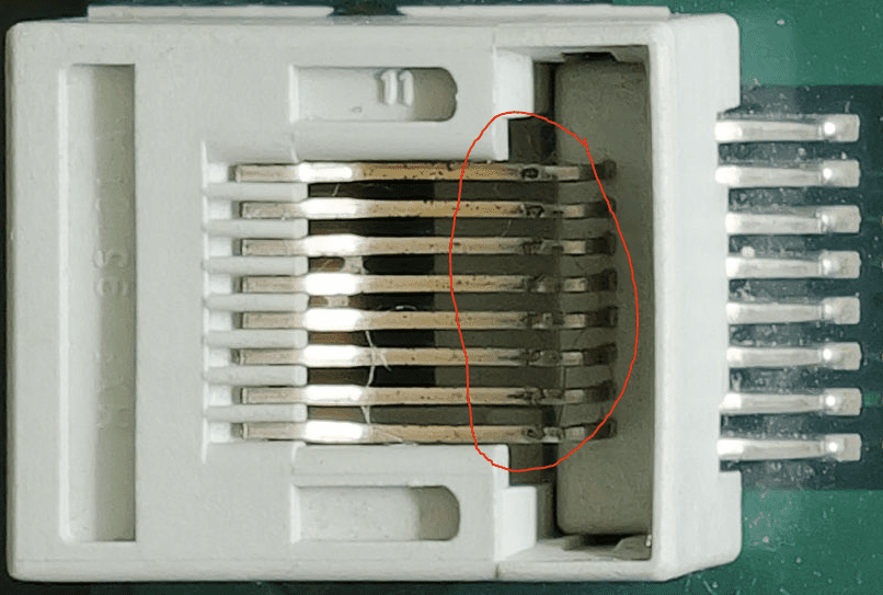

Is there corrosion on the inner contacts of J3? Or is that just a reflection? Is J3 connected to anything when the board is installed?
No shorts on any of the pins -- I examined them all under the microscope. Dark spots are just some flux residue, which I've cleaned up.
Looks like it might be a little tarnished, but nothing connects to it (or the pin header next to the card edge connector) from the system. I think it's probably only used for testing/debug during manufacturing.
