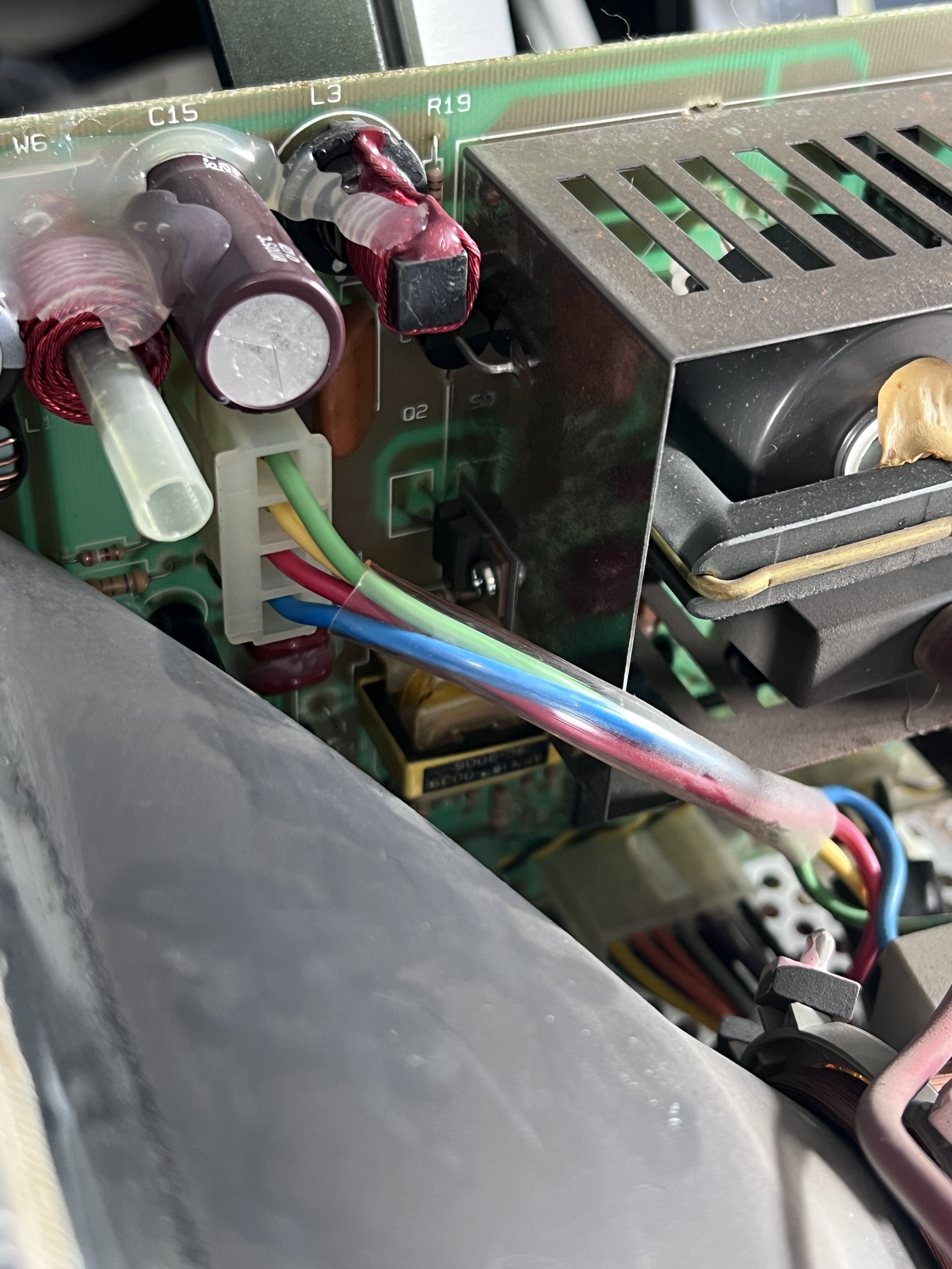

Hi folks, would anyone know how else I can troubleshoot my SE/30? Everything appears fine (normal chime and HD sounds like its booting up, caps lock responds) but theres no glow to the CRT, it looks completely dead. I tested the voltage on the 4 wires that go from the analog board to the CRT sleeve and its as follows:
Green = about 68v
Yellow = about 3.5v
red = 5v
blue = 5v
Haven't tested the flyback transformer cause I don't know how.
Any tips would be greatly appreciated. Thanks!
