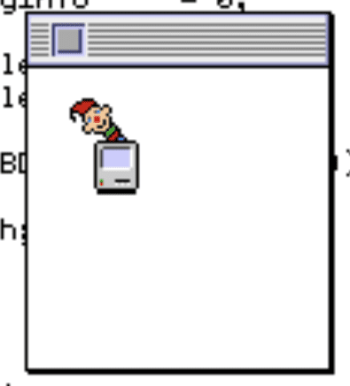

For the case when the screen is set to a color mode but I'm trying to get an app's icon using the PlotIconMethod(...,IconGetter,..) methodology - It will call IconGetter twice (as discussed in my recent wave of posts), once for the B&W+mask and once for the OS-determined icon type that needs to be requested for the bit depth of the screen.
Well - in the case where a app only has a b&w icon, and your screen is color, the first IconGetter() call is fine and then PlotIconMethod still calls IconGetter() a second time, now requesting the color icon. So now your IconGetter() function knows it failed, but you don't have a way to communicate this up to the calling function (from the PlotIconMethod side), so PlotIconMethod still plots the data.... which is junk because it never found any color data.
First I got around this by adding logic to my existing structures that basically can track the result of the PBDTGeticon(..) function for each call (the b&w+mask call and the subsequent color call) and if the color call failed but the b&2 call succeeded then I just plot the B&W handle data manually over the garbled mess PlotIconMethod plotted... However - there is a more generic and automatic way to do this. If you return nil; for the IconGetter call that fails to get color icon data, then PlotIconMethod automatically just plots the B&W icon!
