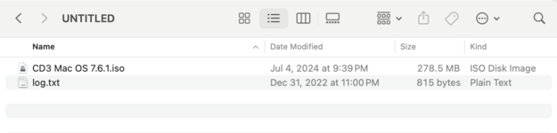

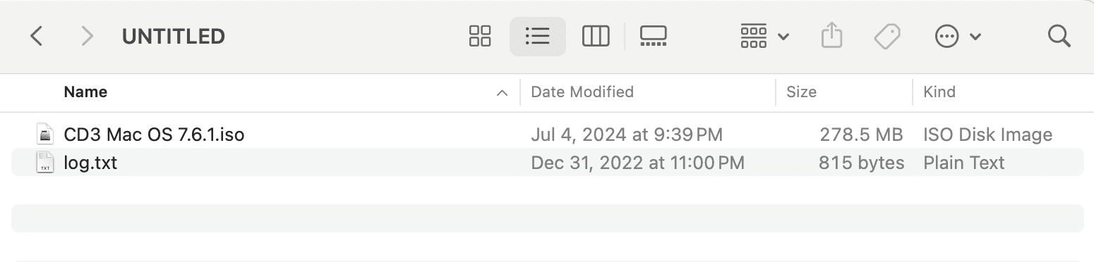

1: I bought a pre-built BlueSCSI device and 4GB micro SD card.
2: I formatted the card, using my Apple silicon laptop, to FAT32.
3: I downloaded and (probably incorrectly) copied over a disk image I found online and (possibly incorrectly) named it “CD3 Mac OS 7.6.1.iso”.

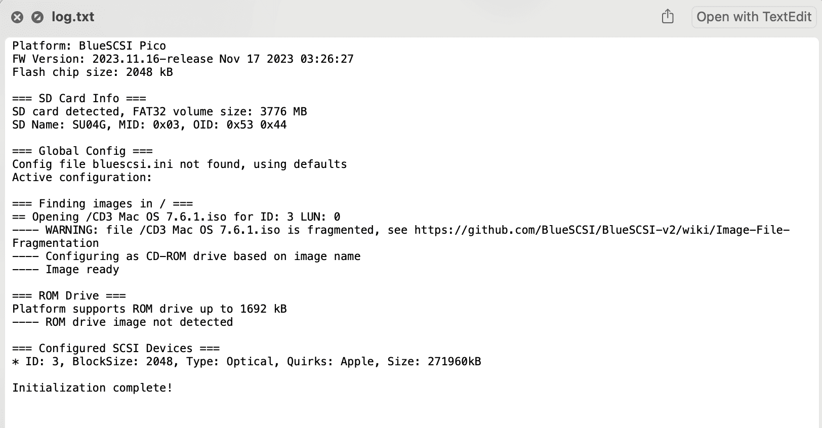

The log.txt file identifies some issues. I’m not that technical so I don't understand them.
No, you go this right - log looks fine. The log gives a link to the explanation of the warning and what you could do about it (but you can ignore it too as it is just a warning)
