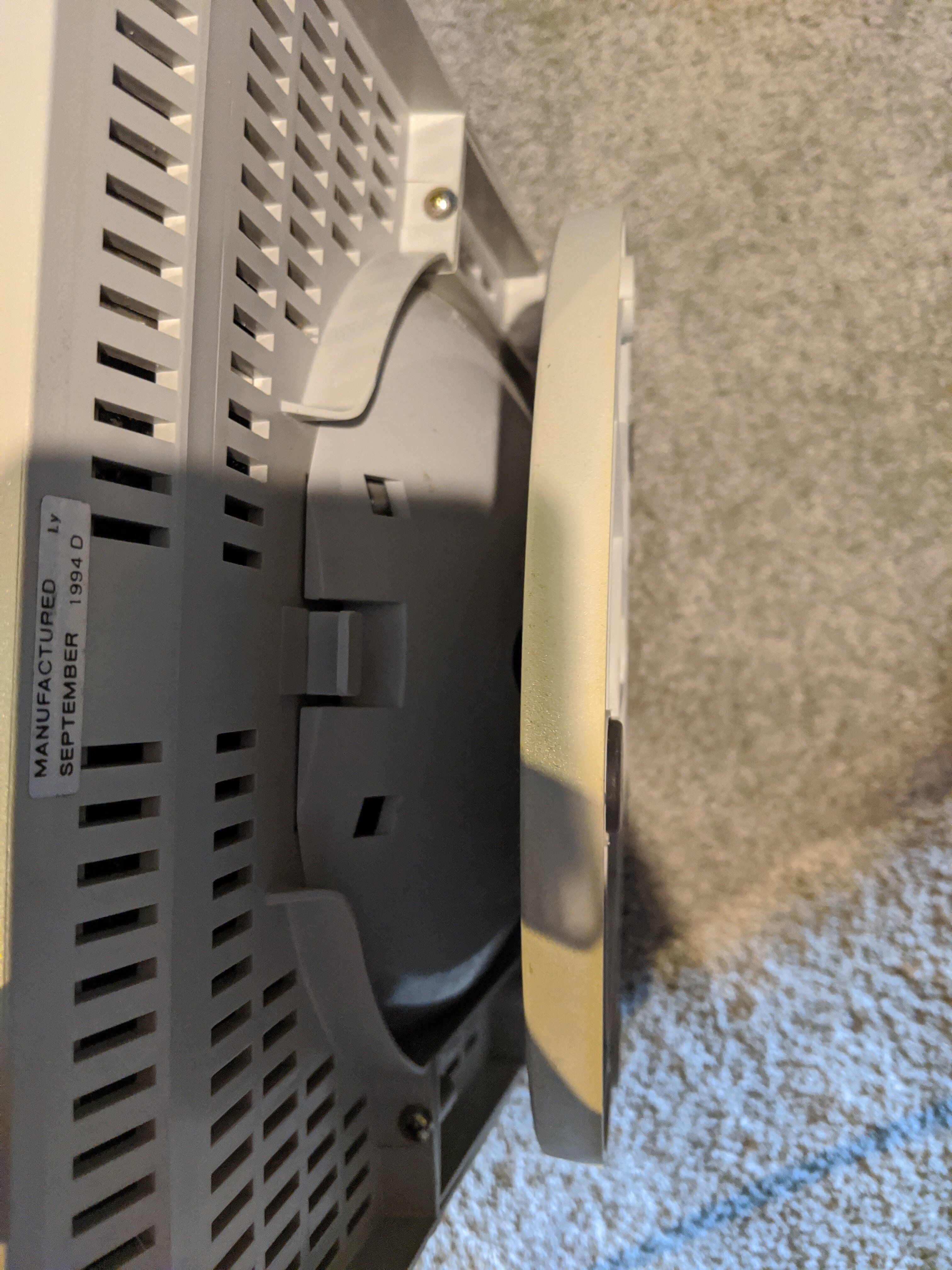

The back cover comes off with two screws and two tabs
Here you can see how they are released and there was a tab under the base.

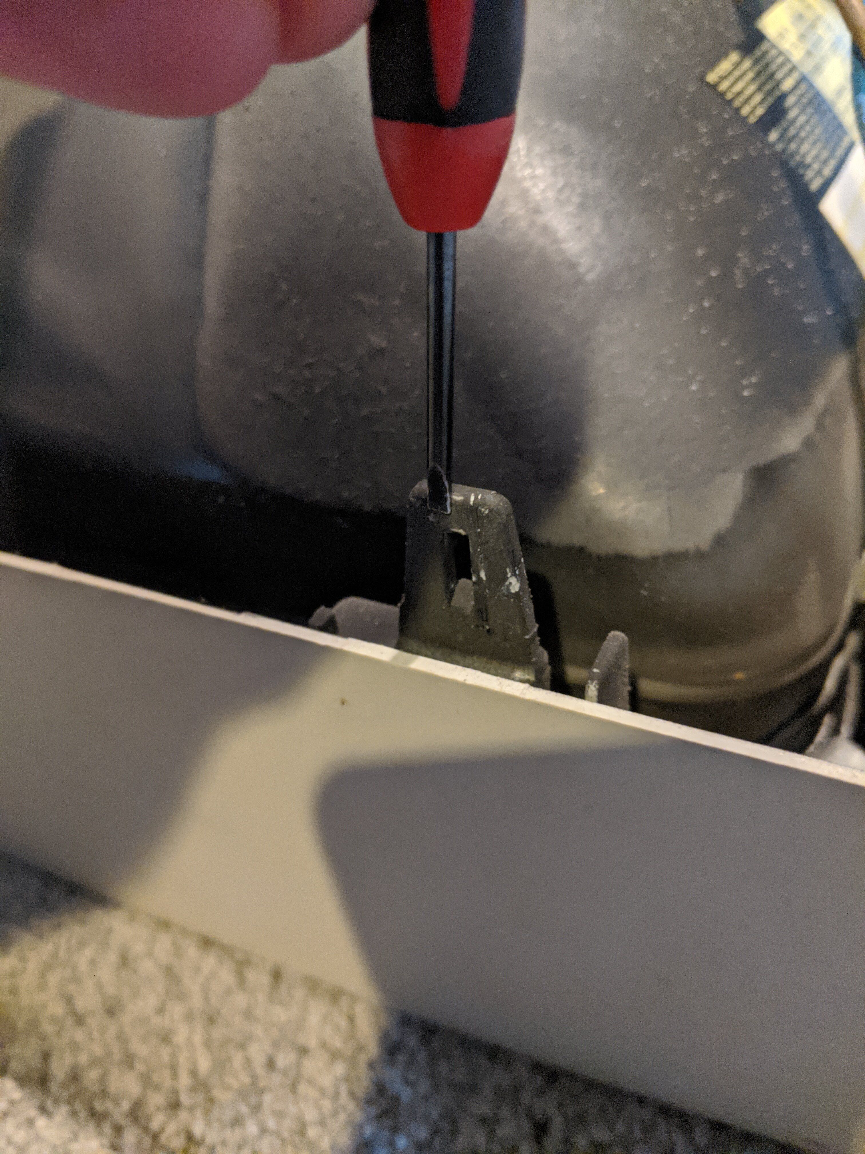

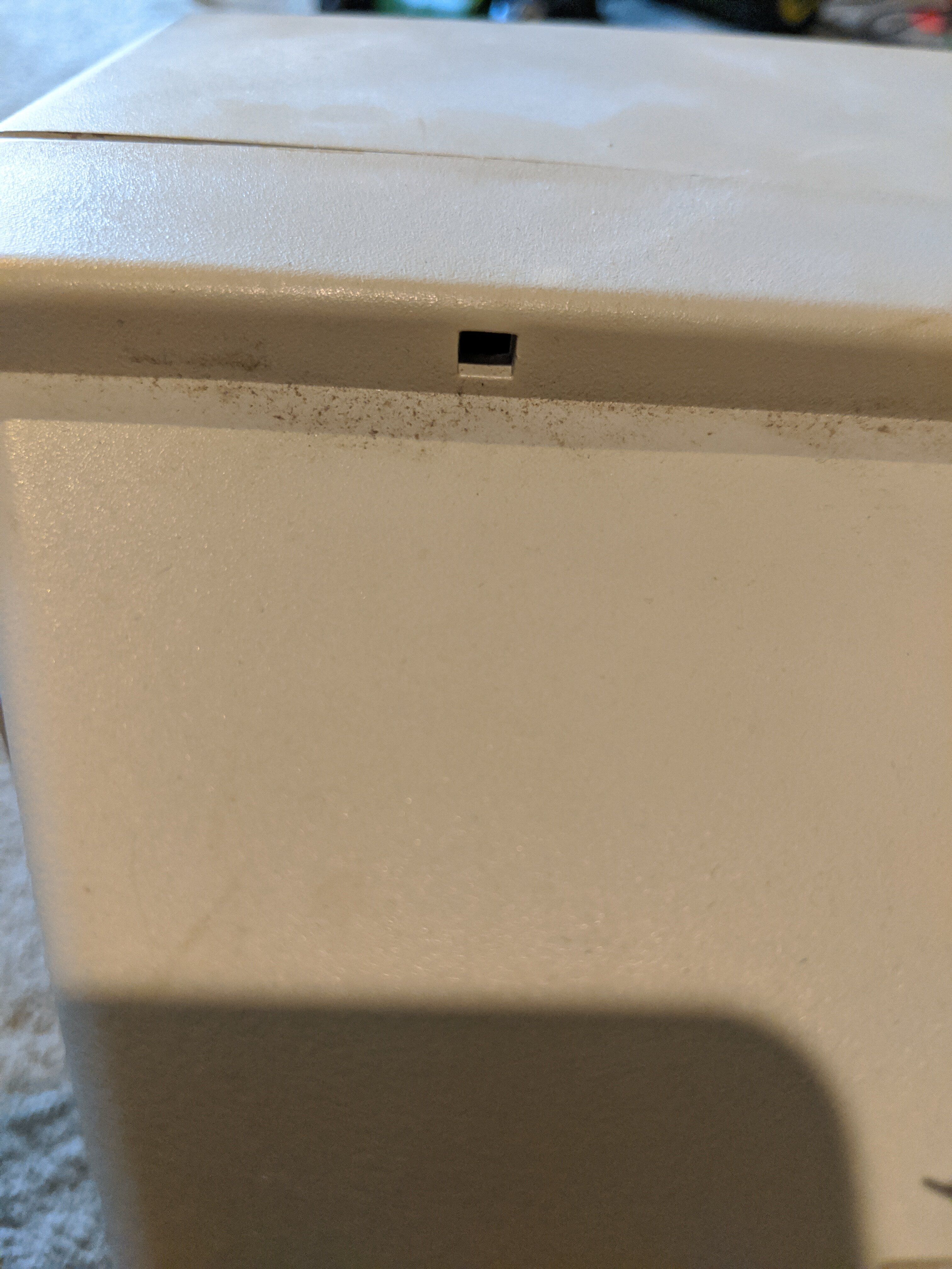

The top inside latches are tricky and brittle - I was able to open open without issue, another they broke at the slightest touch.
The board slides out with just releasing the clip on the bottom, you'll need to detach the yoke and go slowly, detaching any wires such as the speakers that are attached to the outer case.
