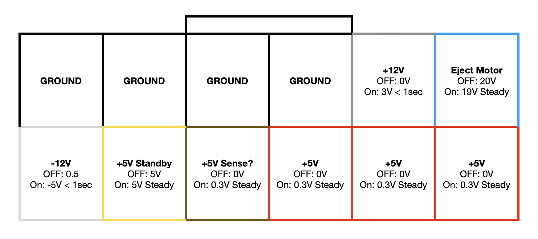

I have a Duo Dock that works okay with a known good PSU, but it's own PSU isn't working correctly.
It has been recapped, but still just gets a faint tick when the power button is pushed. The eject mechanism works okay.
5V for the eject button and ~20V for the eject motor work okay.

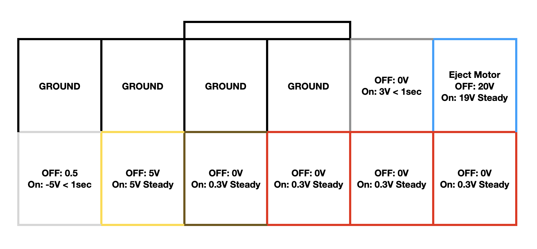

The power button does enable a steady on/off state, but the +12V/-12V rails shut down in less than a second and the +5V rail stays at a steady 0.3V. The eject motor +20V and +5V rails work okay and are unaffected when the power button is pressed.
I already double checked the caps and spot checked the D5 shottkey and main transistors as well as a few easy to get to diodes. But I'm hoping someone can help me think through this strategically.
Primary must be fine since the eject motor rails are working. So something is likely wrong on the secondary that handles 12V, but what would be best to check? Maybe something is wrong with the optocoupler? A zener somewhere?
I'd greatly appreciate any help!
