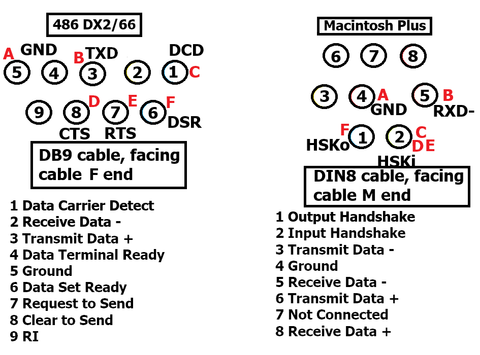

I bought a cable on ebay blindly, it was cheap, and the wiring doesn't look promising. this is the diagram of how the pins are linked together on both ends of the cable
I think a potential solution is:
cable 1: Mac DIN8 male to DB25 male regular printer cable
cable 2: PC DB9 female to DB25 female null modem cable <- not easy to find
or perhaps
cable 2: PC DB9 female to DB9 male null modem cable
dongle 1: DB9 female to DB25 femal
I definitely need help from people more knowledgeable about these null-modem solution, bonus points if you've done cross platform connections with RS422 and RS232!

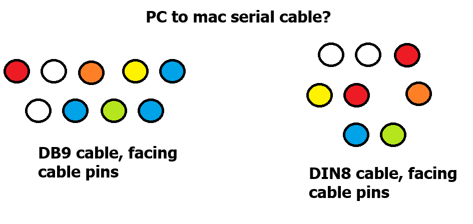

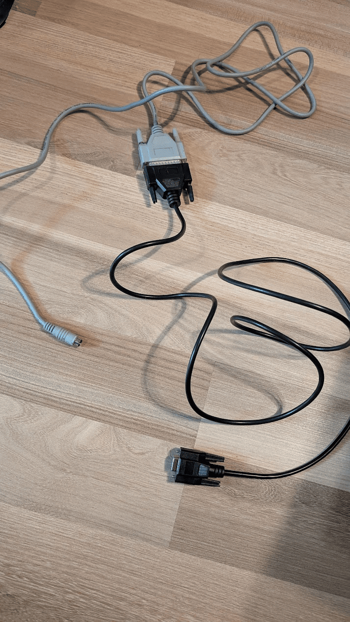

I received my 2 cables in the mail:
Here's how the continuity works out between the 2 ends of that 2 cable chain:
Again, doesn't look perfect!
I went ahead and tried it:
