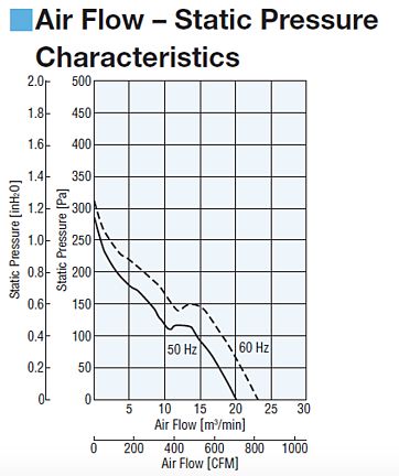

Here's a graph for those like me who prefer visual, tactile learning.
You can see that with a very high static pressure of 200pa, airflow is very low around 4 cfm. Conversely, a really low static pressure of say 50pa at 50hz, has a comparatively very high airflow at around 18cfm. This shows how a fan with low Pa ratings will become inefficient more quickly and heat up your box & componentry faster than a higher Pa spec'd fan. Anyhow, hope this helps understanding the importance of Static pressure ratings, what they mean and how they work so you can make the best choices for your stuff. Best of luck to you.
