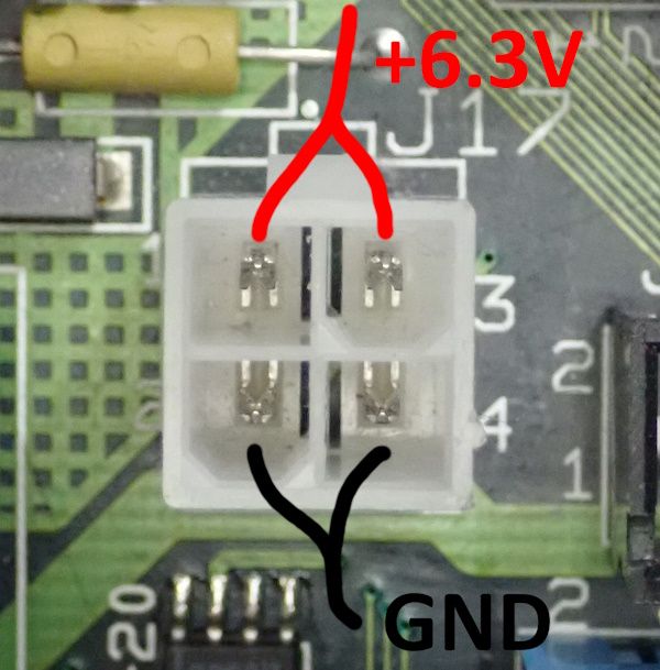

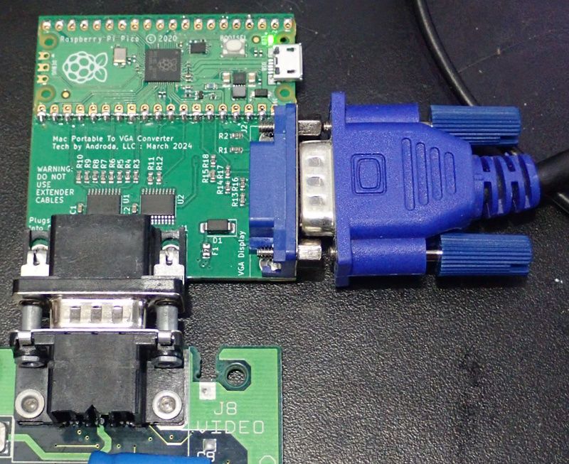

For bench testing, I used a proprietary VGA adapter created by @Androda and sold by Joe's computer museum:
Read the warnings on that page. ABSOLUTELY DO NOT CONNECT A VGA CABLE DIRECTLY TO THE BACK OF THE PORTABLE ITSELF. Also, while you're at Joe's computer museum, buy the BlueSCSI Portable Adapter and (if you own a 5120) a Hybrid module.
The adapter rules out issues with the Portable LCD screen and it is easier to work with a freestanding modern display, rather than propping up the panel. If you see nothing coming out of the VGA adapter, it is possible that this portion of the Portable is damaged. In that case, try the Portable's LCD screen to be sure.

FIRST BOARD (Impossible)

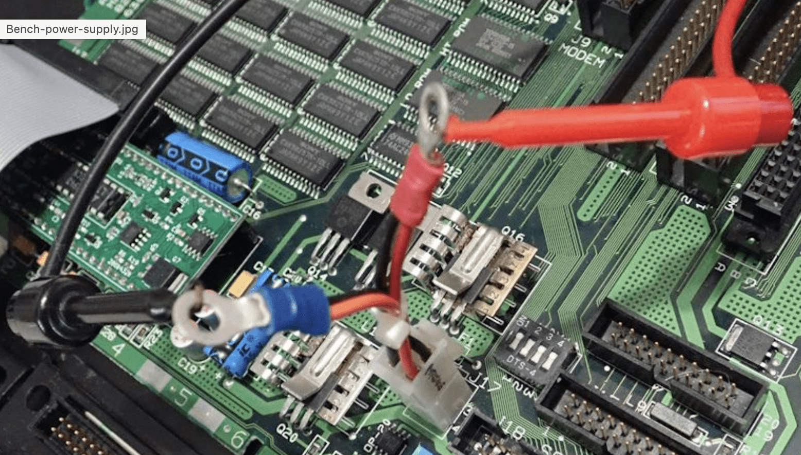

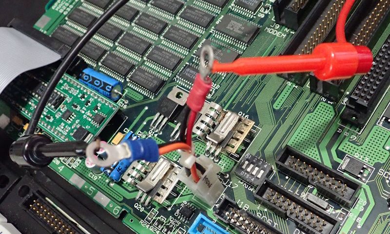

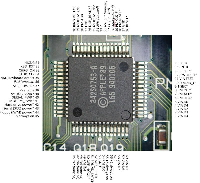

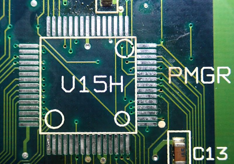

My first 5120 board has a dead power manager chip. The current draw is 33 mA. Pressing the keyboard shows no sign of life and the current draw doesn't change. In a healthy computer, the current draw is 10 mA, going to 300 mA and up when the space bar is pressed.
Without power, I checked the resistance of both the reset and interrupt buttons when pressed (<5 ohm)/released (> 10 kilohm) to make sure they weren't stuck. With power, I tried pressing and holding the pair of buttons to 'reboot' the power manager. Nothing.
I checked for broken traces and created a pinout diagram.
Ultimately, I have thrown in the towel on this Portable. I swapped its best parts (a nice screen and some plastic elements) with one of the other Portables. I will keep the board for parts or in case someone comes up with the replacement power manager.

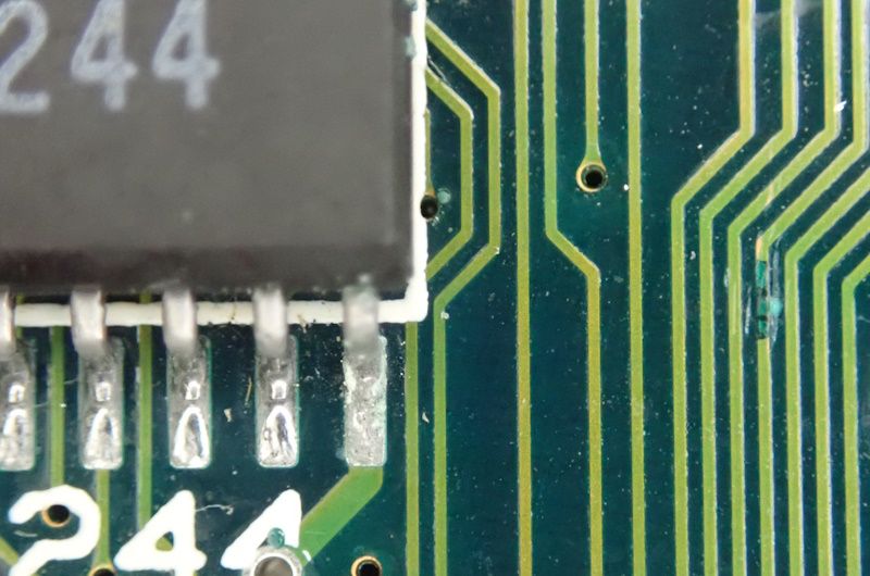

The second portable had two obvious issues that were easily fixed. The trace (right side of the image below) and the corroded leg on the 244 (left side of image). If you find any issues like this, look around to be sure you found them all. Also, resolder all the legs of nearby chips if any leg shows dullness or corrosion.

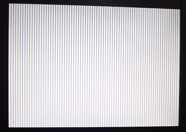

This last Portable motherboard did not make a startup sound and shows vertical pinstripes. However, it begins with a low current draw (10 mA) and wakes (~300 mA) when the keyboard is pressed. So, the power manager is working.

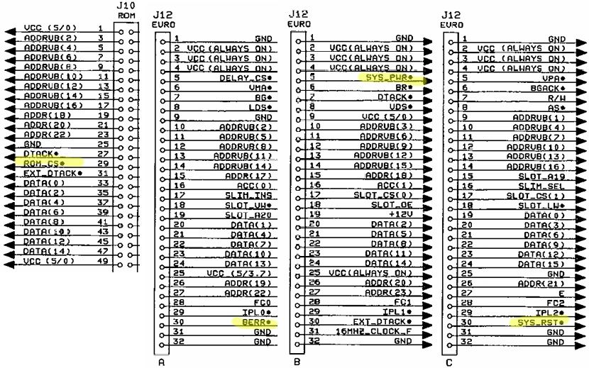

The slots on the Portable have lots of valuable pins for testing. (Please note that the ROM and RAM slots are numbered from bottom to top on the motherboard but top to bottom on the schematic, whereas the PDS slot numbering matches the motherboard and schematic.)
Any pin with an asterisk '*' at the end of the name means it is activated when the signal goes low. For example, SYS_PWR* is 5V when the Portable is sleeping and 0V when the Portable is awake. Got it? Opposite day. SYS_PWR* = 0 = GOOD.
ROM_CS* 0V indicates the ROM is being accessed. ROM_CS*=0=GOOD.
BERR* 0V says a bad address was accessed. BERR*=0=BAD.
SYS_RST* 0V means the computer is halted waiting for power to stabilize or the computer will now restart. SYS_RST*=0 steady=BAD.

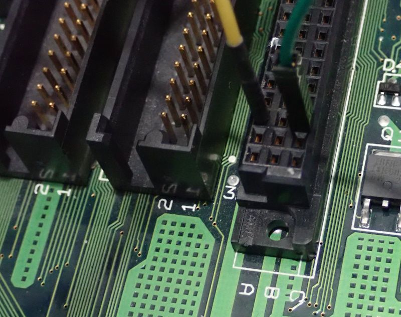

Get yourself some male-to-male jumper test leads and male-to-female jumper test leads for connecting an oscilloscope to the ports. I really like these:

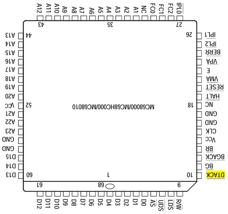

In the image below, I am watching BERR* (bus error) and SYS_RST* (system reset).
On this board, I noticed that after power up, this computer would show bus error, then system reset (correct: it should reset after a bad address), followed by four ROM accesses, followed by quiet, and then repeat.
What's going on? Well, when the power manager tells the 68000 to proceed (SYS_RESET* 5V = GOOD, SYS_PWR* 0V = GOOD), the following happens:

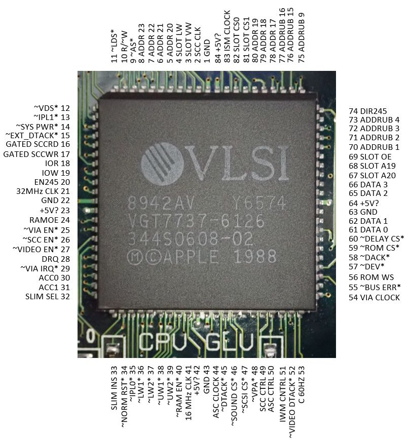

1. The CPU sets the address lines to $00000000 to read the ROM.
2. The CPU GLU sees this and sets ROM_CS* (ROM chip select) to 0V. Remember, low signal is active on pins with an asterisk. ROM_CS*=0=GOOD
3. The ROM chips see the ROM_CS* signal on their pin 22. The LO ROM chip outputs 8 bits (D0-D7). The HI ROM chip outputs 8 bits (D8-D15). Why? This is 16-bits. Ever heard of a 16-bit data bus? That's what this is.
4. The CPU reads all 16 bits of data and sets the address to $00000002.
5. The CPU GLU disabled ROM_CS* (5V) when the CPU completed the read. But, it now sees the request for $00000002 and sets ROM_CS* to 0V again. ROM outputs.
6. The CPU reads those next 16 bits (32 so far) and stores that as the stack pointer. It then sets the address to $00000004.
7. CPU GLU, ROM supply the next 16 bits. CPU sets to address $00000006. CPU GLU etc ROM supply the next 16 bits.
8. The CPU jumps to the address specified in those most recent 32 bits.
To summarize, read the first 4 bytes of ROM (2 bytes at a time) for the stack pointer. Read the next 4 bytes of ROM (2 bytes at a time) for the address pointer.

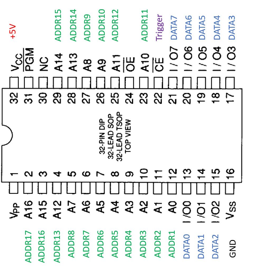

On my Portable, however, ROM_CS* was not going low at this point. I got four good pulses (reads the first 8 bytes, 16 bits at a time) followed by this moment when ROM_CS* was not being activated by the CPU GLU. Why not?

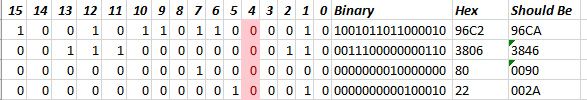

Since the circuit was auto restarting over and over, I connected my oscilloscope to each data pin on the CPU and recorded the low/high pattern. In a spreadsheet, it looked like this:
The third+fourth row should be $0090002A, but instead the data from the ROM reads $00800022. D4 is always low.
What is address $00800022 on the Portable? Nothing. Bus error! Reset! The CPU is doing its job -- it is just being told the wrong information.

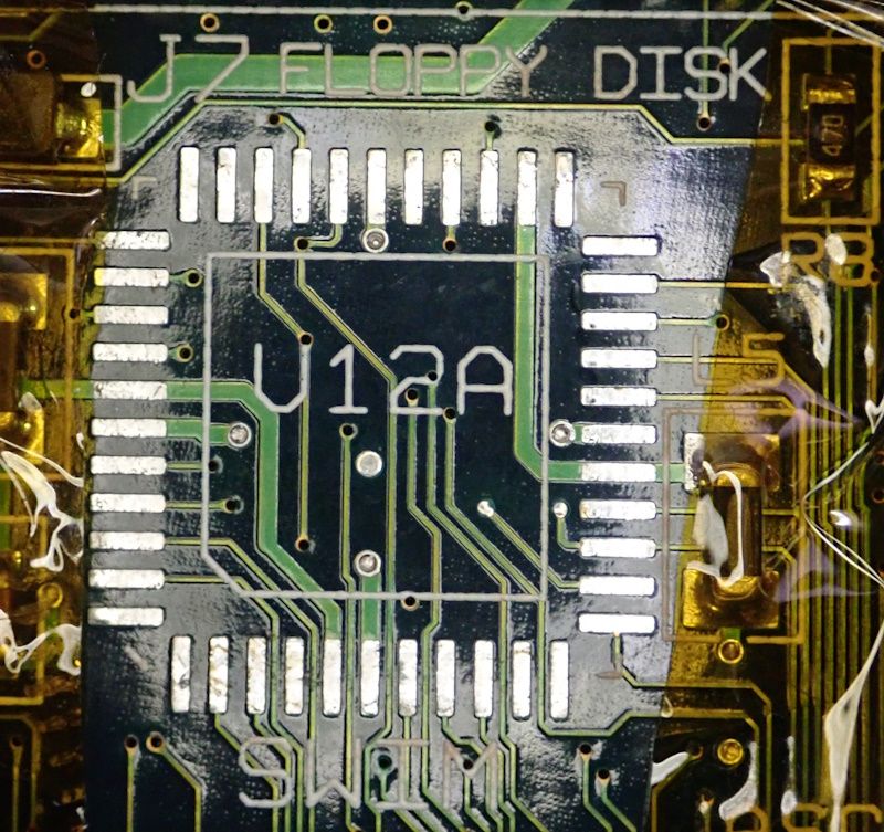

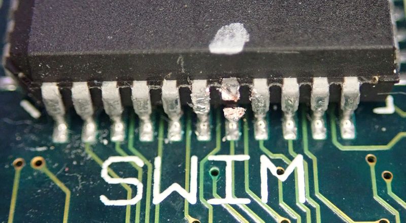

SWIM DROWNING D4
I checked the traces with a multimeter. They're good. Is the ROM faulty? Possible but unlikely.
@techknight advises people to replace the SWIM on their Portable. Why? On a hunch, I snipped D4 on the SWIM.
Chime! Good ROM data.
The SWIM can fail passively (no response) or actively (interfering with other signals). My SWIM failed actively on pin D4. Yours may differ.

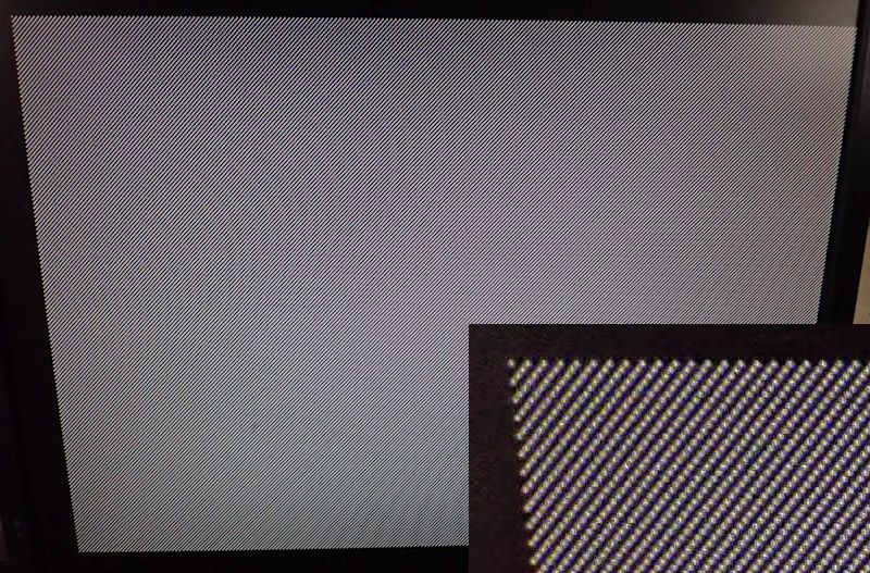

The Portable now got to here (see image below). We see a valid pattern on the screen. This is really good news. It means video works, the CPU works, the ROM works (this pattern was read from ROM), etc, etc etc. But, look closely and you'll notice this isn't the normal every-other-pixel pattern. This is the 'I'm testing memory or other stuff' diagonal pattern. No cursor and no disk icon.
I removed the SWIM with hot air. Same diagonal patten. Some people think the Portable can boot with the SWIM removed. It cannot.

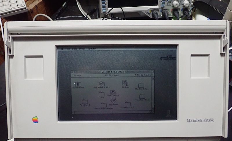

I substituted the SWIM from a dead PowerBook 170 and was greeted with:
Success.
This particular board also needed a sound crash fix which I will describe some other time. But, hopefully this demonstrates the start up sequence and a technique that you can use to hunt down problems in your Portable.

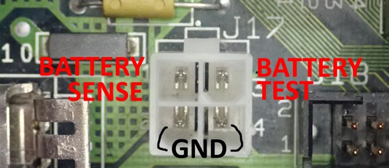

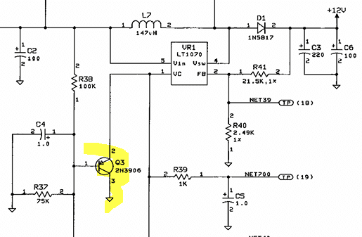

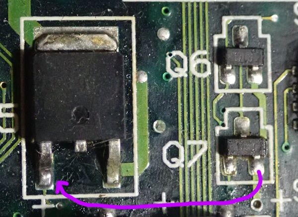

I have occasionally had to bypass the high-side load switch MOSFET for the sound circuitry because it gets noisy if not, 12V hovers around 4V and causes a lot of noise. They did away with this circuit in the backlit portable, so it is safe to do.
Reactions: JDW and David Cook
I am so glad you said that, because that's what I had to do to get the Portable to not crash when playing sounds. I was embarrassed to post my 'hack' because I felt it wasn't a solution. But, given how many Portables you've worked on, and given that Apple disabled this in the backlit model, it appears to be a flaw in the design.
- David
It absolutely was a flaw, and what I find even more interesting is some portables do this, while others do not. I think its crap getting in the middle layers or whatnot. But thats just a wild hairbrained guess.
Reactions: David Cook and JDW
Fantastically detailed repair thread, @David Cook — thank you!
You said: "The biggest mistake when repairing these machines is providing power during testing to only one of the +V inputs."

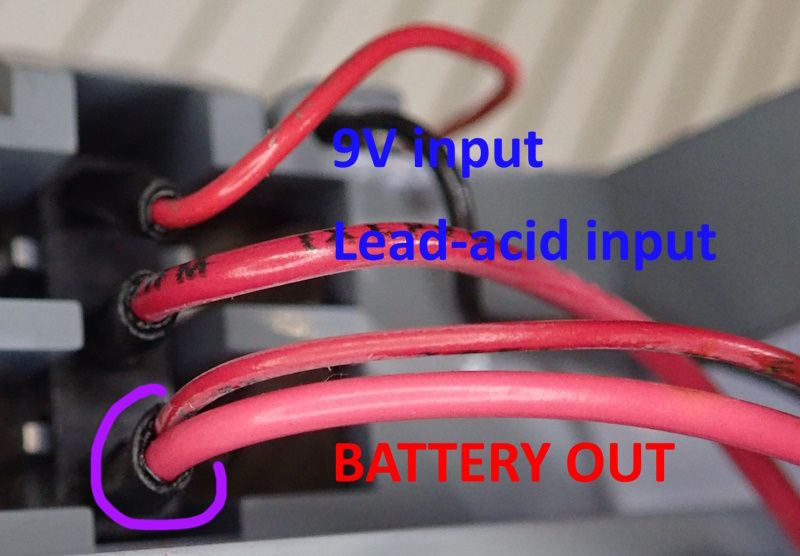

QUESTION: Is your photo below showing us what we SHOULD do or should NOT do? (What my eyes see in that photo: (1) the same Ground entering the bottom two connector slots via the BLK & ORG wires, and (2) the same +6.3Vdc@1A (via benchtop PSU) entering the top two connector slots via the RED & BLK wires. Correct or Incorrect?)
I regret reusing an old hard drive cable for this photo -- as the color of the wires is confusing when used on a Portable. Give me a minute and I'll upload a better diagram.

Here is a better look at the Portable battery input connector (J17) on the motherboard. Like other power connectors (such as on the Macintosh II, IIcx, or LC series), the ground inputs are actually connected together on the PCB itself. However, unlike other power connectors, the +V inputs are actually split up and go to different parts of the board.
BATTERY_TEST (poorly named) pin 3 of J17 is the main power source. It goes through fuse F1, meets up with the AC power adapter input, and supplies power to everything in the Portable.
BATTERY_SENSE pin 1 of J17 only goes to pin 25 of the hybrid module pin. (This information is for the 5120. I don't have a schematic for the 5126 and don't have mine disassembled to check.)
Because the battery connections are not tied together on the PCB, there is a danger when only one portion of the circuit receives power. Apparently, the hybrid module is unable to regulate power input when only the BATTERY_TEST terminal is connected, as the hybrid module sees 0V (or float really) on the BATTERY_SENSE pin.
So, you should always hard-wire your +V side of your harness together when using a bench power supply. Might as well do the same for GND. See below.
Isn't there a problem if Apple intended for the input to be split? Nope. On my Portables, Apple also wired the +V together before reaching the connector. See the purple circle on the bottom left of the image below. Apple has a switch that connects the output (to the PCB) to the big lead-acid battery when the plastic battery cover is in place, or the little 9V battery when the battery cover is removed. But, in either case, both wires leading to the PCB input J17 are crimped together.
My harness is marked revision 9. Perhaps Apple originally had a different plan for the +V inputs?
I do have a slightly radical suggestion. Perhaps we all should solder a jumper wire between J17 pins 1 and 3 when recapping our boards, just to avoid future problems where one connection becomes oxidized or loose.
Aside: @JDW would not be happy with the narrow gauge of the wire that provides power to the screen, hard drive, motherboard, memory, modem, etc. Yes, the little wire helps too, since it has been crimped together. But, this doesn't compare to the upgraded wiring harnesses JDW prefers for the SE/30. No accelerators for the Portable, I guess.

I just repaired another Portable that was crashing when sound played. I decided to put this board in my ultrasonic cleaner. Afterwards, the hybrid module was dead. That's okay -- as I was just experimenting to see if I could get it to last. I replaced the module with a modern part, per usual. I noticed a lot of crud in the pin holes after desoldering the old module. So, I cleaned each hole carefully and then soldered in the new module.
Well, I was pleasantly surprised to find the cleaned Portable no longer crashed when playing sounds. It could be that indeed some crud on the board (or in the hybrid module pin holes) is the source of trouble.
Had the Portable continued to crash after cleaning, my plan was to replace Q3. It is located near a lot of capacitors and I can see how a faulty transistor there could result in voltage issues on the 12V rail.
I have reached the end of my Macintosh Portable pile. The final Portable did not power on and did not change current usage (as displayed on the bench power supply) when a key was pressed on the keyboard. That suggested a bad Power Manager chip. I originally believed that was a death sentence, so this Portable became my "parts" machine. That is, if another Portable had a broken plastic part, screen, whatever, I would swap it with the "parts" Portable.
This week, I decided to tackle this "parts" machine and see if I could get it working.
1. Using a hot air station, I removed the power manager chip from a PowerBook 100 with a dead screen. I transplanted that chip to the Portable. Both models use the same part. Here's what the PCB looks like underneath the Portable Power Manager chip.
2. I replaced the hybrid module, this time I purchased one from @SuperSVGA. It has a lower profile than the other hybrid modules that I've purchased in the past. So, it can be socketed and still fit in the Portable's case without needed to cut away any plastic. [Note: I actually replaced the module earlier -- so I knew the Power Manager chip was bad and not a consequence of a bad hybrid.]
Between steps 1 and 2, the "parts" Portable booted!

4. The Portable crashes when playing a sound. This is now the third time I've run into this. One time was fixed by an ultrasonic cleaning. One time I "fixed" this with a bodge wire to keep sound power enabled. Ala @techknight
I have tried cleaning and resoldering Q6/Q7 without luck. This time, I tried replacing Q3 and verifying the connections and values of C2, C3, C4, C5, C6 and associated resistors. My theory is that inductor L7 kicks in to fill C8 but due to some problem in that portion of the circuit it creates a lot of electrical noise in the 5V line or nearby chips. Despite all of this work, it did not fix the sound crash. So, I once again resorted to a bodge wire to keep sound enabled. This prevents the crash and behaves just like the 5126 (that lacks the ability to turn off the sound).
If I had the energy, I would experiment with replacing VR1, increasing the capacitance of C3, increasing the inductance of L6, or decreasing the capacitance of C8. The theory being that if the step up regulator didn't have to work so hard it wouldn't be so noisy.
