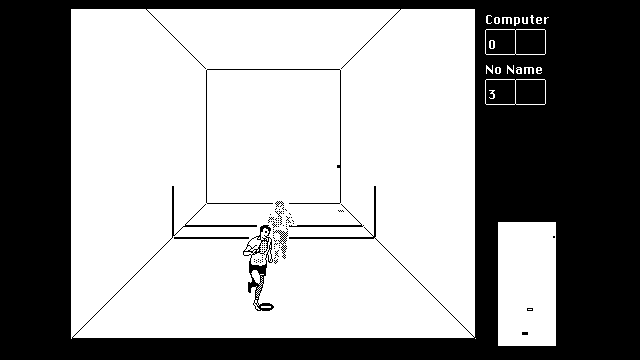

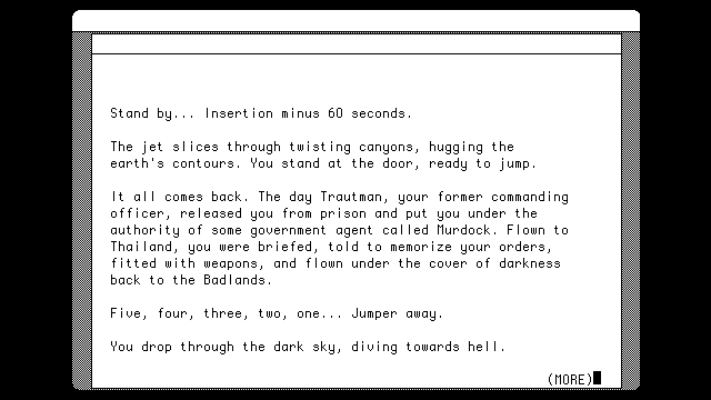

BREAKING VINTAGE MAC NEWS: moof support was added to the FloppyEMU. This means it can read surface-level perfect copies (copy protection or not) for your vintage macs. And the collection of moofs keeps growing and growing these days. Awesome! This hits the 1984-1985 era emulator folks usually don't care about or don't have the cracking skills for! AMAZING. Winter Games was notorious for eluding emulation.
Winter Games has been one tough cookie to crack over the years. No sweat here.

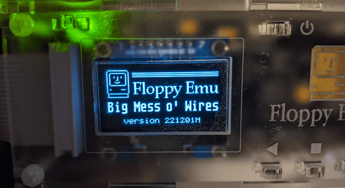

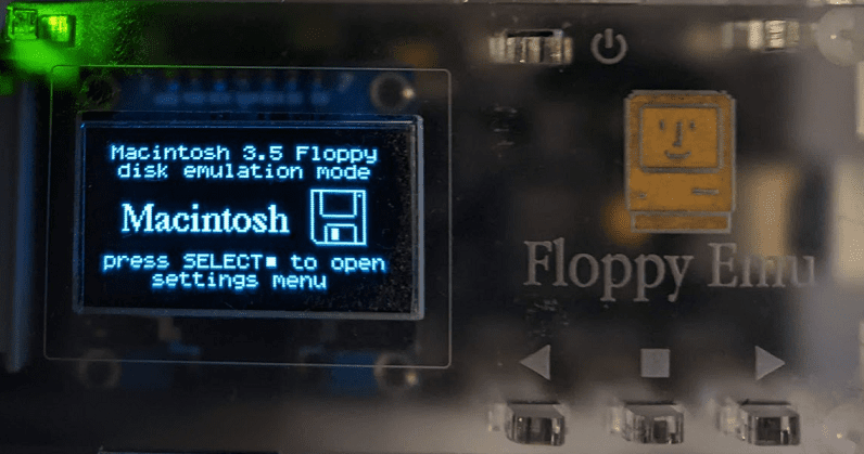

The process is pretty easy:
1) Get the newest firmware here https://www.bigmessowires.com/2022/12/03/m
2) extract the .bin file into the root folder of your floppyemu
3) power the floppyEMU while it's plugged in your classic mac
4) hold BACK + SELECT on the floppyEMU and tap power
5) wait half a minute and you're done

Hi Just tried to update firmware on my floppy EMU to latest and am getting "Firmware Warning , Please install firmware Part 2, Expected CPLD Ver 16 Actual CPLD Ver 15."
Anyone Know how to fix
Thanks for reply I just fixed it by trying again maybe I had wrong buttons with my fat fingers?
