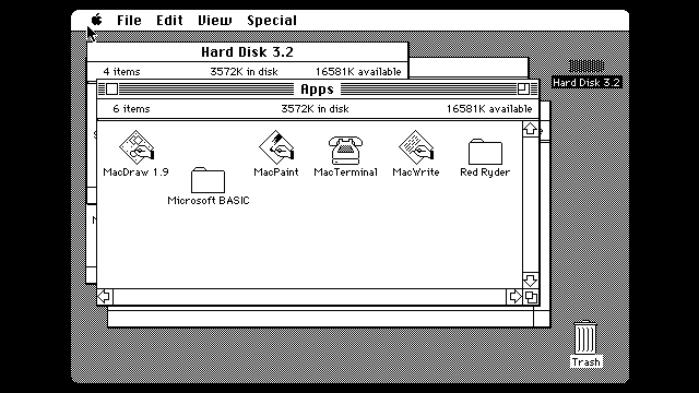

Once I used another file called HD20System32.dsk (20 Mb, probably was provided by BMOW but I renamed it?), all is well, screenshot proof:
