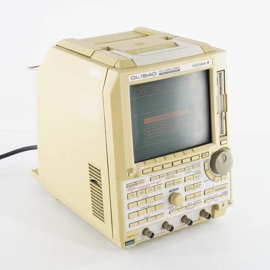

Got me a Yokogawa DL1540. Great shape with case, probes and all documentation included!
Orange CRT 😻😻😻
Made in Japan 😻😻😻
Similar form factor to the classic all-in-one Macs 😻😻😻
...You bought that because it looks like a classic mac, right?
You know, I used to scoff at people that put Apple stickers on their stuff, as if it was cringe to do so.
Now, I understand. This thing fits right in with a 128k, and feels incomplete without an Apple sticker. :LOL:
