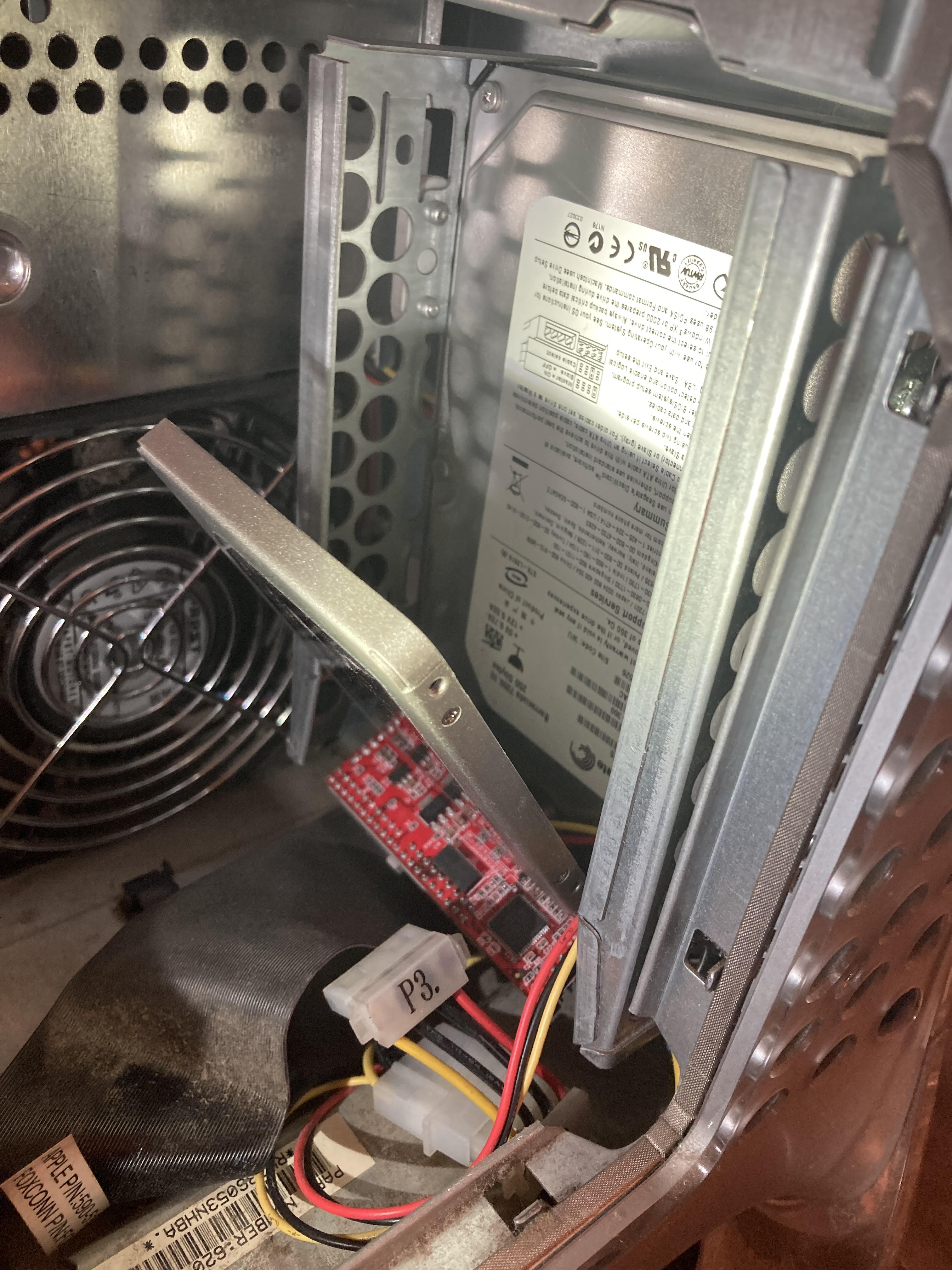

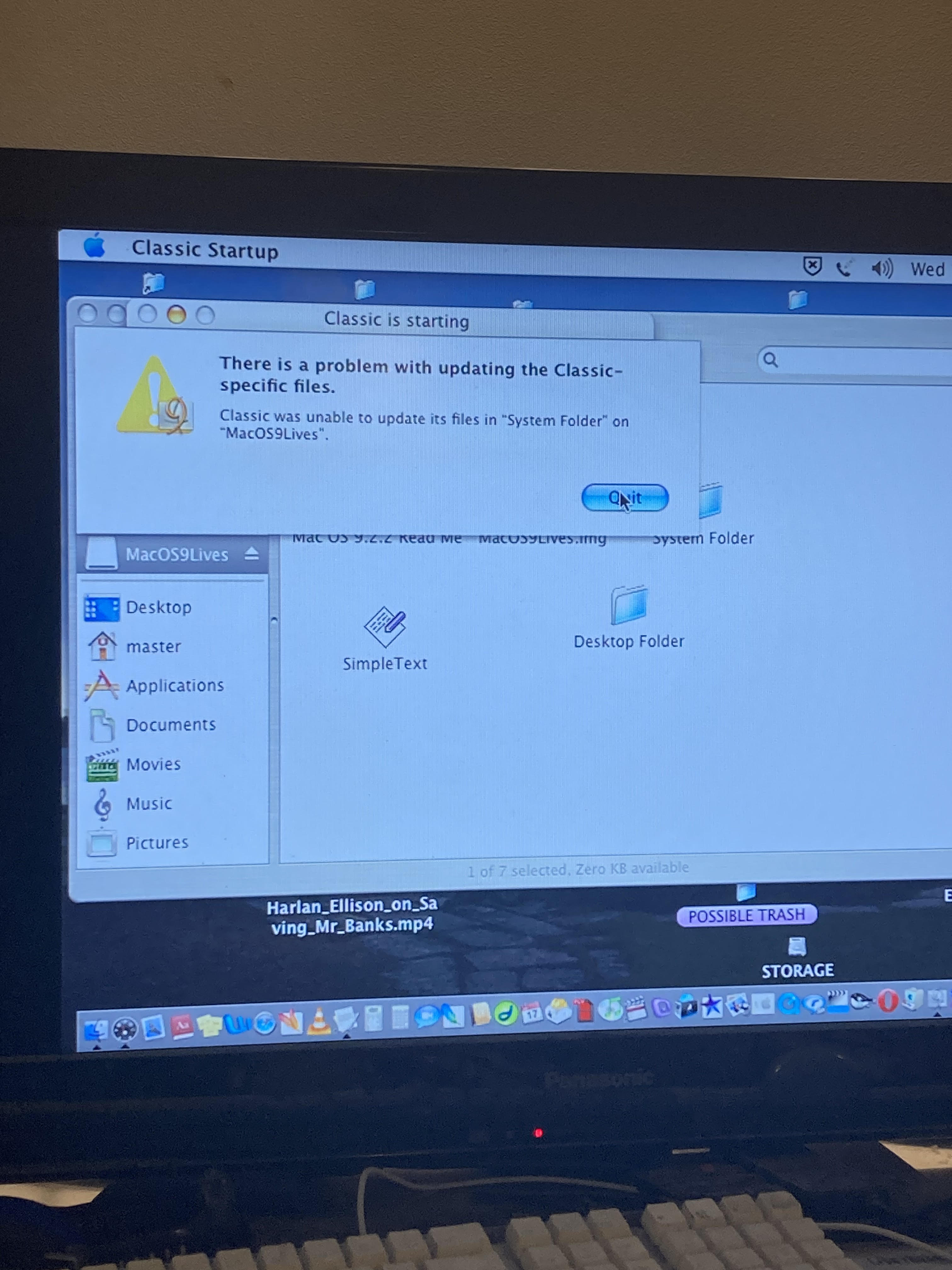

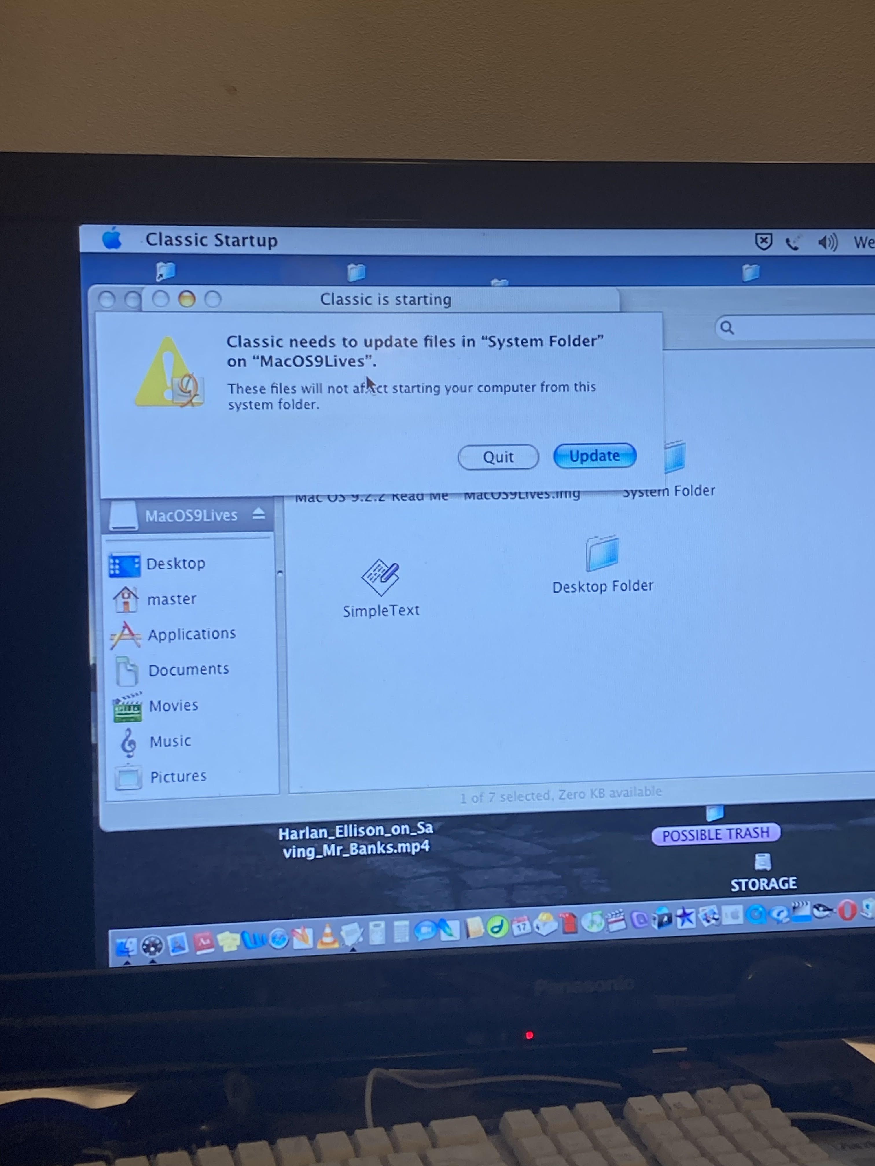

Okay, I cleaned the inside of the G4 a bit, put new thermal paste on the processor and added the SSD, partitioning it.. I found that in order to try and install OS9 on the SSD, the original OSX HD had to be in there as well. Downloaded the OS9 drivers from this link:
I ran into the following problem, which you can see in the pics below. Unfortunately, this Mac doesn't have a wi-fi card.

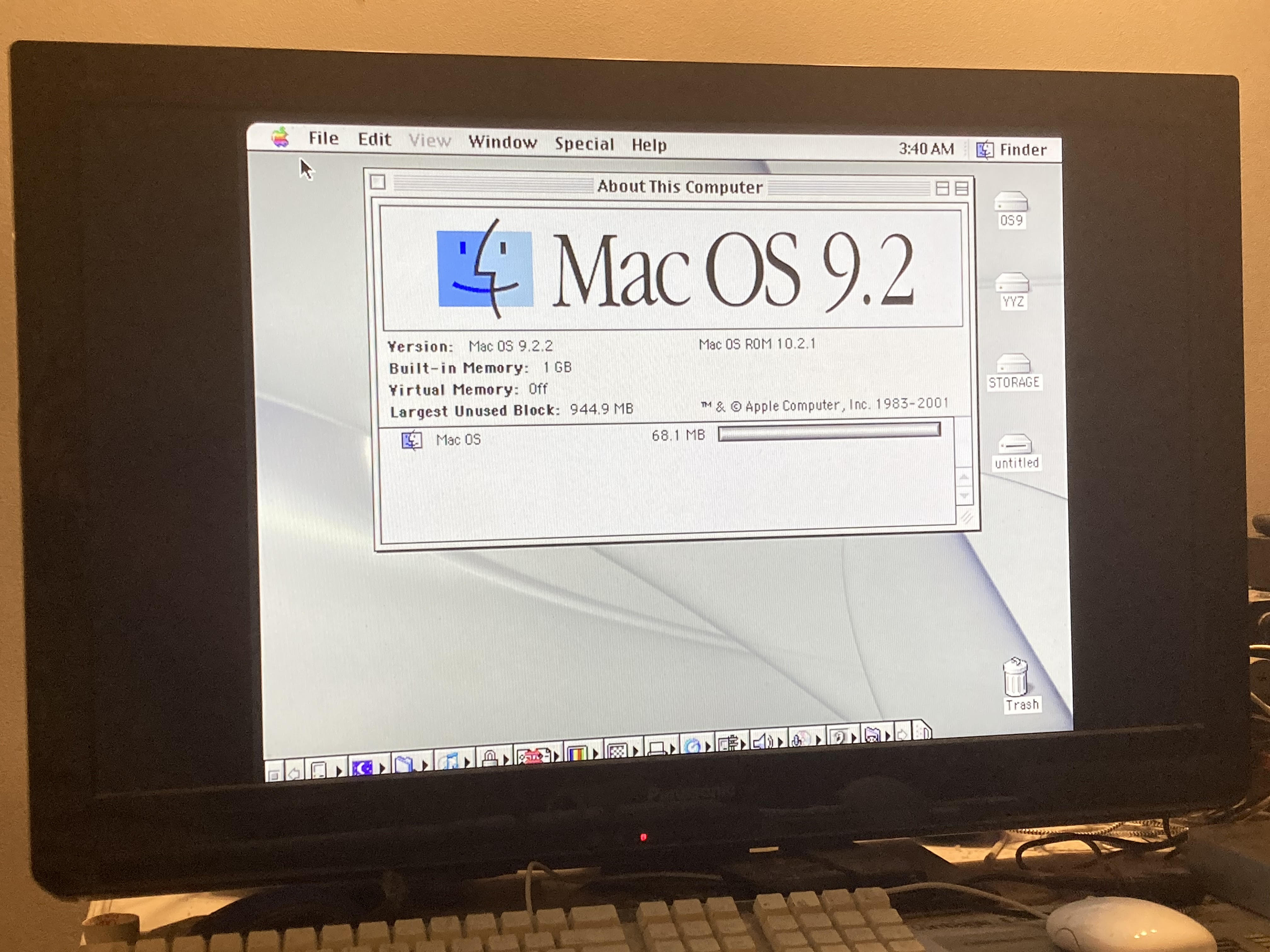

In the end, I want the option to be able to boot into either the OS9 or OSX drive. It's frustrating that I got this far, but I haven't been able to install OS9. The original thread is here:

The bridge I'm using here was recommended by Sean (Action Retro) in one of his videos. However...I don't know if anyone has tried using it in this fashion before, using two separate boot devices-a mechanical HD (the original drive that came with this G4, that has OSX) and the SSD that I would like to install OS9 on and boot up from as an option.

I just looked carefully at the screenshot and understood what your problem was: you did not install OS9, but just copied the contents of the disk.
MacOS9Lives.iso is the boot image that is used to install OS9.
OS9 is actually in the MacOS9Lives.img file. This image needs to be expanded to a section and then it will work.
If you only need Classic and you do not want OS9 on a separate partition, you can download and install the package that was bundled with the 10.4 distribution.
