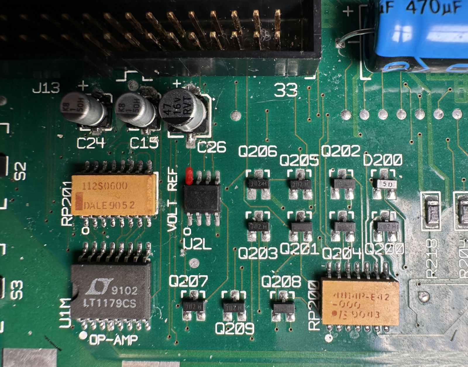

Below is a photo of the 5126 motherboard by @Branchus , and we can see C15 is the hybrid / power manager area in the lower left:
When I had my 5126 recapped, there was a fair amount of trace damage in the area of C24, C15 and C26. Meaning, some traces had to be rebuilt with overlaid wire, and at least one thru-hole was rotted out and bodge wire had to be applied to the bottom side of the motherboard. I suspect the same to be true in your case too, which means a lot of beeper-mode checking of that area (top and bottom) with your multi-meter.

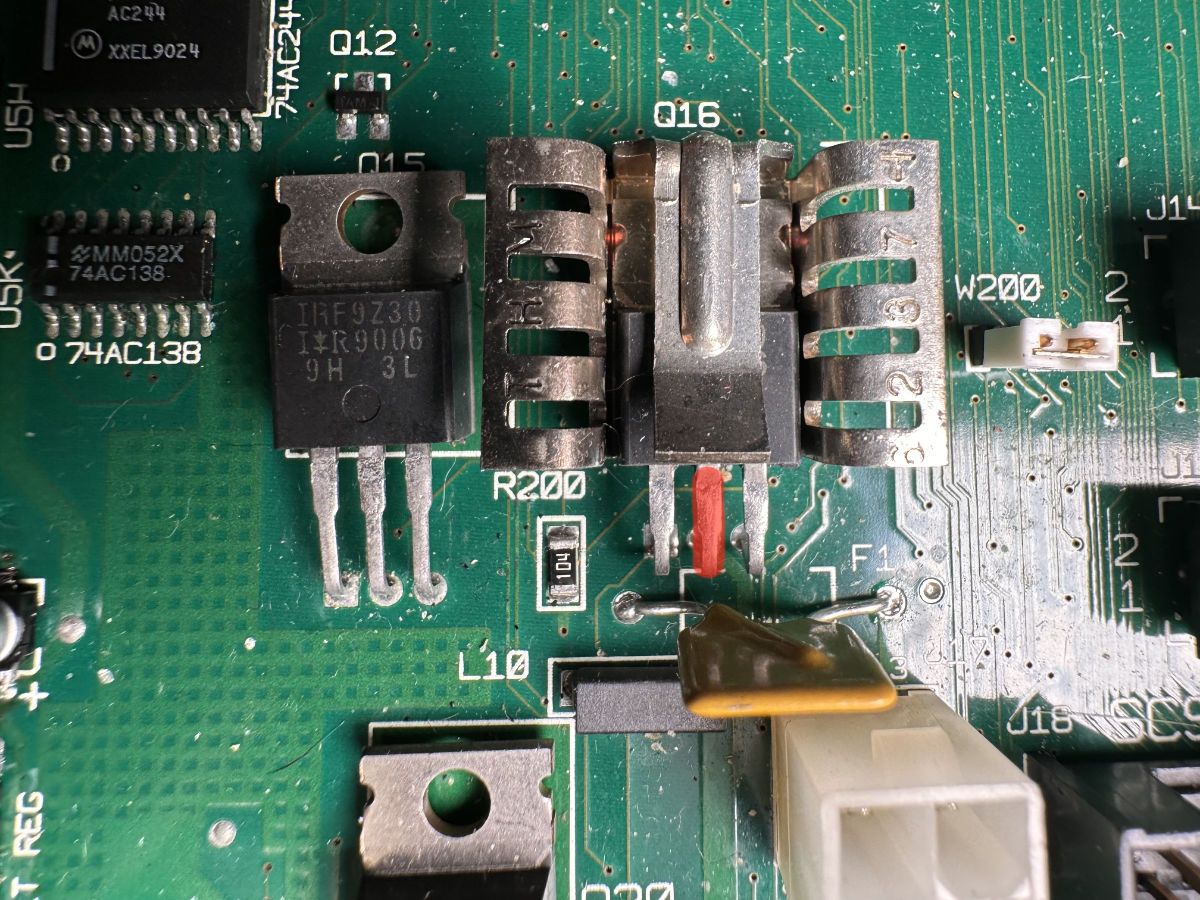

Start with the most important voltages first, the 1.2V reference and the +5V. If possible watch it for a bit to make sure it doesn't fluctuate about.
1.2V on pin 8 of U2L:
+5V on pin 2 of Q16:

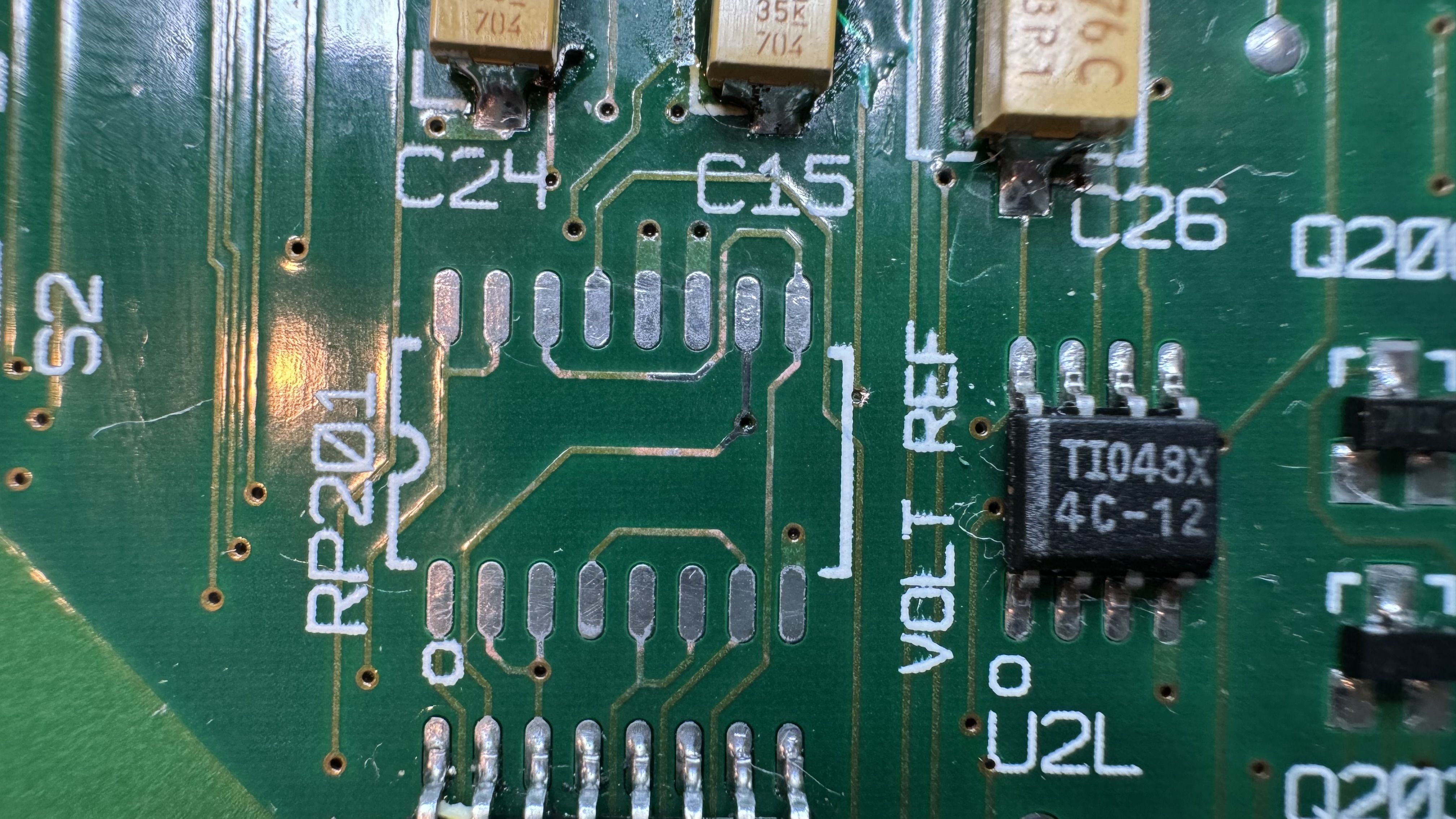

I found a rotten trace and via under an almost rotten off leg of RP201. I haven't patched it up yet, but suspect this is the issue.

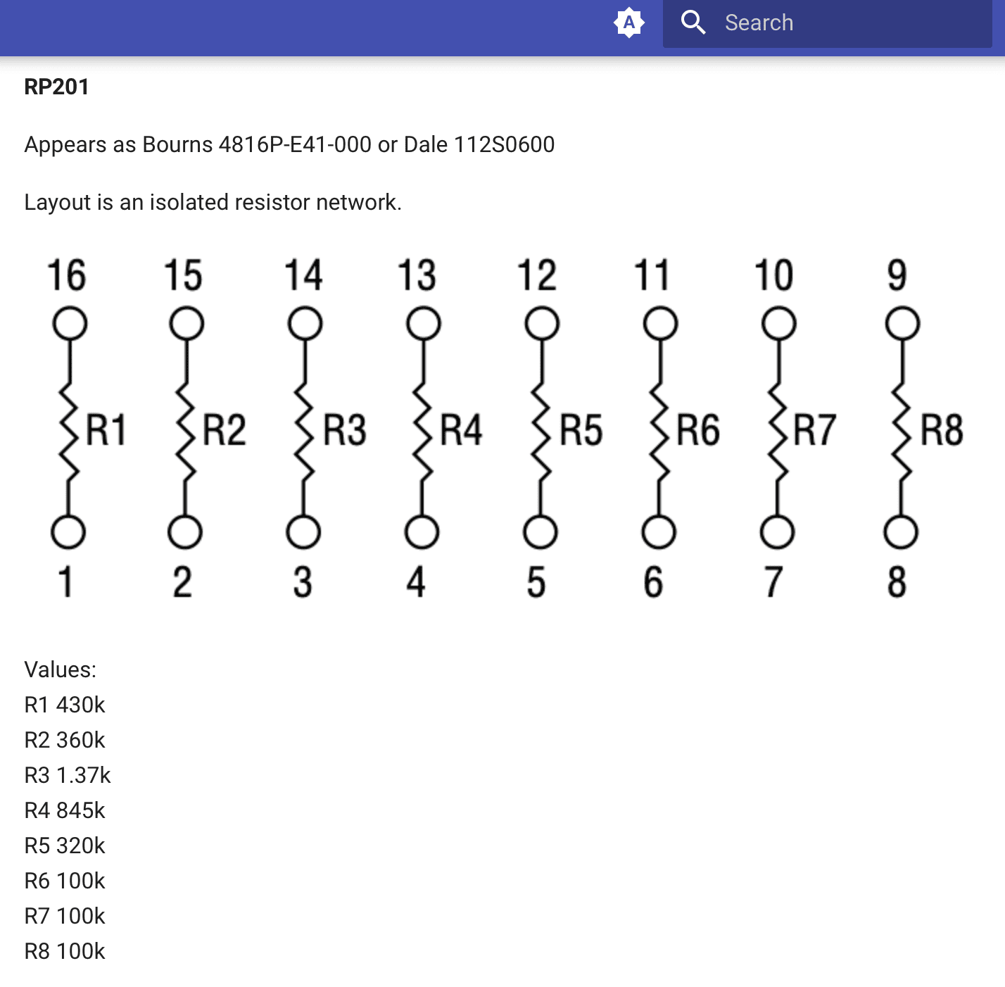

BTW, the current Datasheet for 4861P doesn't seem to decode the part used on RP201 which is a Bourns 4861P-E41-000 and I can't find that part online anywhere. If you know what the spec for that resistor pack is supposed to be, please chime in.
That would be the trace connecting the 1.2V reference to pretty much everything else.
Here's what I have documented for RP201:
