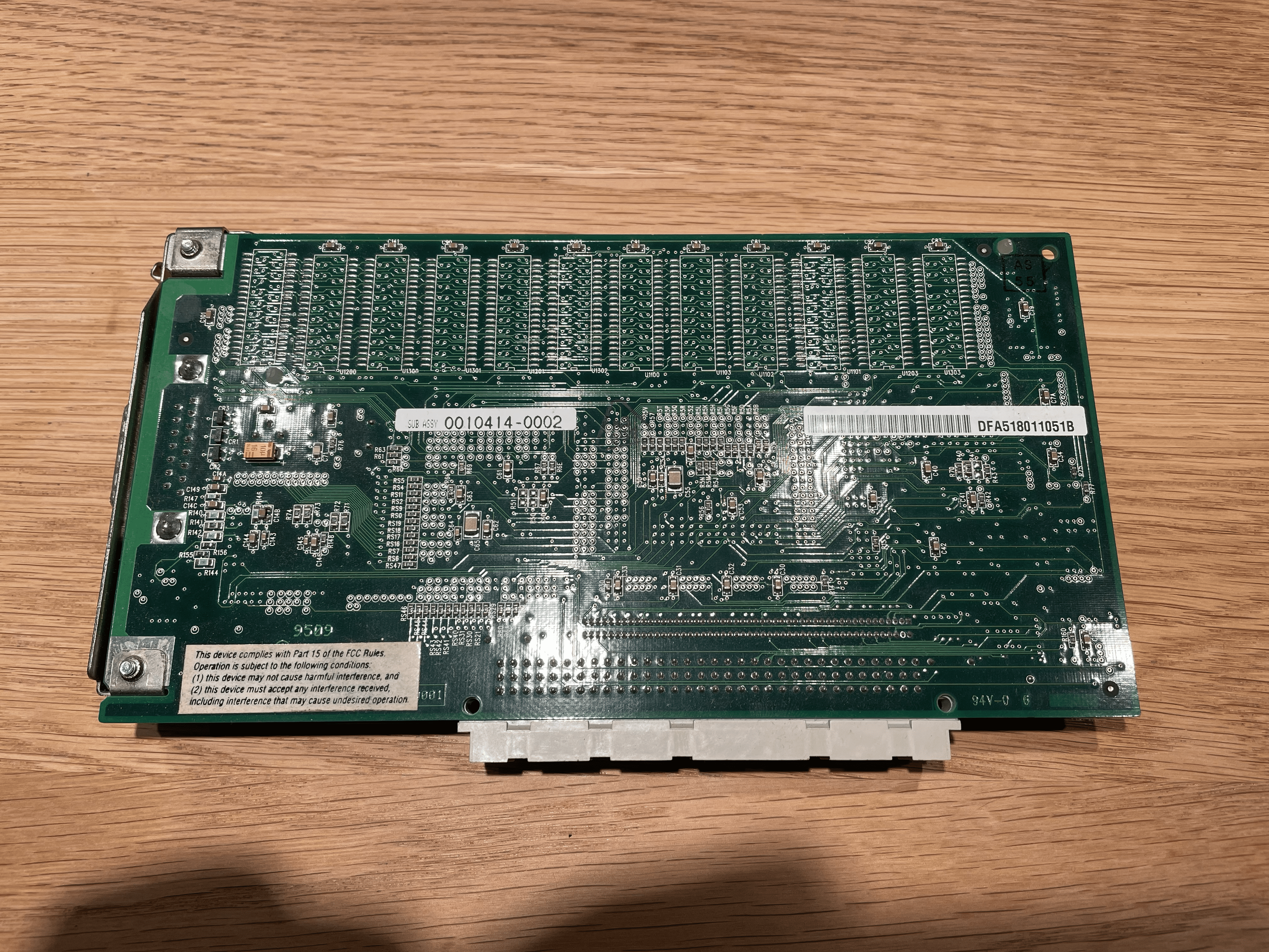

Hi all, found an Quadra 650 with some cards inside but needed it for the videocard to place it in my Q700. But cannot find exact card it. It looks like a Radius Thunder IV but the numbers are not the same on the card and on Internet, is there someone how recognise this card? (DB-15)

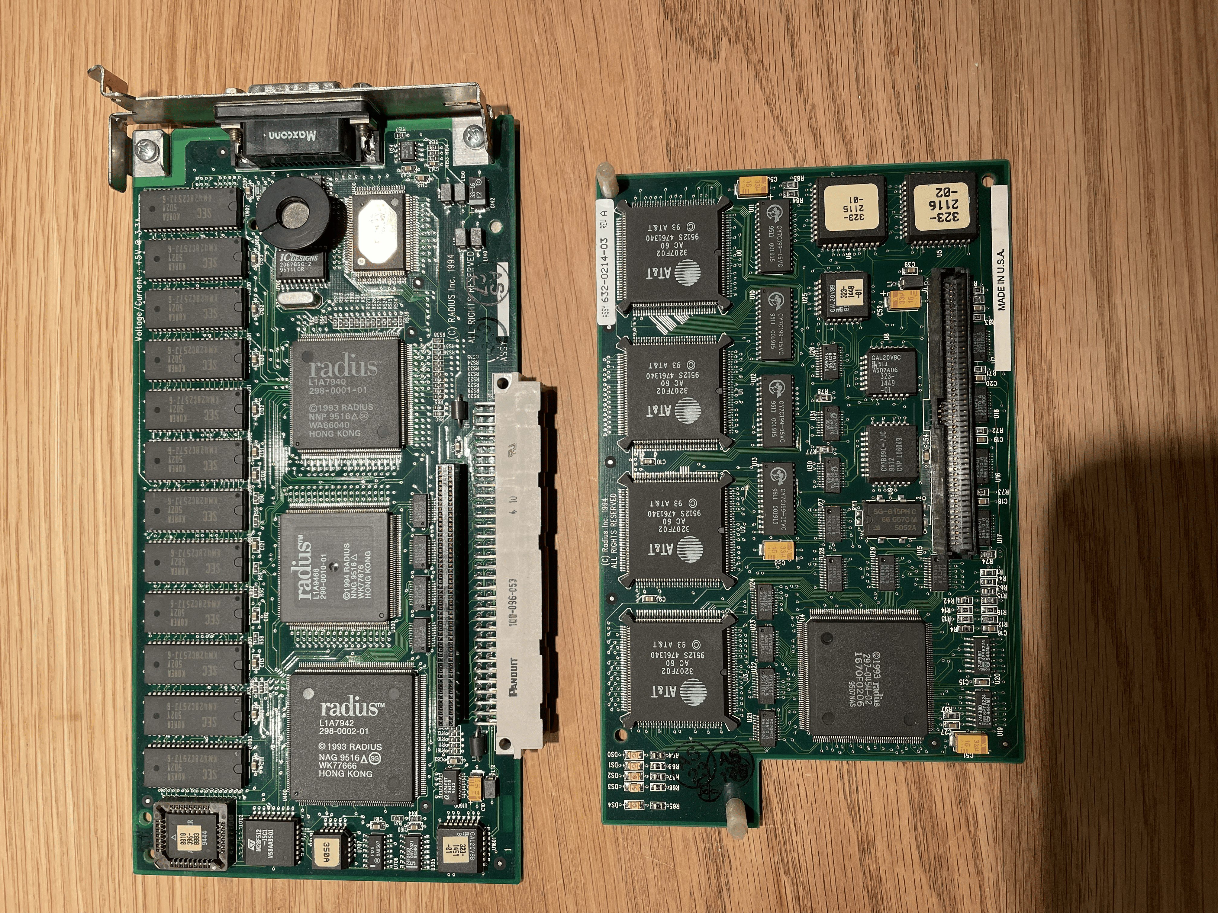

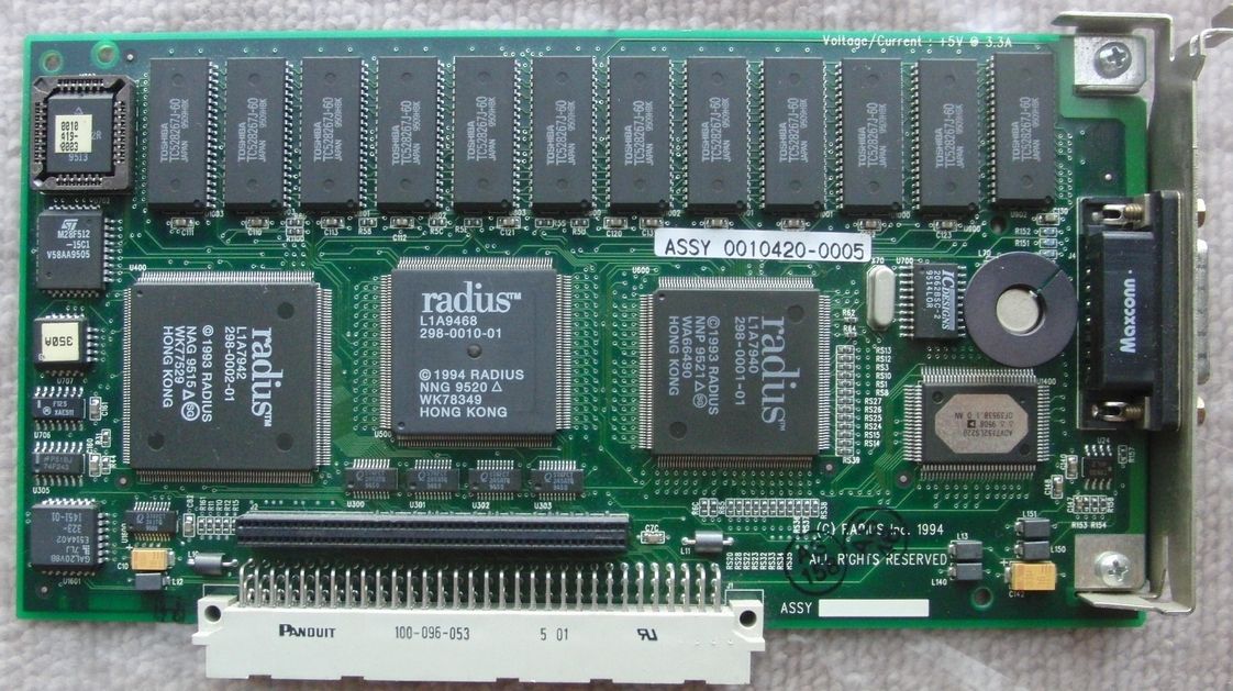

Radius Thunder 24/GT NuBus video card (I have one, see photo below) along with the DSP daughtercard for Photoshop acceleration. When combined together, the two cards are called the Radius Thunder IV GX 1152. Higher end cards in the Thunder IV GX series simply have more VRAM and support higher resolutions and more colors, but performance is the same.
The card itself draws a lot of power and that DSP card just adds to it, so if you don’t take advantage of it for Photoshop acceleration, it’s probably better to remove the daughter card. And in that case, you would want to store it in a protective antistatic bag and take care of it because those are rare.

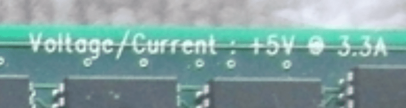

You can see precisely how much power that video card consumes, even without daughter card, by looking at the card itself…
Built-in video of Quadra machines is faster than that card, but for older Mac II machines like my IIci, that’s about the fastest card available for video.
Here’s an excellent FAQ about the cards…
Reactions: Kai Robinson

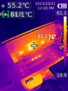

...do you now what that black looks like floating ufo is doing? Left from the db15 connector
I've never taken my little UFO guy apart to find out, but using my thermal camera I see it's one of the hottest parts of the board (61.1°C, after machine was on for 1 hour), which tells me it must be a heatsink of some sort.

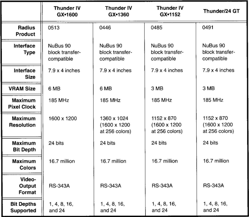

Here's a card feature side-by-side chart:

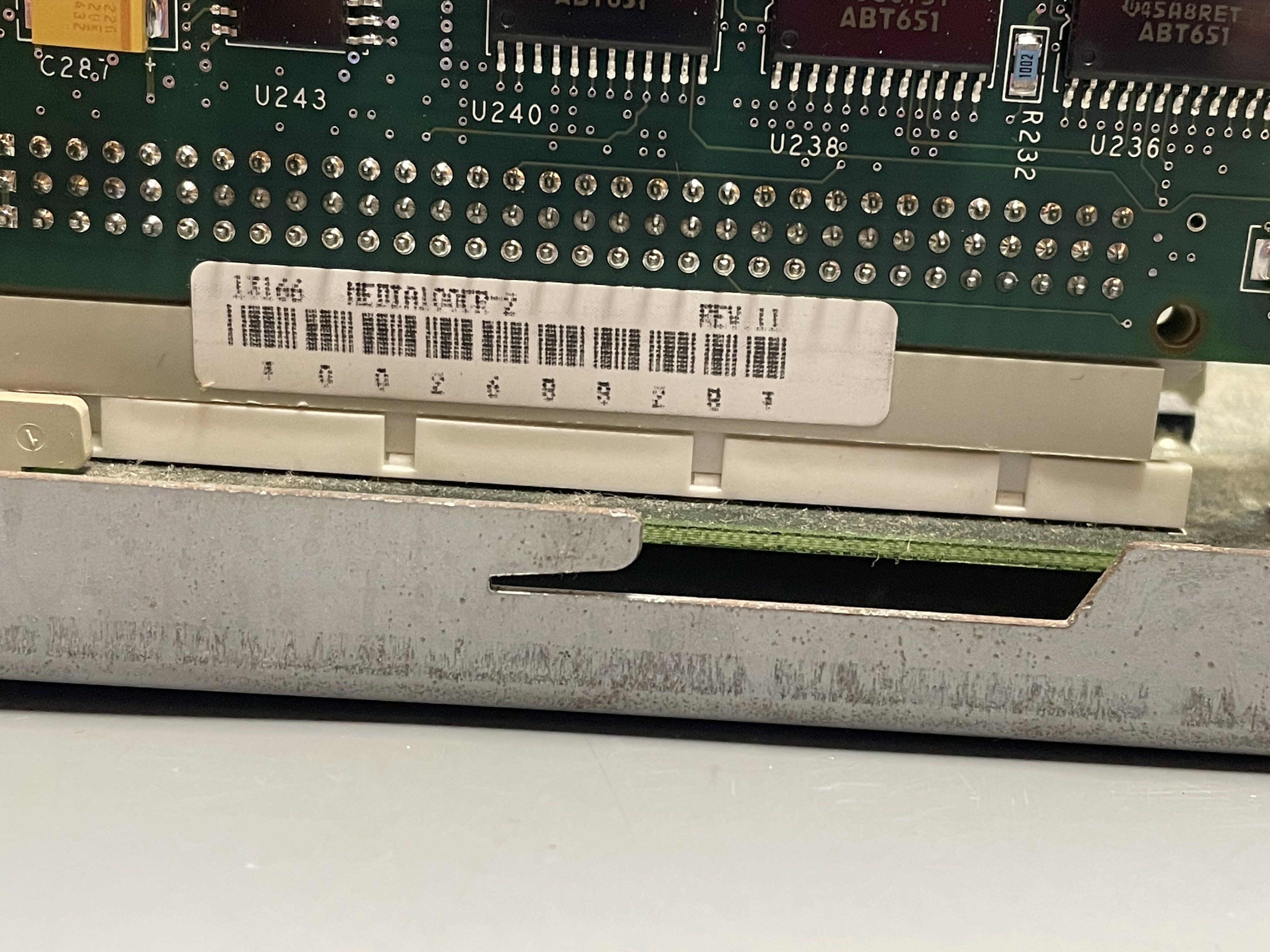

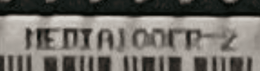

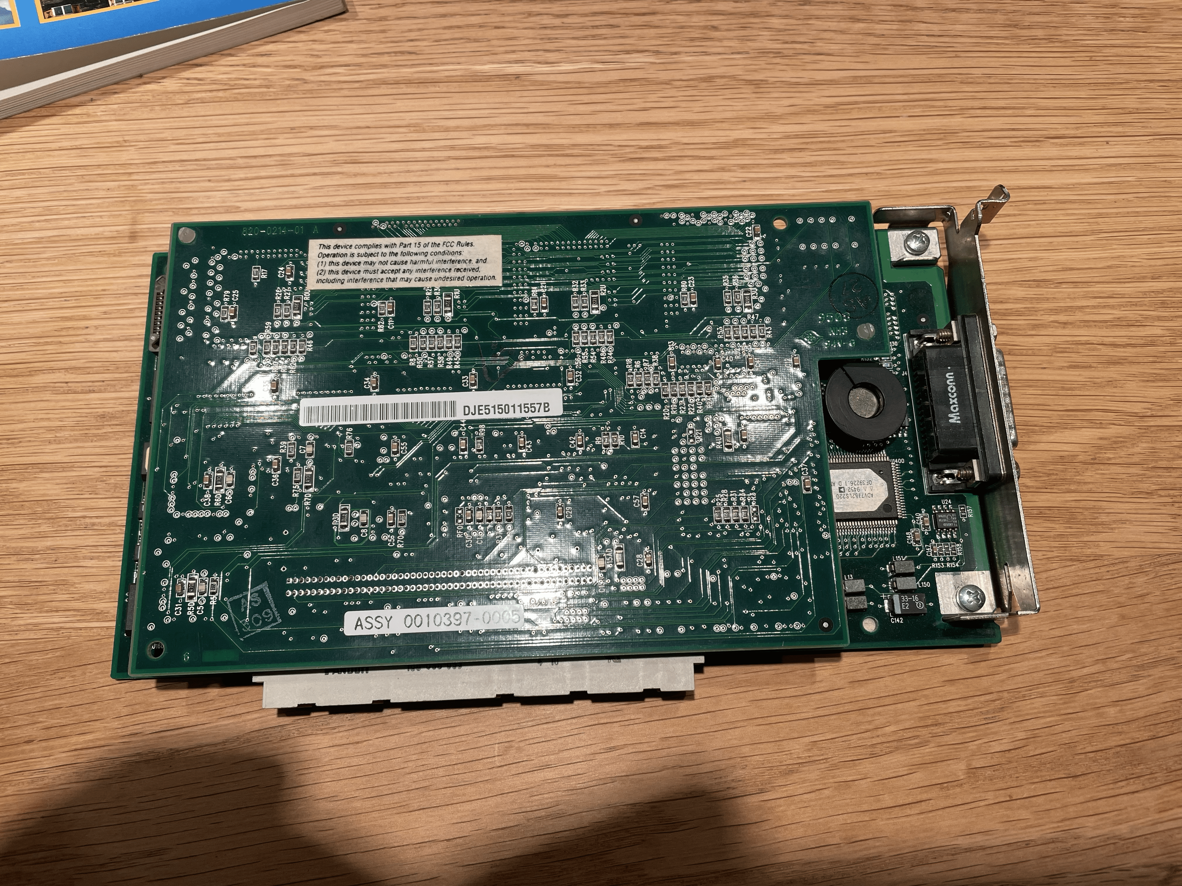

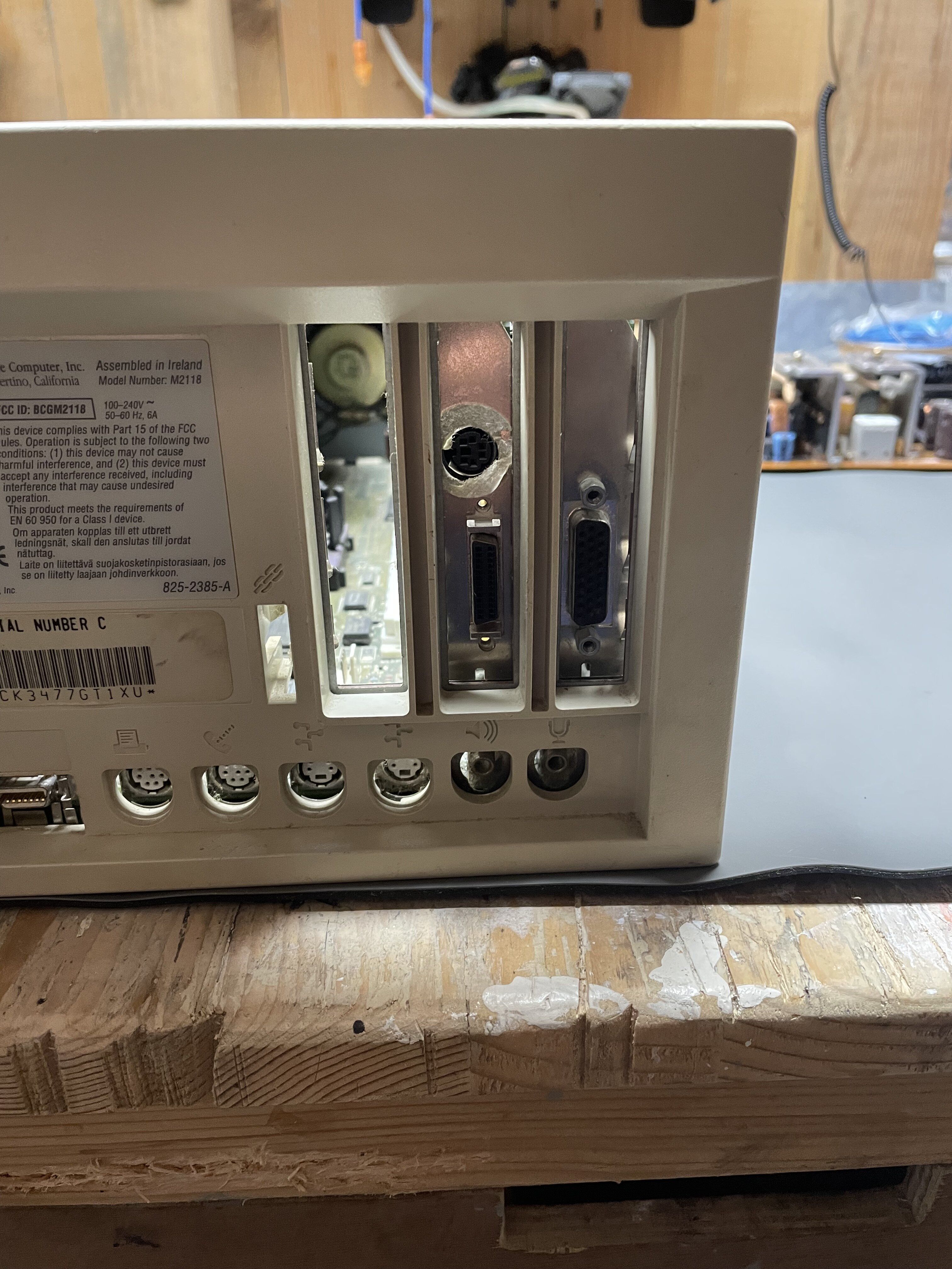

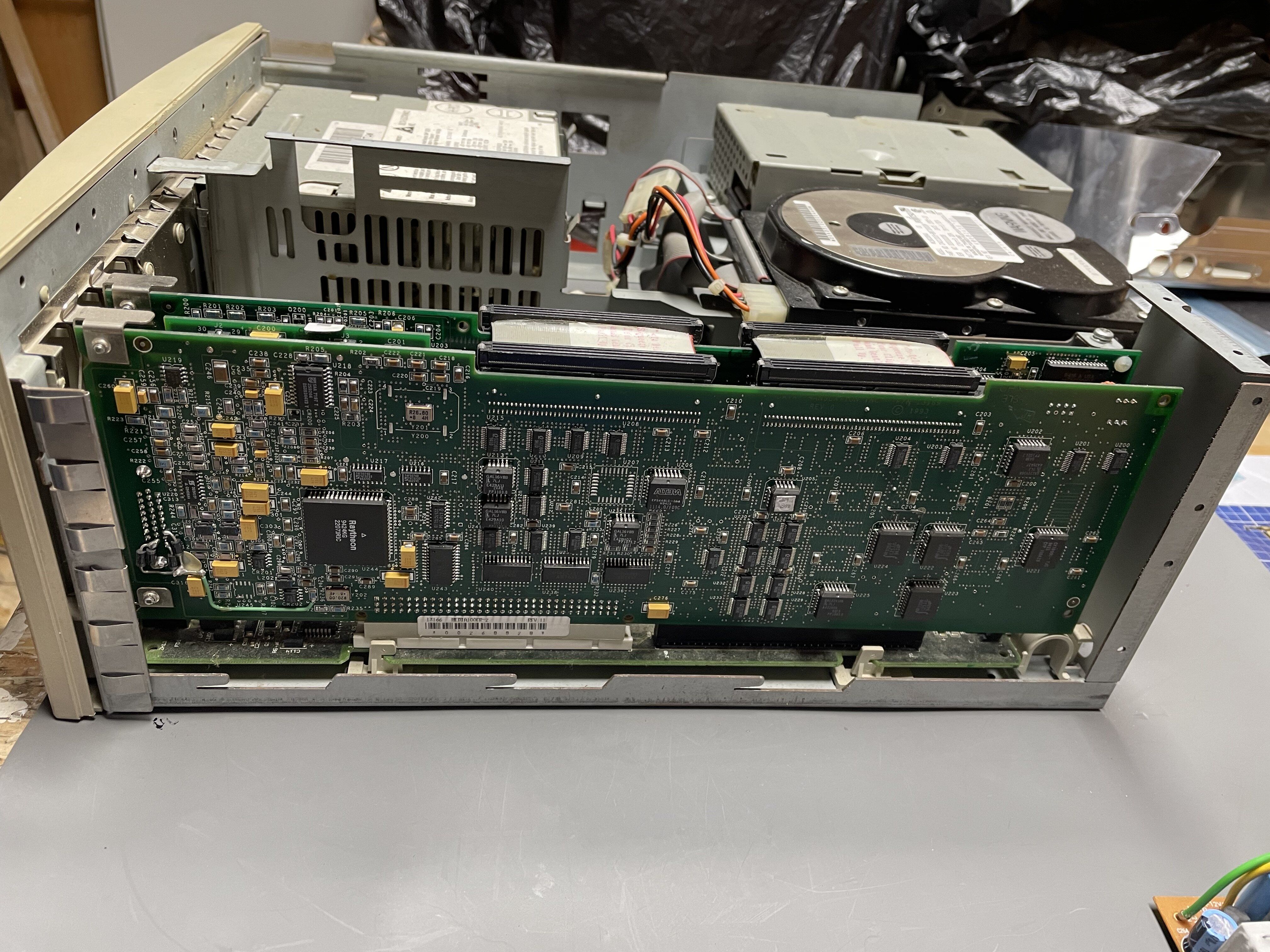

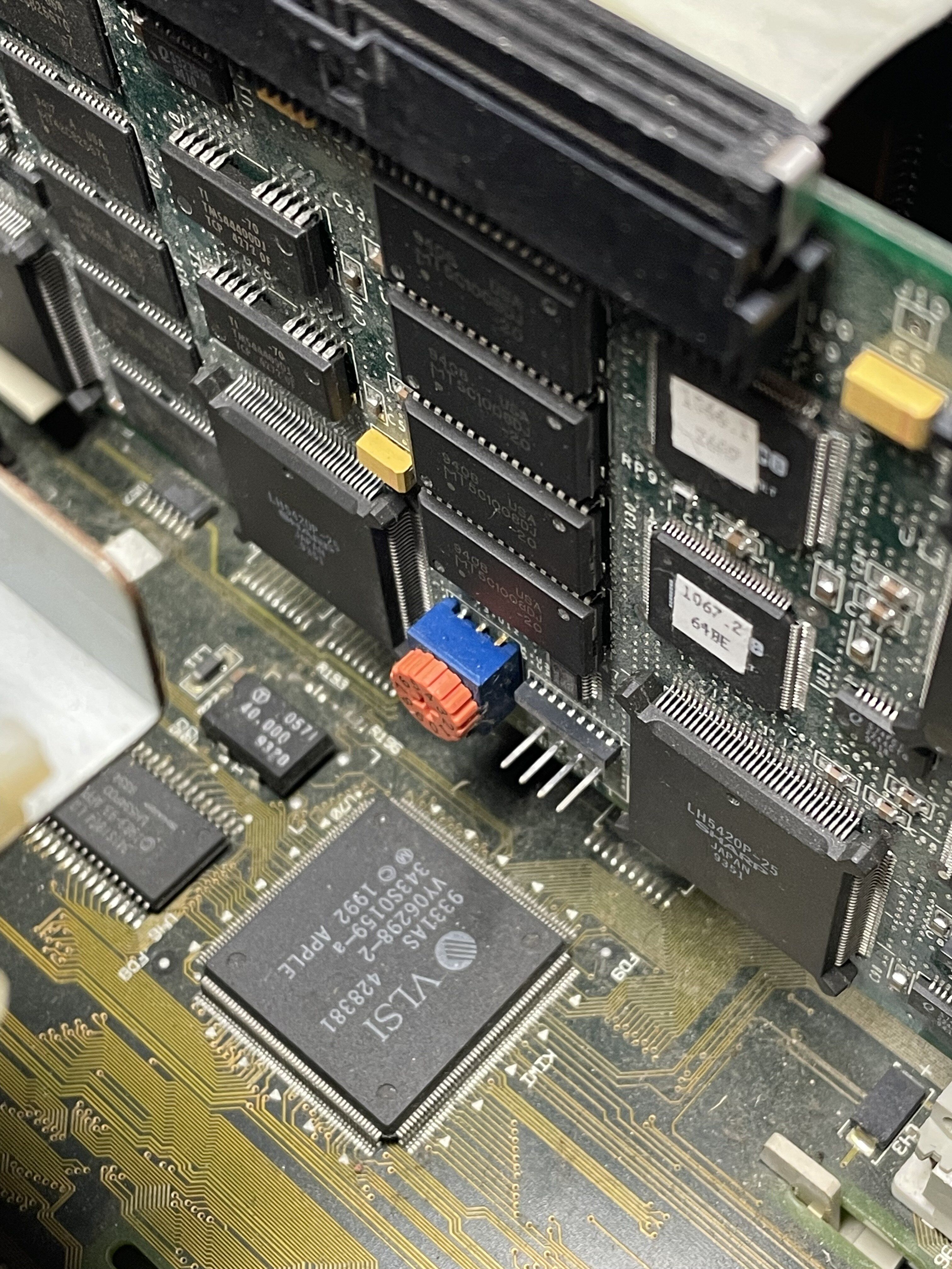

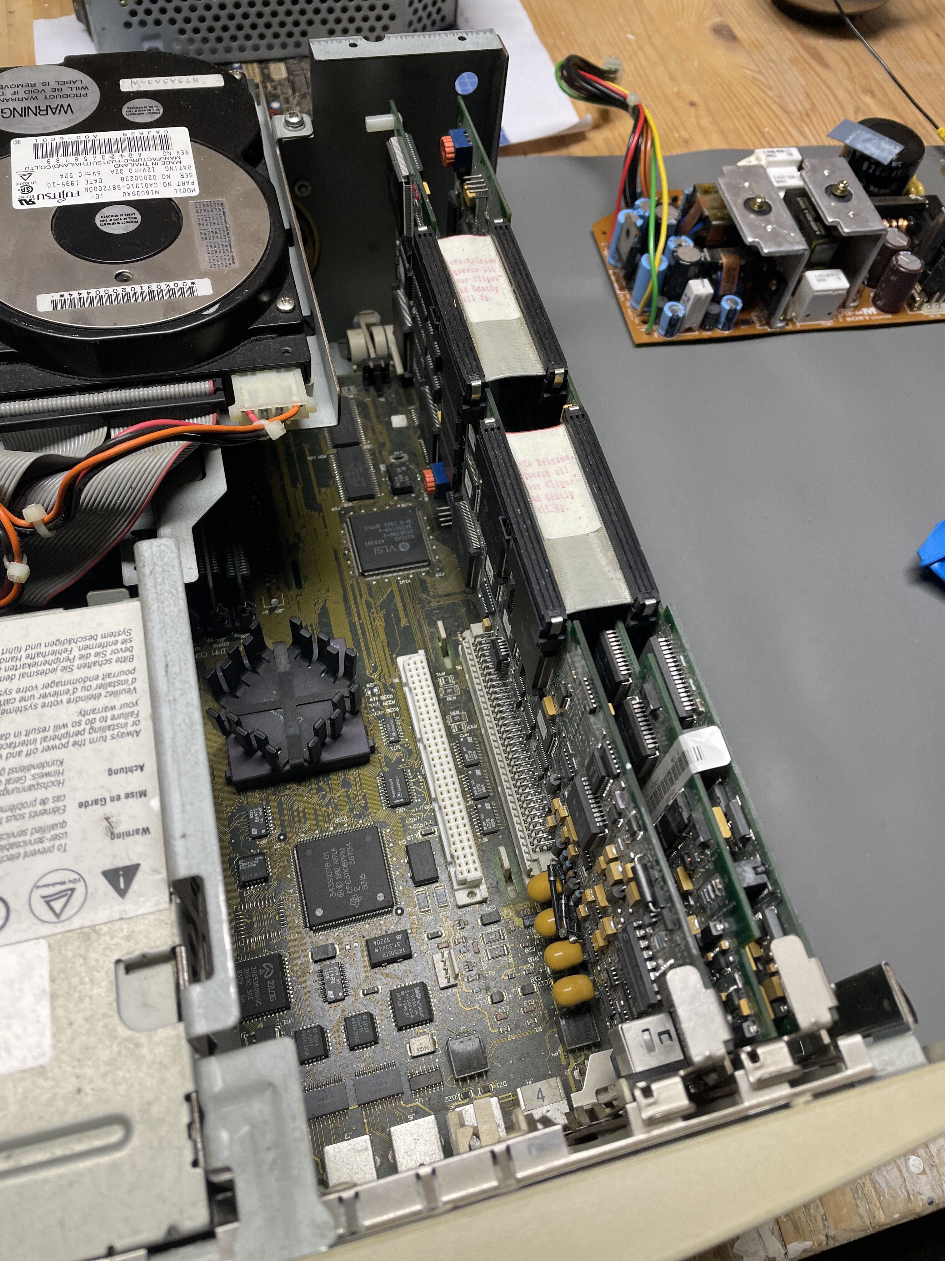

add some pictures from the Quadra 650 (Barn find) (the first thing I did is remove the battery no leakage) I guess a capture card but the chip with Raytheon on it?
I thought that Raytheon was something with Radars (ships)?
Any idea let me know
