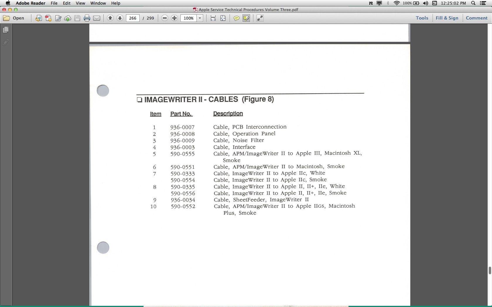

Apple uses only one Mini-8 DIN cable for both printer and modem functions, so no rewiring necessary. As long as you aren't planning to use the setup with a Super Serial card, you won't need anything but the Belkin cable and one of the extension cables from the other auction.
Thank you, @Volvo242GT.
There are two main types of serial cables, a null modem and a straight through. Hence, the concern about the correct pin-outs. IIRC, the IW, IW II, and other Apple printers using serial MD-8 cables need the null modem type to flip the TX and RX pins rather than straight through to support the required handshaking. That is why I was concerned and wanted to be technically specific.
Now I understand why I was confused.
I got an MD-8 serial A/B switch box months ago, so two Apple computers could share the IW II. I had to get a straight-through cable from the box to the IW II printer and connect the regular null modem cables from the computers to the box.
I still have not set up the box because now I have the Mac SE, SE/30, IIci, and Apple IIGS. So, I changed my plans. I had to place the printer in another area and needed a longer cable. I plan to hook up my SE/30 to the printer, and the SE/30 will become the print server on the LAN.
The null modem MD-8 serial cable is the "regular" MD-8 serial cable required by Apple for printers, modems, etc., while the straight-through cable is for direct connections like the computer to computer serial connection or between the printer and switch box.
Now, @Volvo242GT, you showed a page that listed different part numbers for the MD-8 serial cable depending on which Apple computer. Is that because the cables are different with the pin-out for the Apple II (using a Super-Serial card), Apple IIc, Apple IIGS, and the Macintosh computers?
With respect to the different cables, the ones used with the Super Serial card are different, since one is meant for the Apple Personal Modem (or for hooking up a non-Apple modem to a Mac or IIgs), and the other is meant for printers, like the IWII and the StyleWriters, etc. The DB9 to MD8 cable is like the regular MD8 to MD8 cable, in that it can be used with either peripheral, or can be used to connect a Mac Plus (or later) or IIgs to a 1st generation IW.
