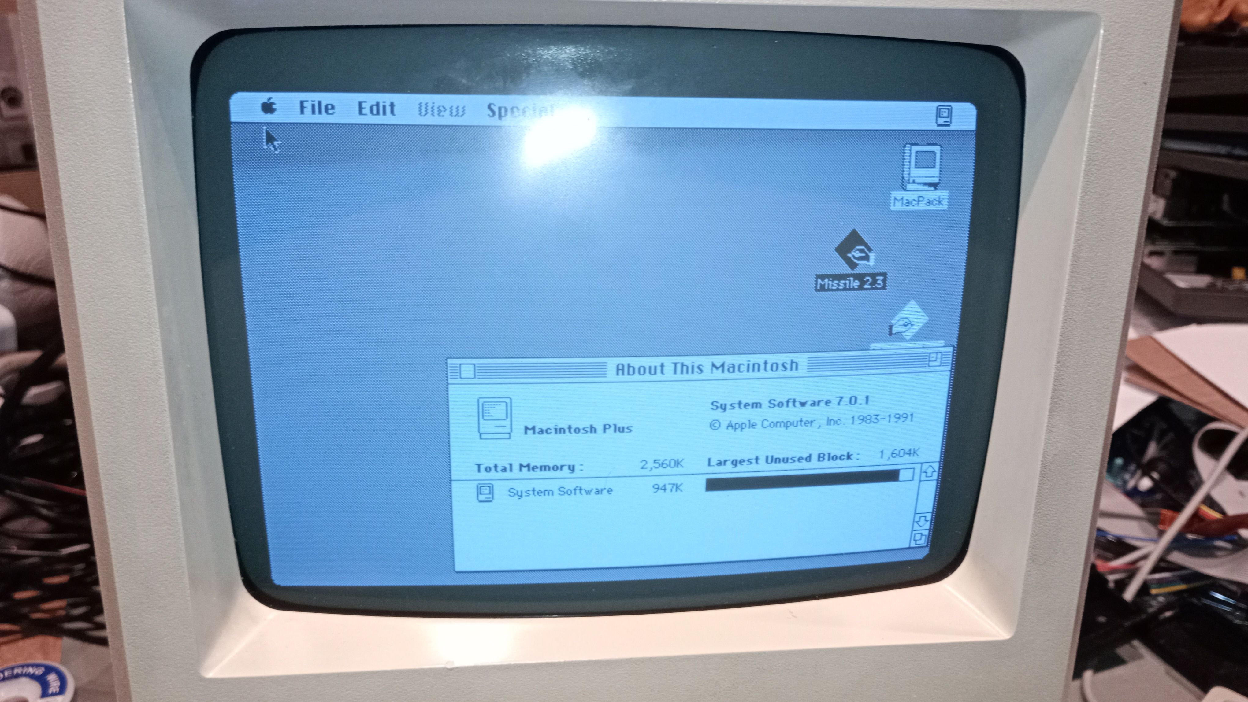

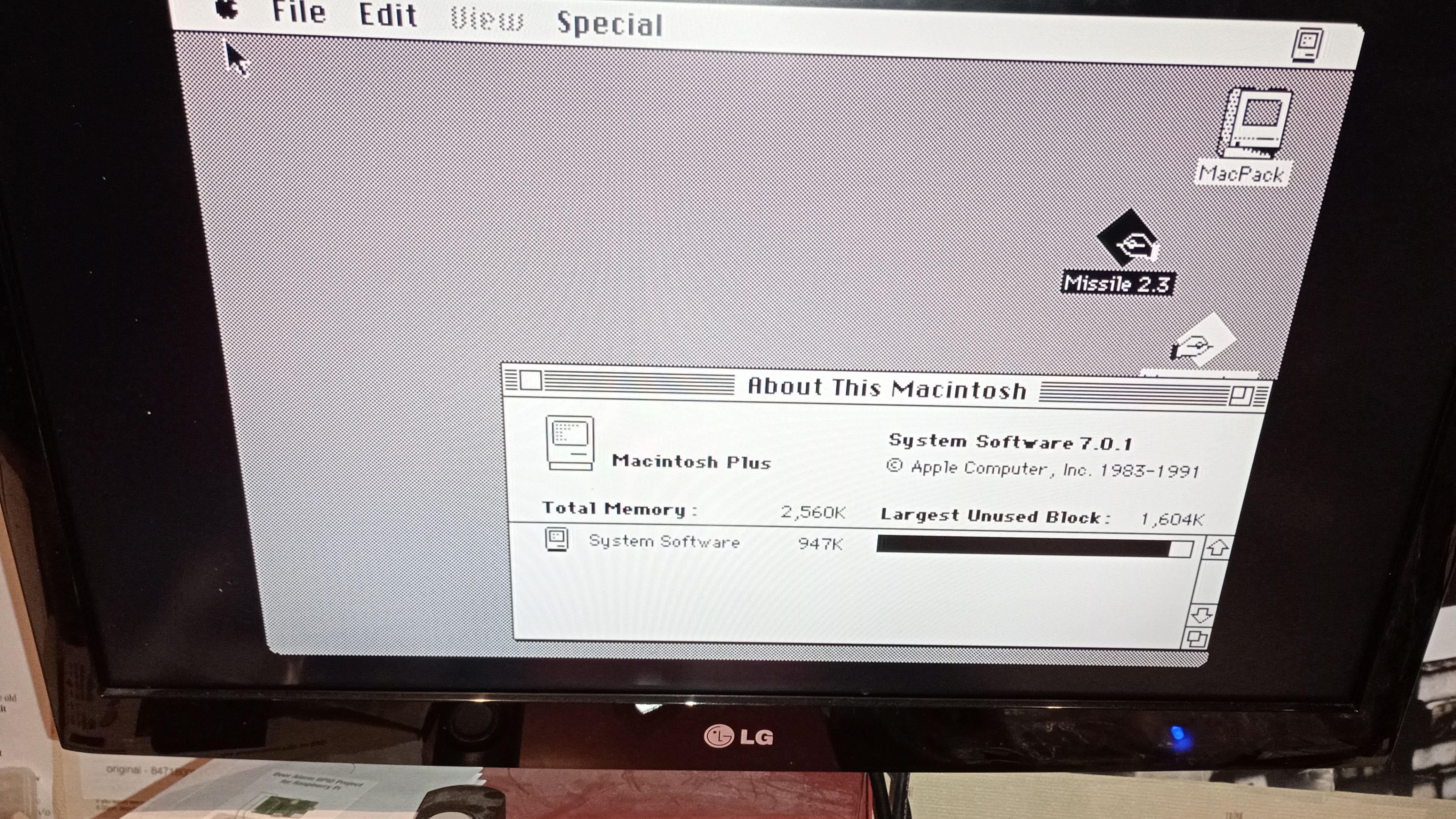

Please ignore. Set the NOP to 22 , works great now.
