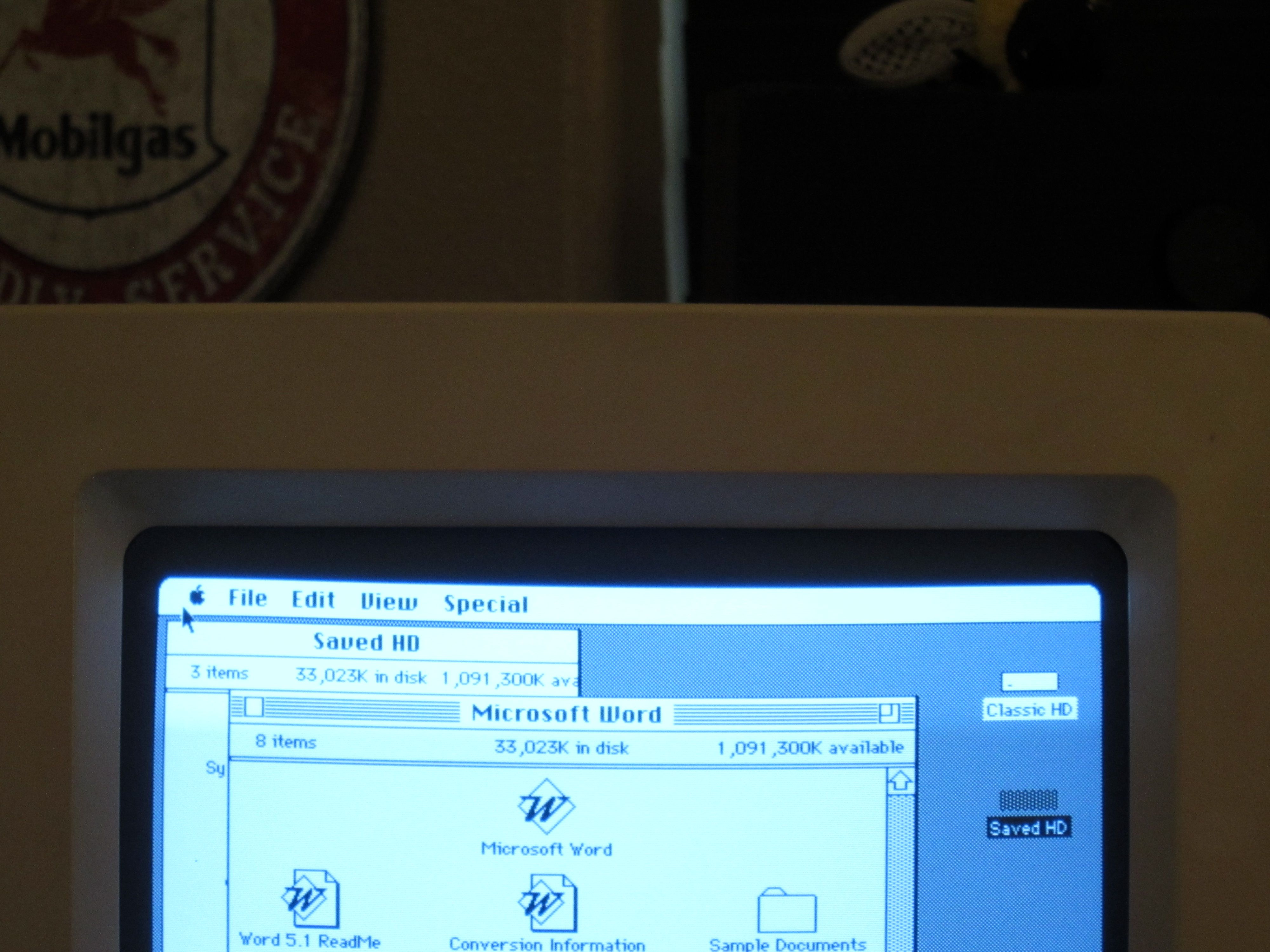

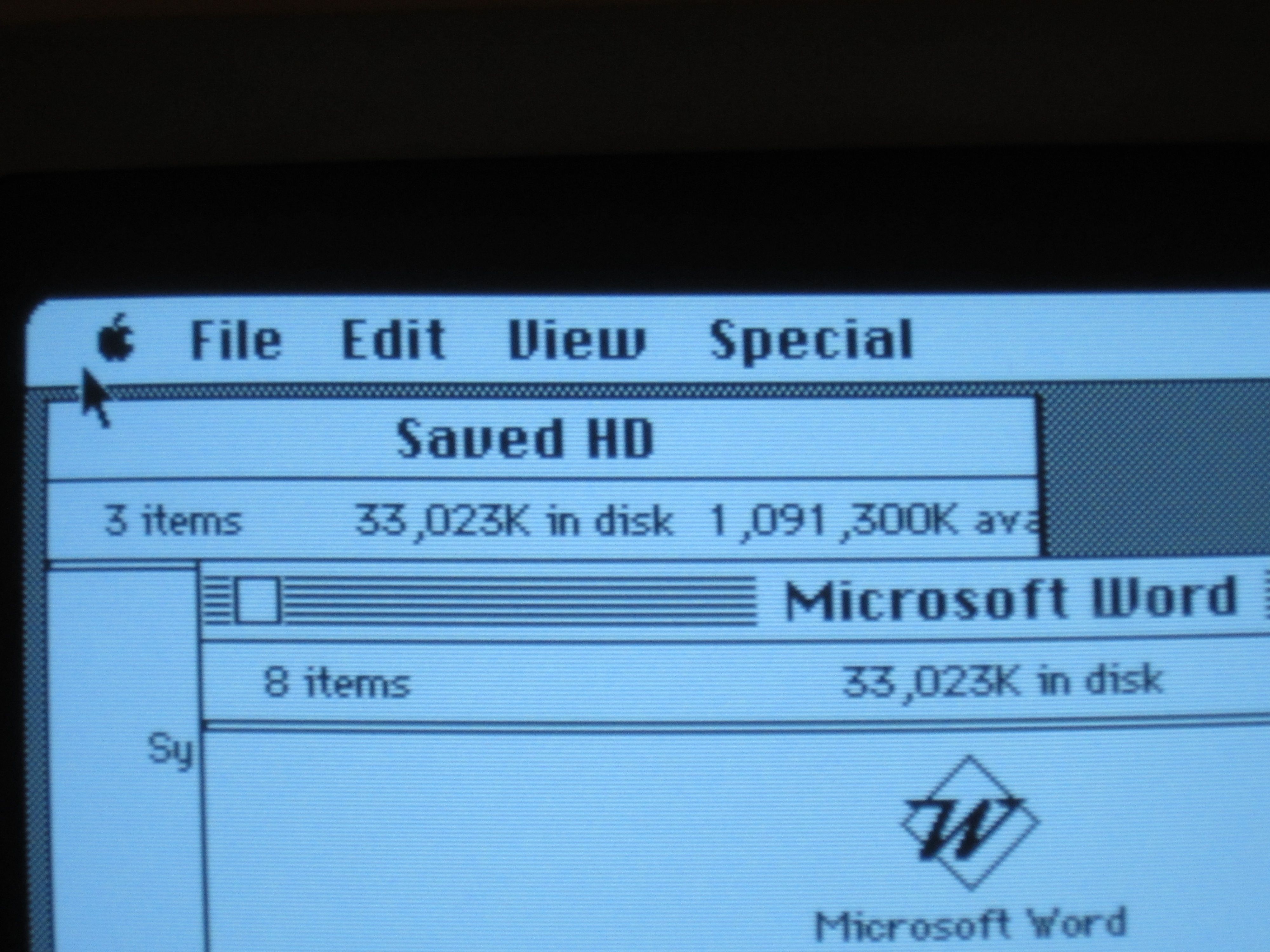

Hello Tinker Different! I finally got my very own compact mac, a dream of mine. It works very well now after a recap, both logic and analog board.
The CRT image has a slight dip at the top and middle, almost like Mr. Macintosh here is scowling at me (this also warps straight lines down towards the center in the image). Another, the left and right top corners appear to flick towards the center (vertically speaking) of the screen. The side and bottom of the edges are both completely sharp and normal.
Any ideas? Could it be an incorrect capacitor or as simple as a tweak to the CRT controls?

As per _nec6678's suggestion, I fiddled with the adjustments on the analog board itself. No changes to image in regards to the dip nor twitching image. I have yet to re-position the yolk assembly itself.
UPDATE 2: All Good.
Based on what I learned here, I managed to successfully adjust the screen geometry. While not perfect, I no longer have a scowly mac, or one with cocked eyebrows. Thank you!

I am currently running it with the back shell on. As far as I am aware, the machine wasn't working originally. The original owner had done some work on it as evidenced by several reworked traces on the logic board as well as most of the recap. I am no longer in contact with him, but he is knowledgable. When I initially powered it on after the trade, it exhibited the same symptoms I am having now. I didn't notice the flickering corners until later.
I forgot to mention that I have a BlueSCSI V1 installed directly below the CRT, not sure if that could be causing issues.

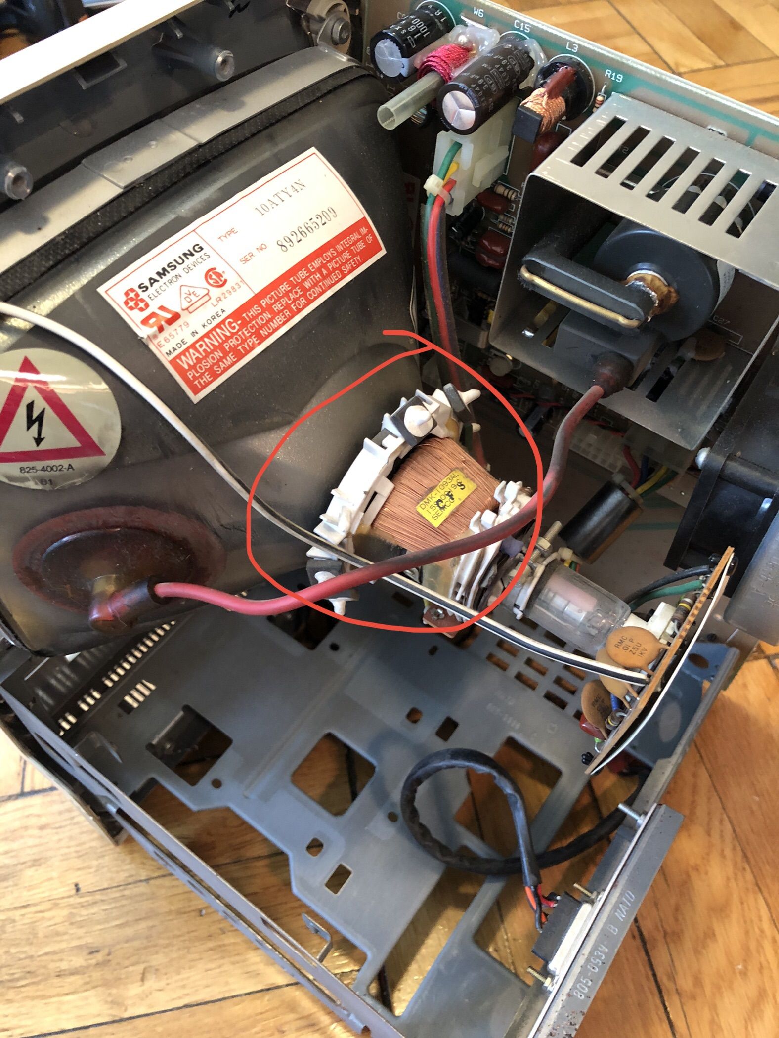

I found these sources for adjusting the yoke:
Below is a picture of my disassembled Macintosh SE FDHD, and I've circled the deflection yoke (the part with the copper coils).
Hope this helps!

This most definitely will! I figured I'd have to mess with the yolk. Thanks so much NEC.

I tried adjusting the analog board controls themselves. No dice. Likely have to attempt reseating the yolk itself next.
You have a screen geometry problem, and need to adjust the small black square magnets around the yoke. It is a pain to do because of the danger of electrocution, and the fact that adjusting one magnet affects the settings of the two magnets adjacent to it.
Try an internet search for “macintosh crt screen geometry magnets,” and consider living with the bad geometry. One wrong move could potentially mean not living at all.
I... uhhhh.... adjusted the screen geometry magents. One hand in my back pocket and a very careful left hand maneuver in avoidance of bare copper. Then some poking with plastic picks for the ones next to the logic board. Its not a perfect job, but now I have a nice rectangle. No scowling mac anymore!
Thanks for your word of caution though.
